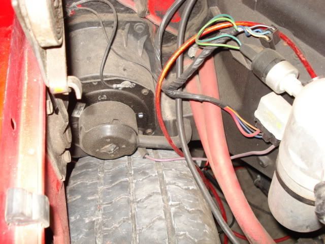

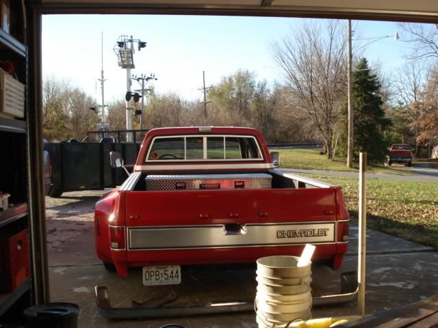

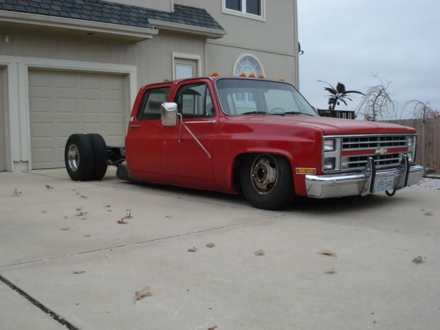

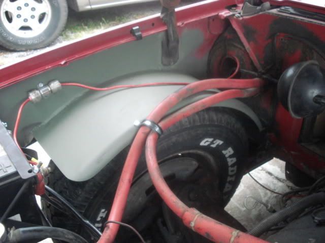

heres where im at. the back is complete and im almost done with the front. What did everyone do about the blower box for the ac. its keeping the passenger front about 3 inches from laying out. the drivers side is all done and lays. any pics of what everyone else has done
low95xlt
some guys shave it and run somthing under the dash
poopskidz
i just pulled it for now so i can get the truck up and running again but i would like to hear more about this under the dash thing your talking about cause i like the looks of it out of my engine compartment

yea gotta lose it. you can get a vintage air setup for it thats what most people do.
str8ugly's avatar
str8ugly
yep vintage air FTW!
d.fens
75174-LCZ 1973-86 Chevy truck Evaporator Kit with factory air - includes all the stuff to move the blower box under the dash.
Did a quick price check, the kit above lists for ~ $600, you might be able to find it for less.
I'm all about this one too, looks like it'll clean up the engine bay and might work better than the OE setup. Win / win situation.

yea works very very well. my boss had it and looked super clean and actually he found it for alittle cheaper than that.

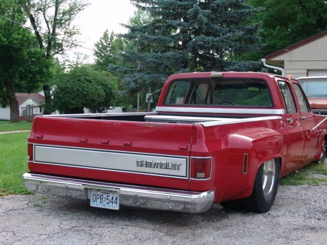

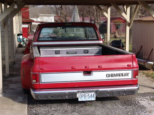

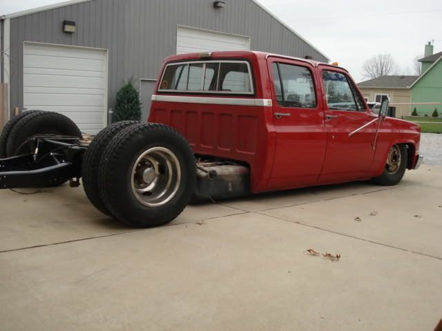

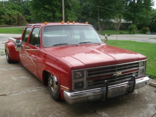

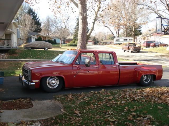

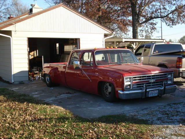

just a little update. these pics were from a few days ago. i now have the bed on and im working on making it fit right.
huskerdually
Not to shabby.
