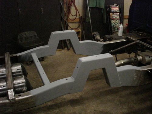

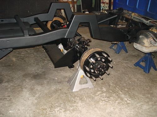

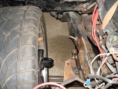

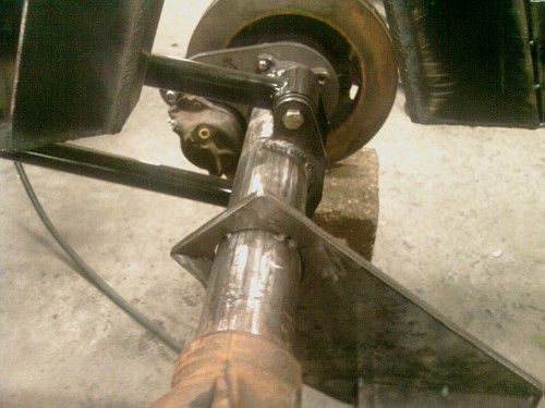

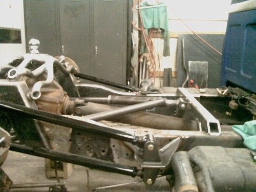

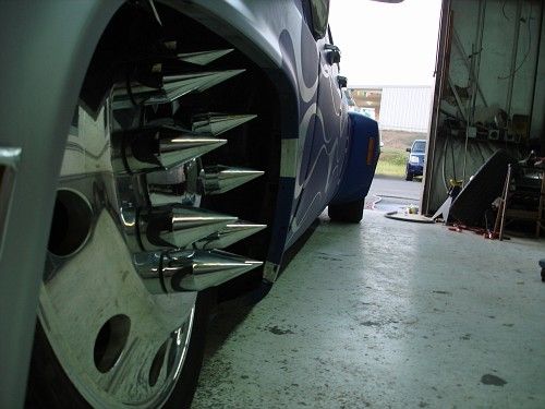

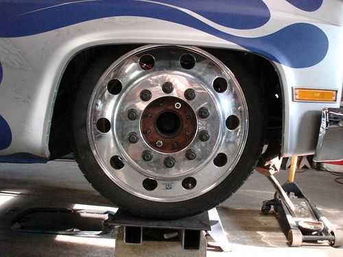

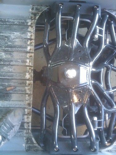

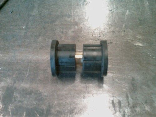

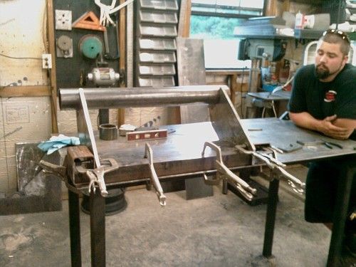

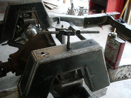

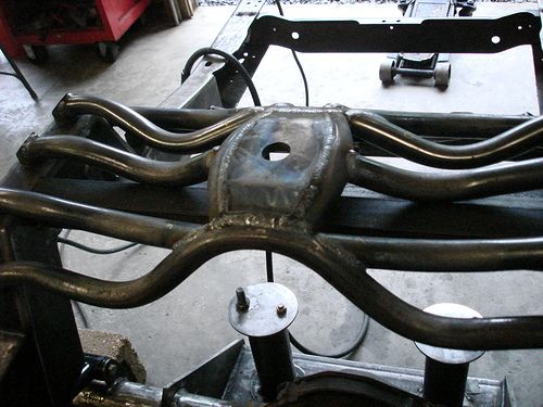

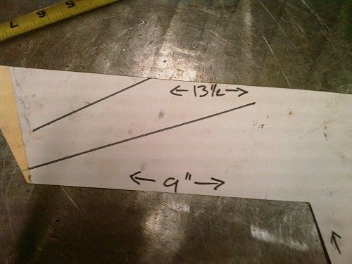

Got the front wheel mocked up for the measurements of the control arms..

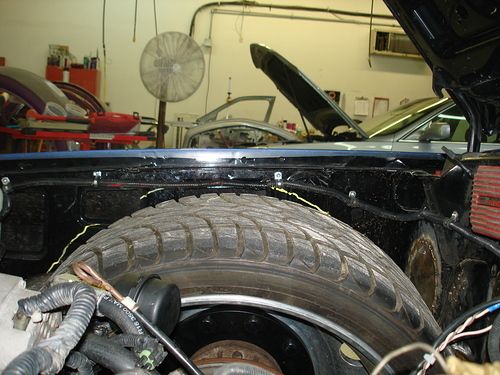

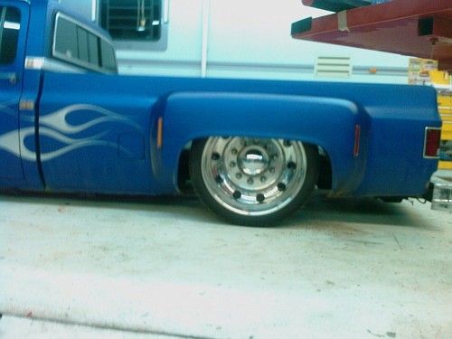

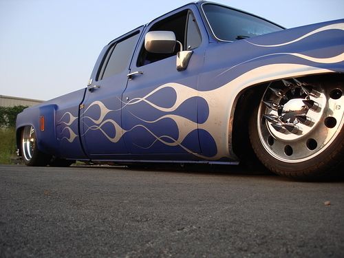

5" Ride height and still tuckin some wheel..

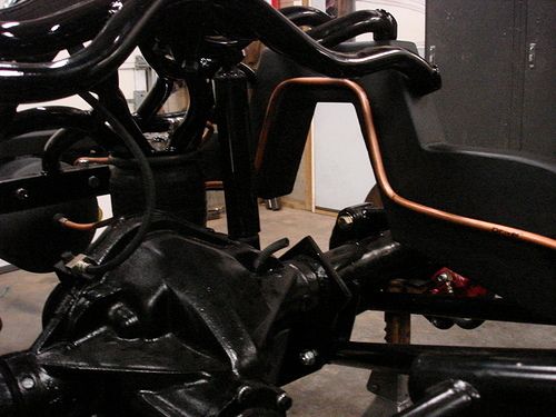

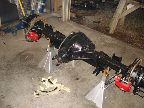

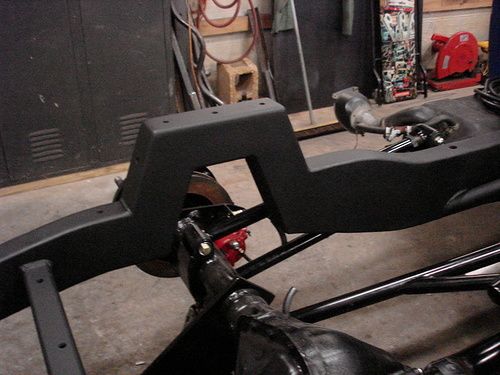

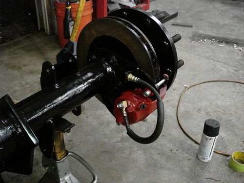

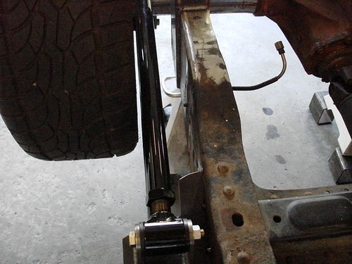

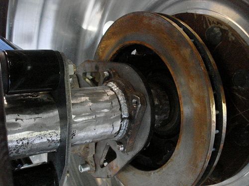

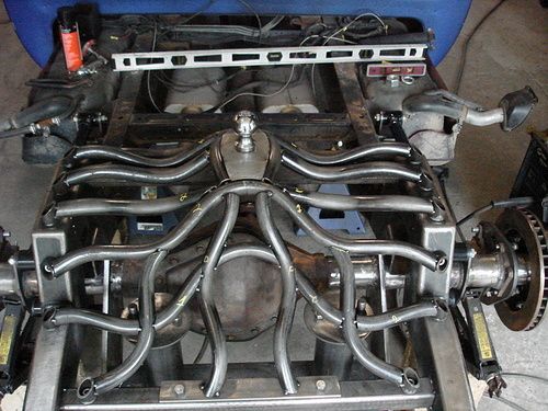

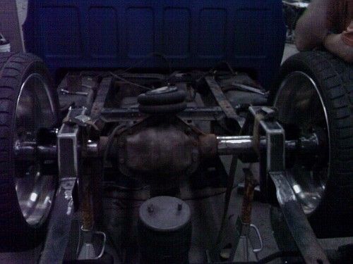

Rear Disc Brake conversion...

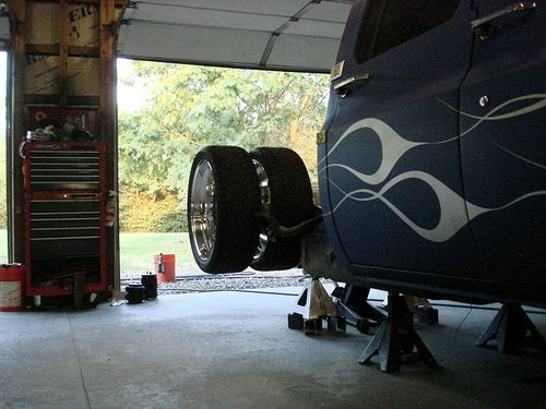

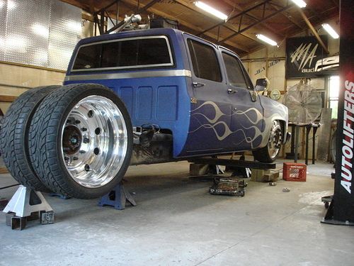

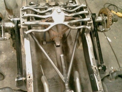

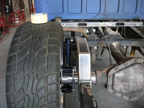

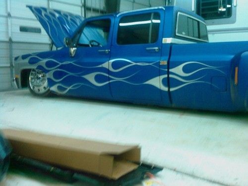

Put the outside wheels on and set it at ride height

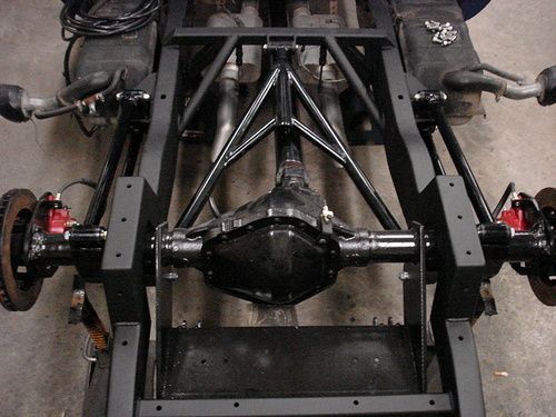

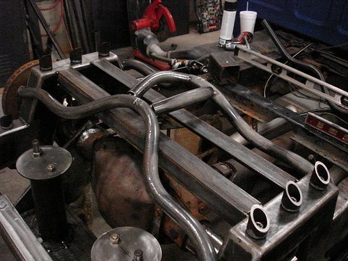

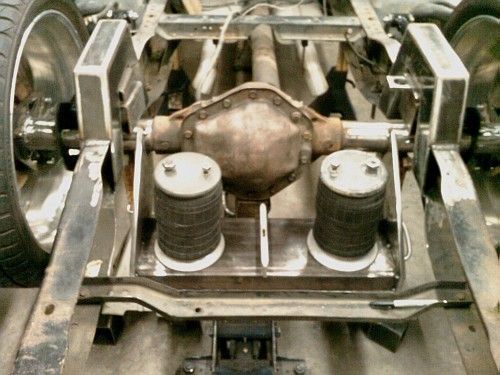

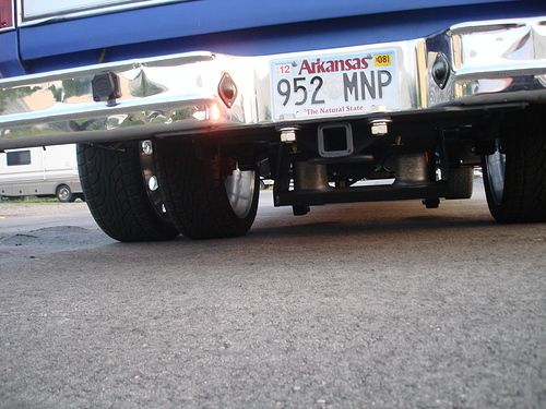

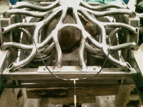

From the rear what it'll look like laid out...
A shot from the rear...

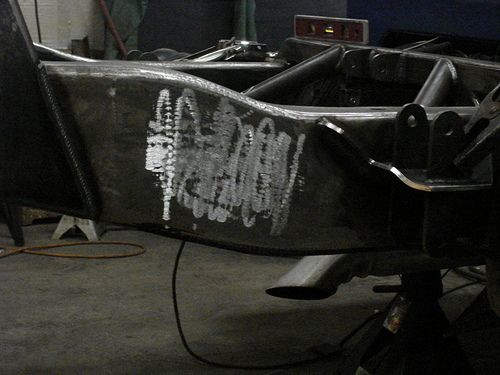

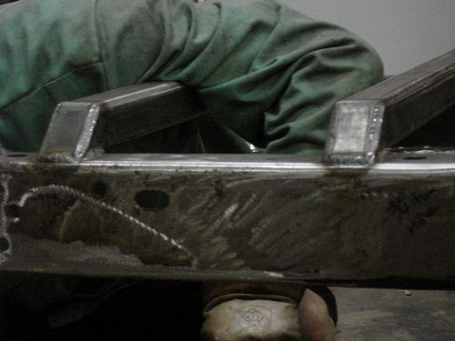

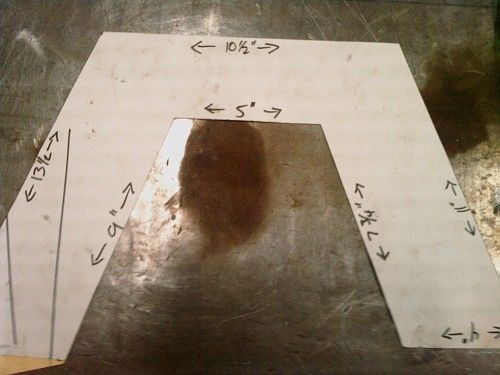

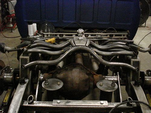

Pic of the notch

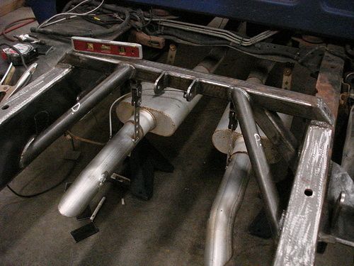

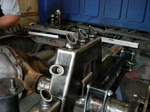

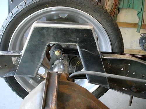

Not much room back there.. 1/4" between the bars and the tire...

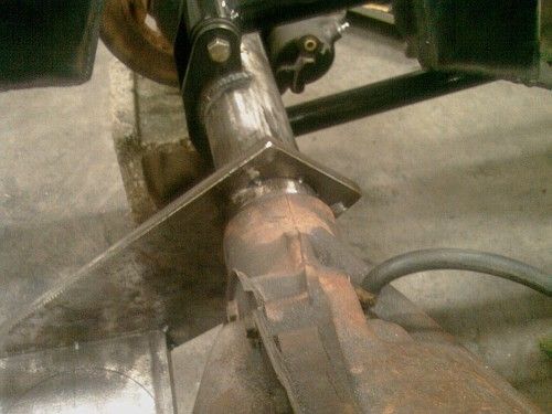

Passenger side

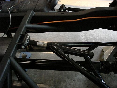

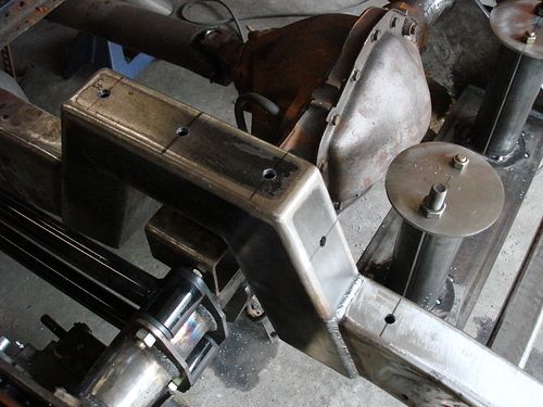

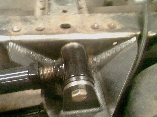

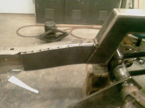

Drivers side... Gotta break the tacks loose on the 4 link and straighten the brackets up. Just pulled on the top when we tacked it.. Forgot to pull the bottom out so it would be straight..

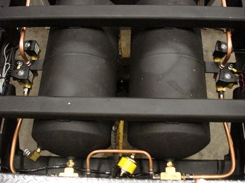

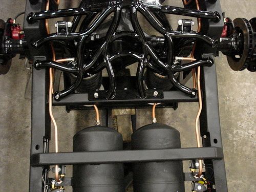

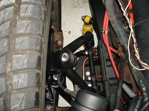

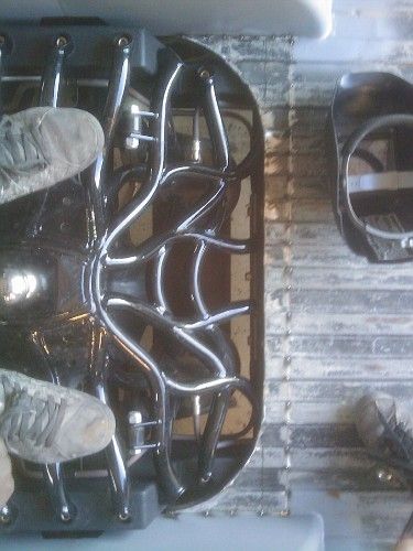

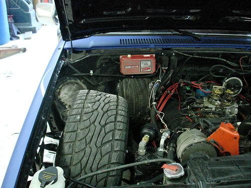

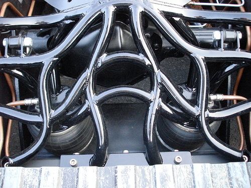

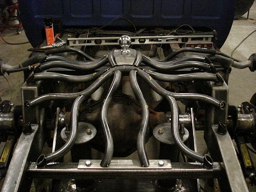

The front

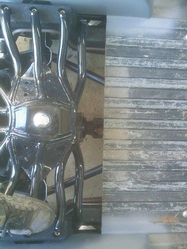

Front from the top..
From the front...
That'll have to do it for now for the picture whores... lol
I'll update more as we keep going.. If all works well it'll be at the ///RA show. Just hope I can get all the parts here by then..

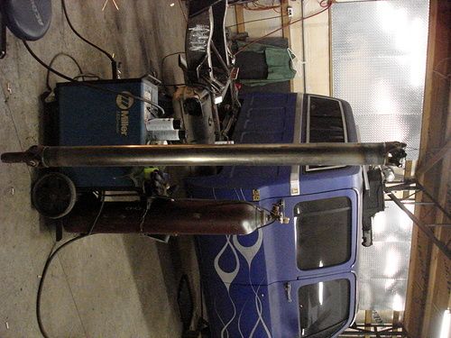

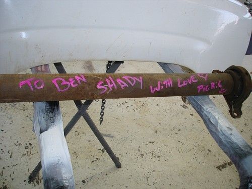

It had a Dana 80 in it and I changed it to a 14 bolt and now I gotta get a new drive shaft because mine is now an 1" too short.. Any ideas on that guys? I know the Dana 80 was 1" longer and that has to be why it's now too short.. But at least a shaft isn't something that's hard to get built.
skidrow
hay nice truck you should be ablet to get that 1 inch out of the slip yoke
mine has like 6 inches of travel had to shorten mine win i lowerd it to lay frame

I wish I could.. I had to take the collar loose off the slip to let it travel back. I've thought about raising the carrier bearing but if I do that it takes away from the room I have for the wishbone.. So I dunno what to do except get a new shaft built.
