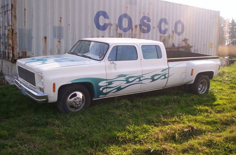

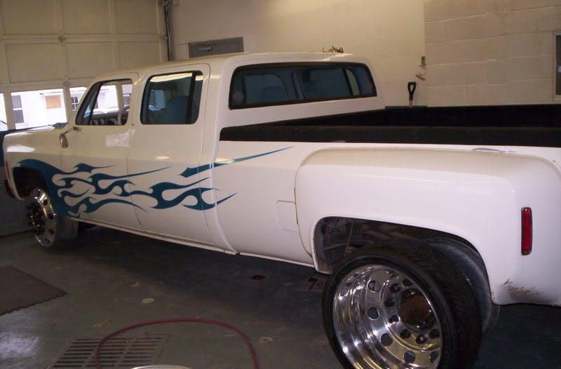

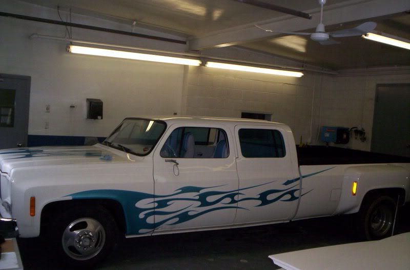

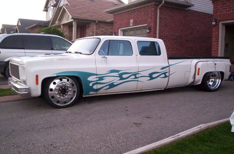

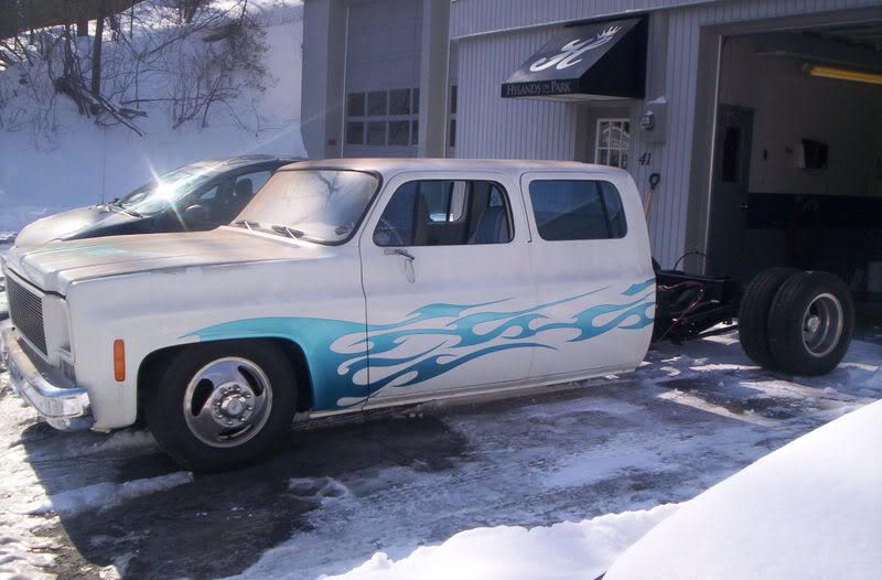

is this that one that you posted a while ago white nexct to a garage
BD
b dime
we are going to need somepics
lophat's avatar
lophat
Yep that's the one, I had problems getting it to the shop. My buddy has a Caddy lowrider in there with a $10,000 paint job on it. I refused to do any grinding and welding with that thing in the shop.
The weather finally cleared up and lots of rain washed all the salt and snow off the road, so he was able to drive it home, and I was able to bring the dually down to the shop.

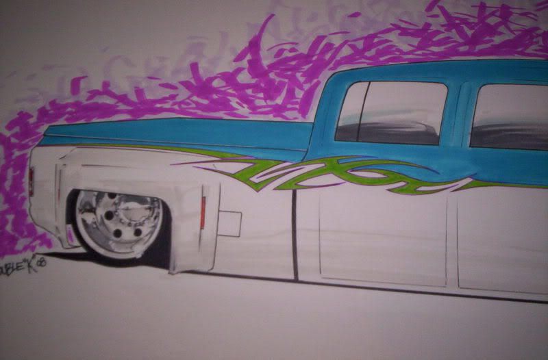

nice time frame any ideas on paint or a rendering?
ybnrmaldually's avatar
ybnrmaldually
that truck is going to look nice on air
lophat's avatar
lophat
Yes if I can get off my ass and finish it. I keep trying to finish it and something always pops up.

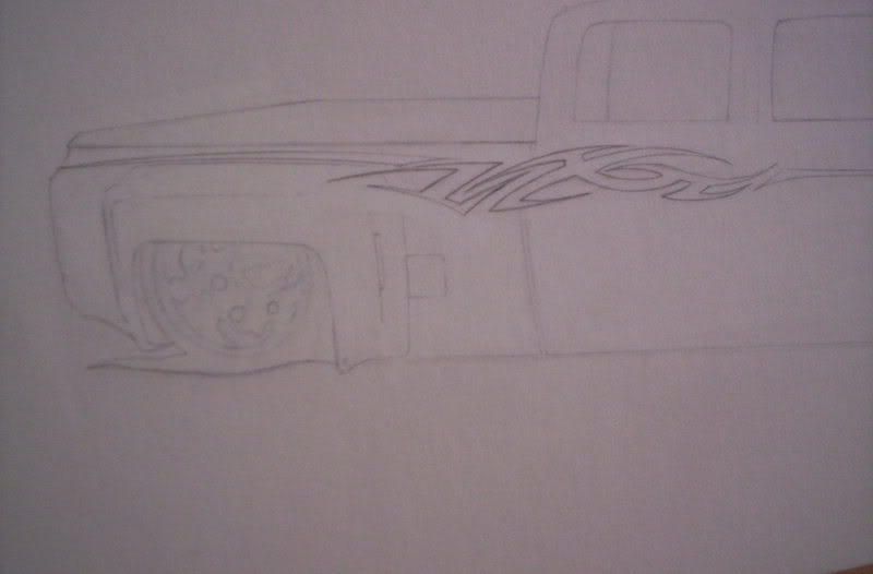

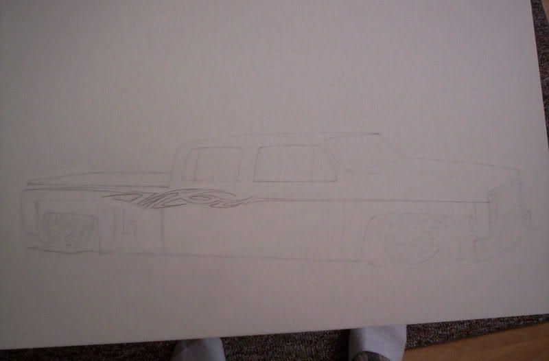

The top is going to be baby blue and along the body line is going to be a thin Kawasaki green graphic, maybe with some kind of dark candy green airbrushing in it. It will start thin up front and kinda turn into a tribal kinda square tribal effect out back around the rear cab doors and bed, and around the rear of the truck. Then shoot the bottom white.
I was pondering going Dark candy blue on top, splitting it with a baby blue graphic at the bodyline. Then shooting the bottom white.
The second was my first choice, but with the interior having the baby blue and white all through it, plus the body isn't (nor will it ever be) "perfect". So if I paint it a dark blue all the waves we don't get to will show up. The truck is pretty straight, but it would take ALOT of time and money to get it perfect, so I think keeping the color pallet light will be the best all round idea.
I don't like to be restrained by color selection, but in this case I have to deal with what i got, and make it work. I still think it will look bad ass, I will get that picture done soon, so I can show you guys what I am talking about.
Then we'll get to the interior. I think it will look crazy when we're done.

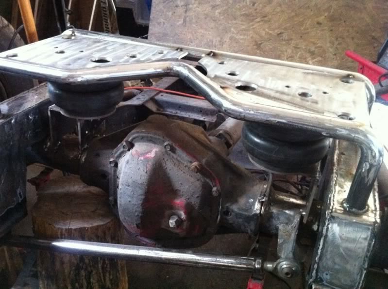

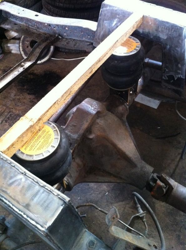

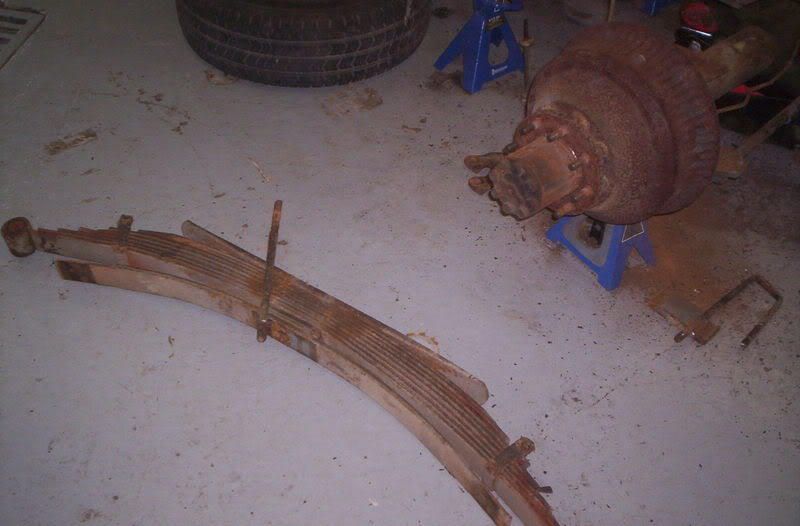

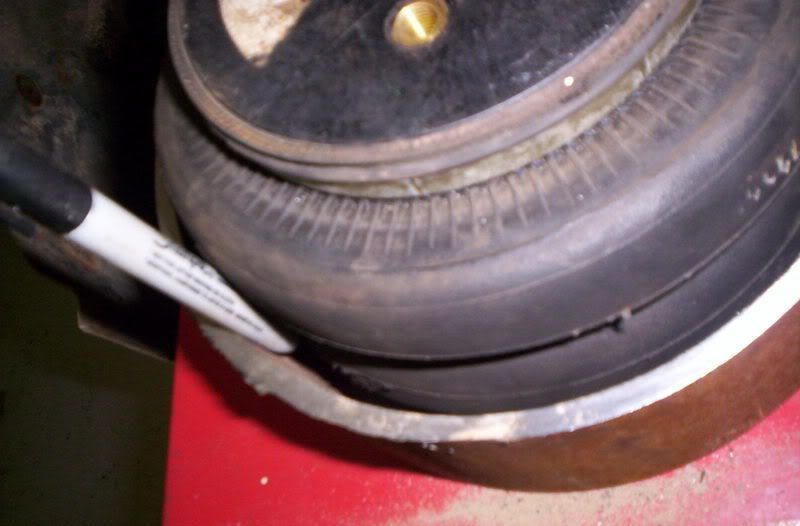

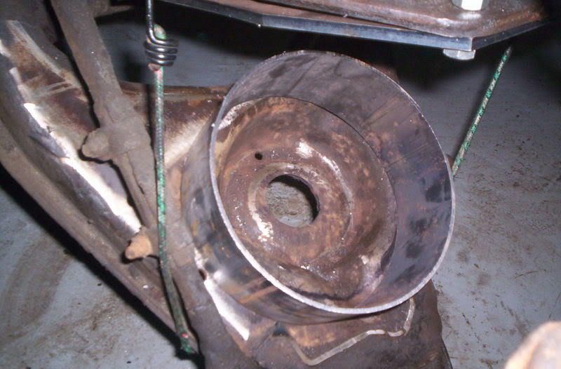

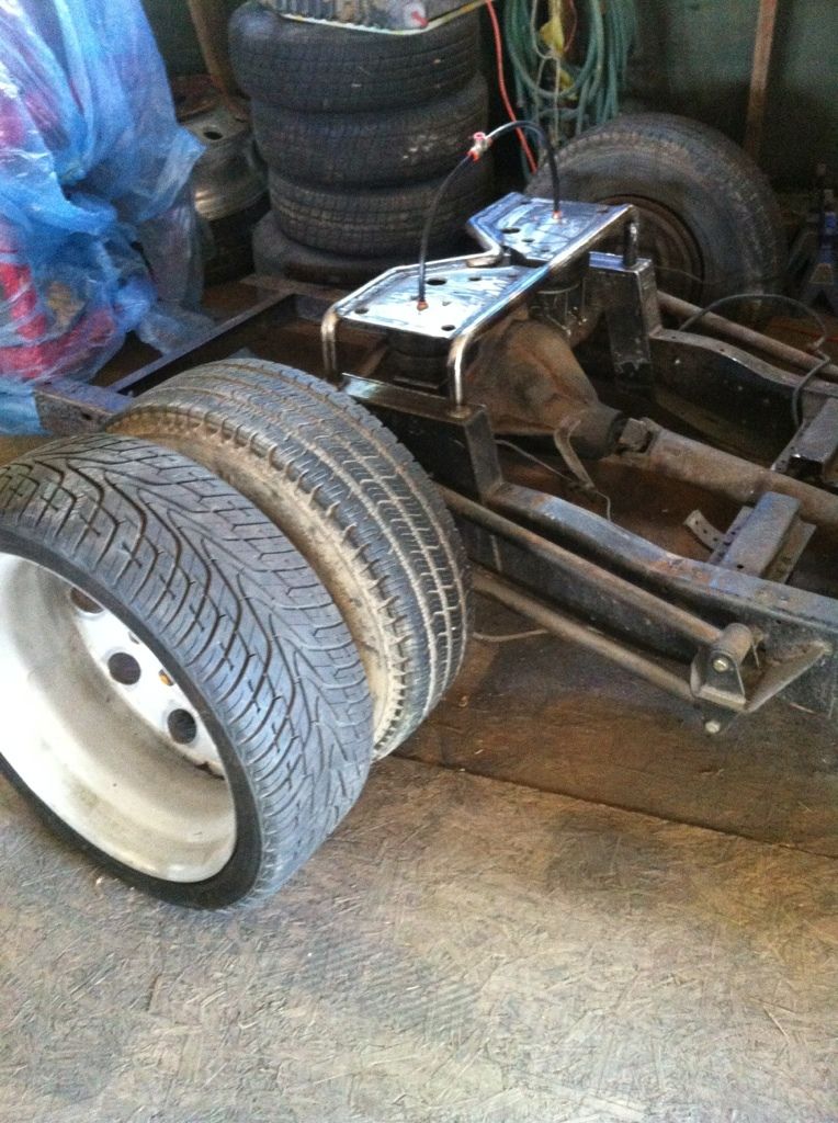

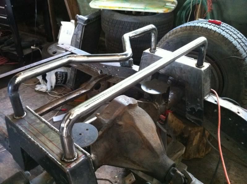

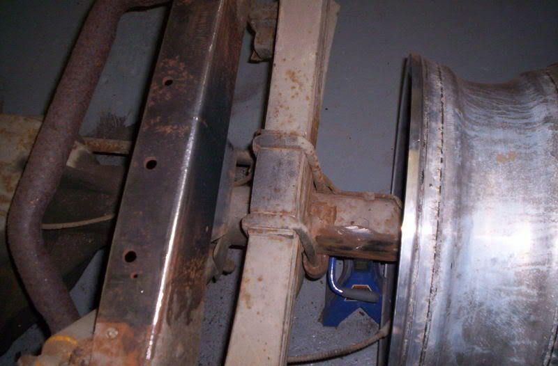

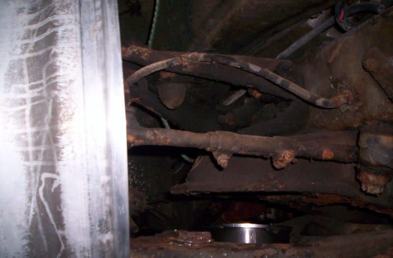

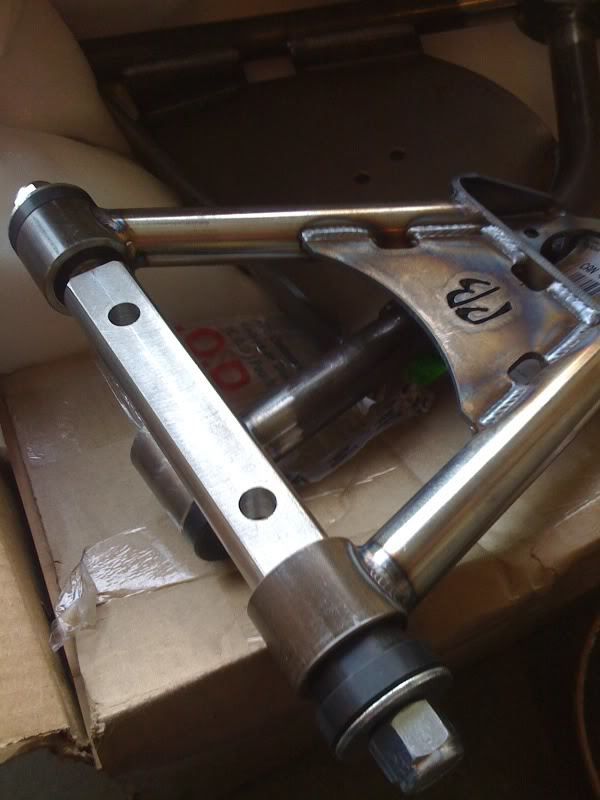

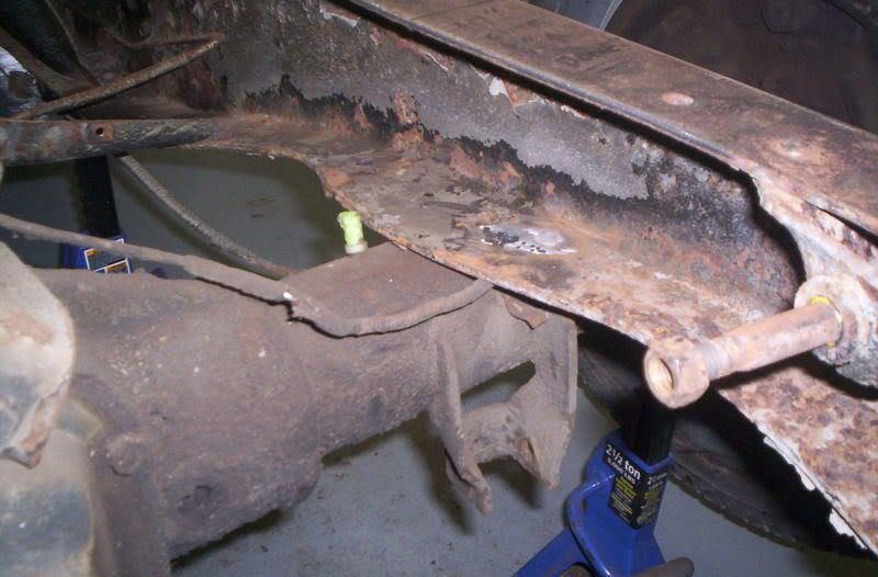

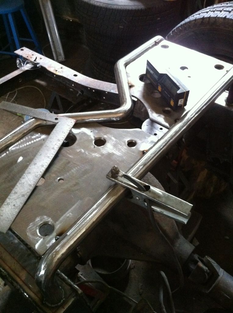

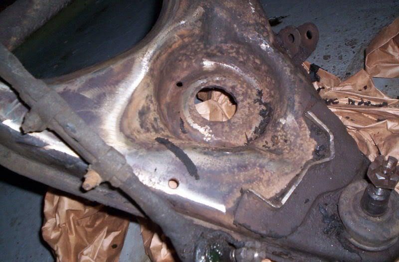

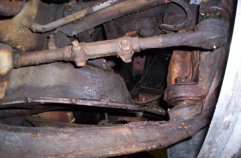

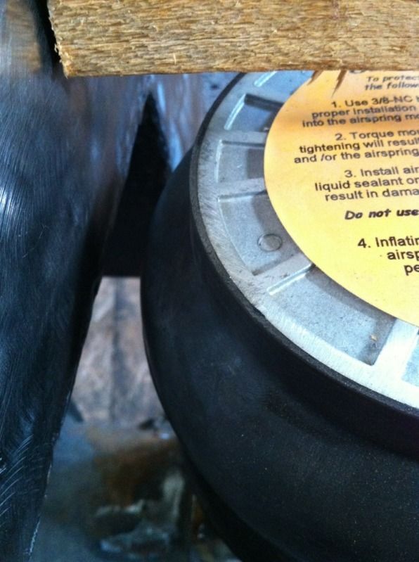

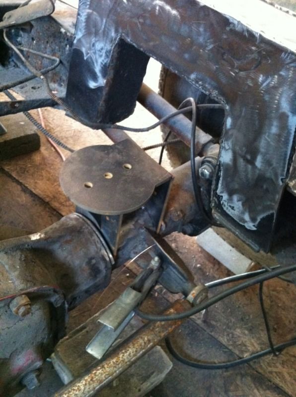

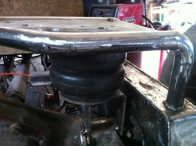

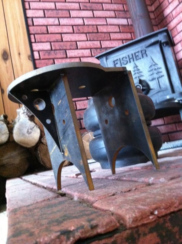

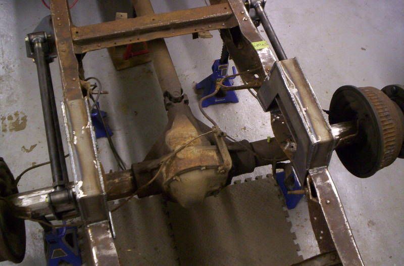

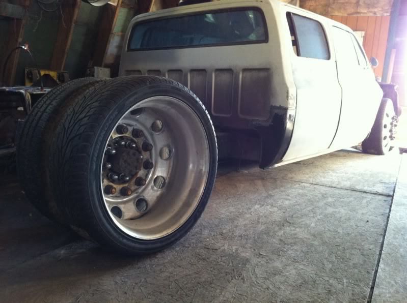

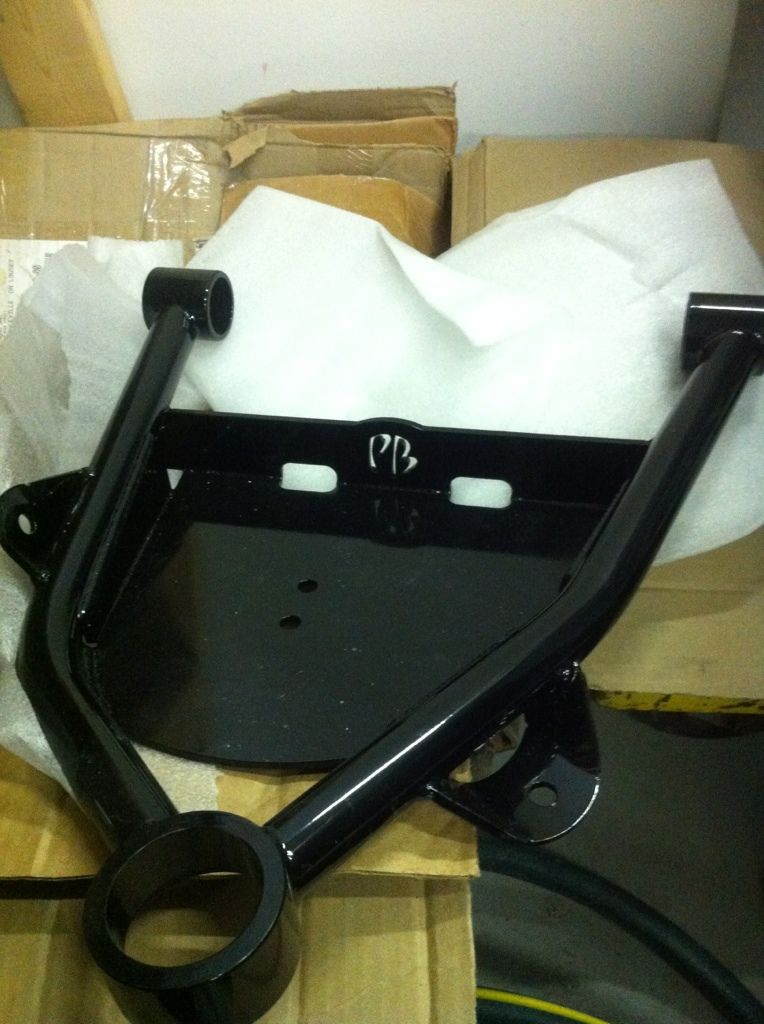

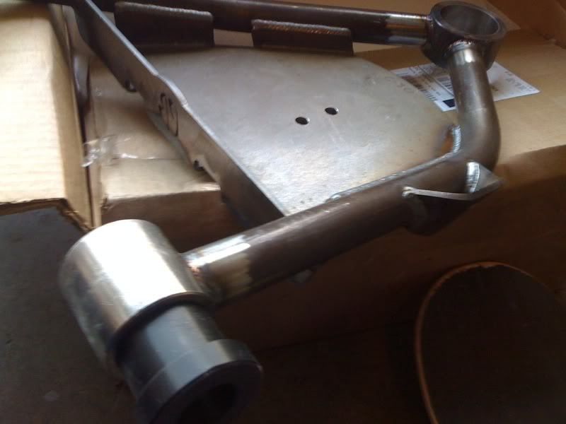

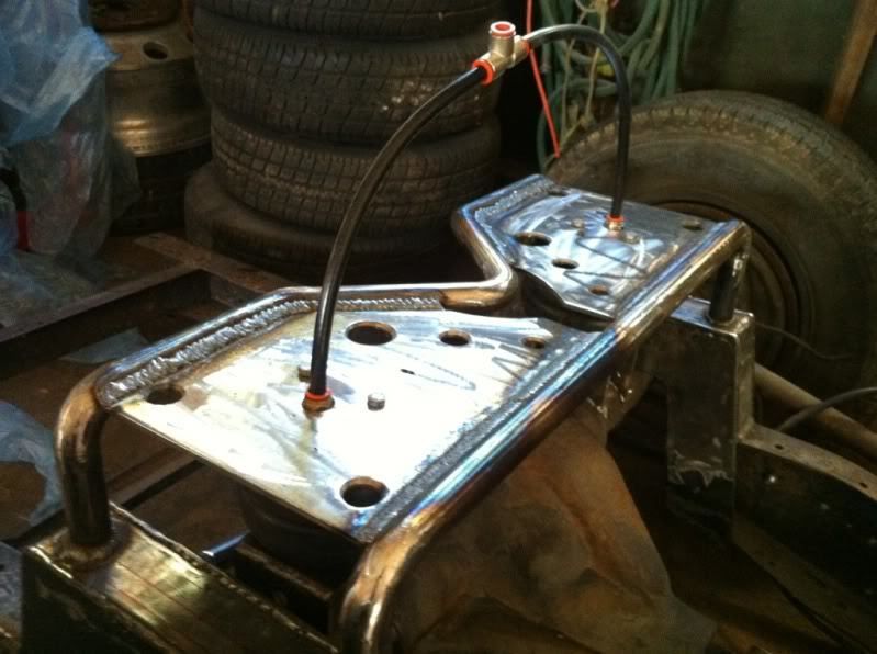

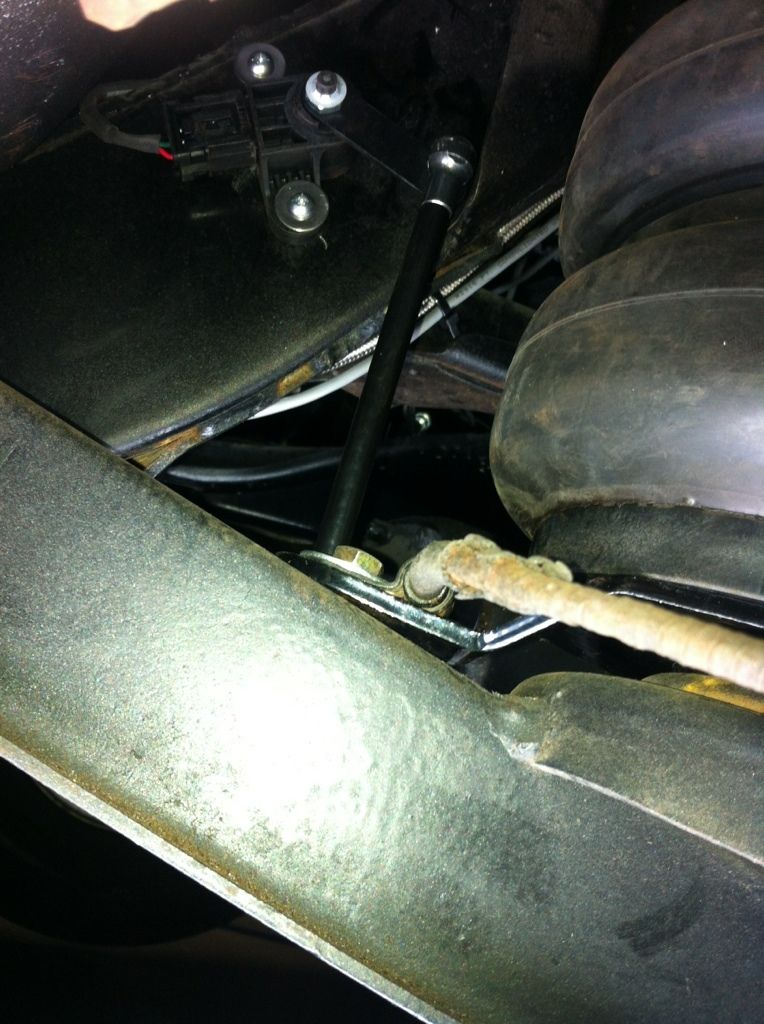

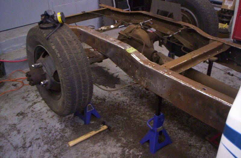

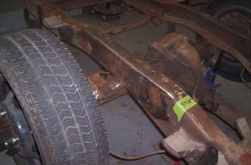

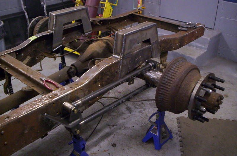

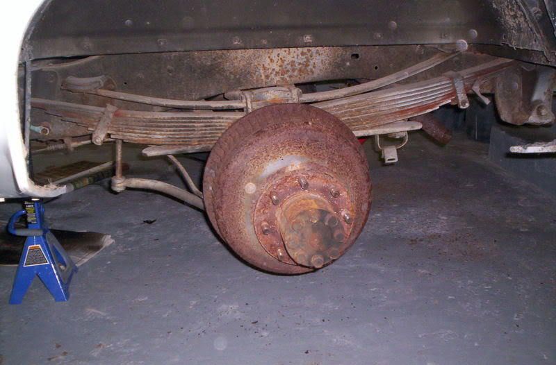

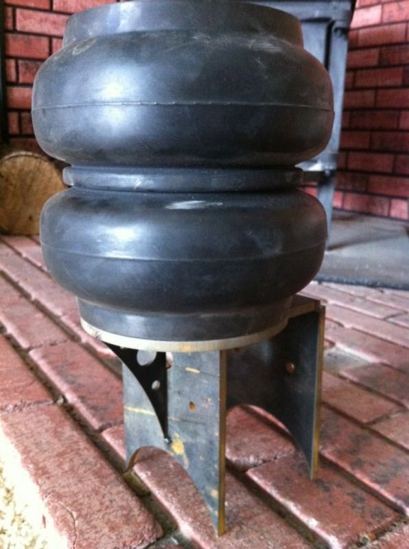

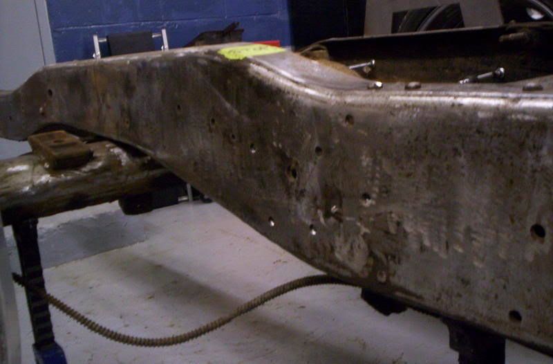

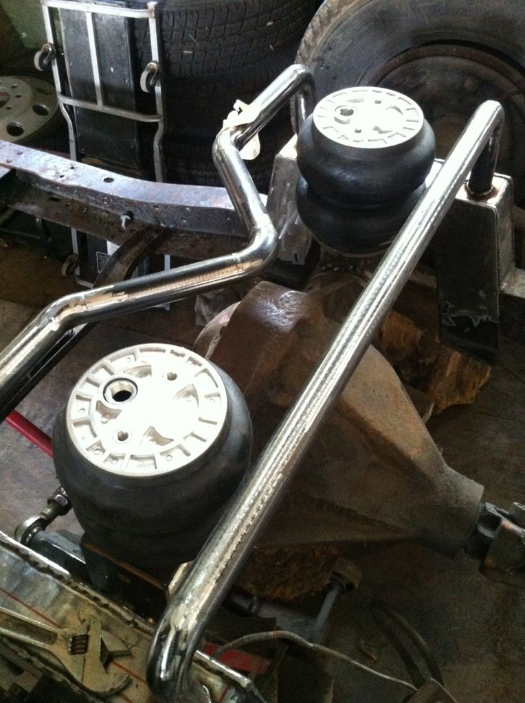

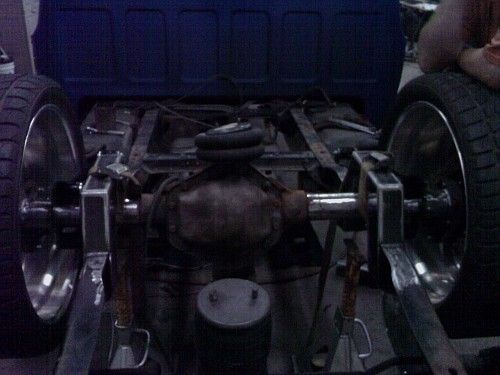

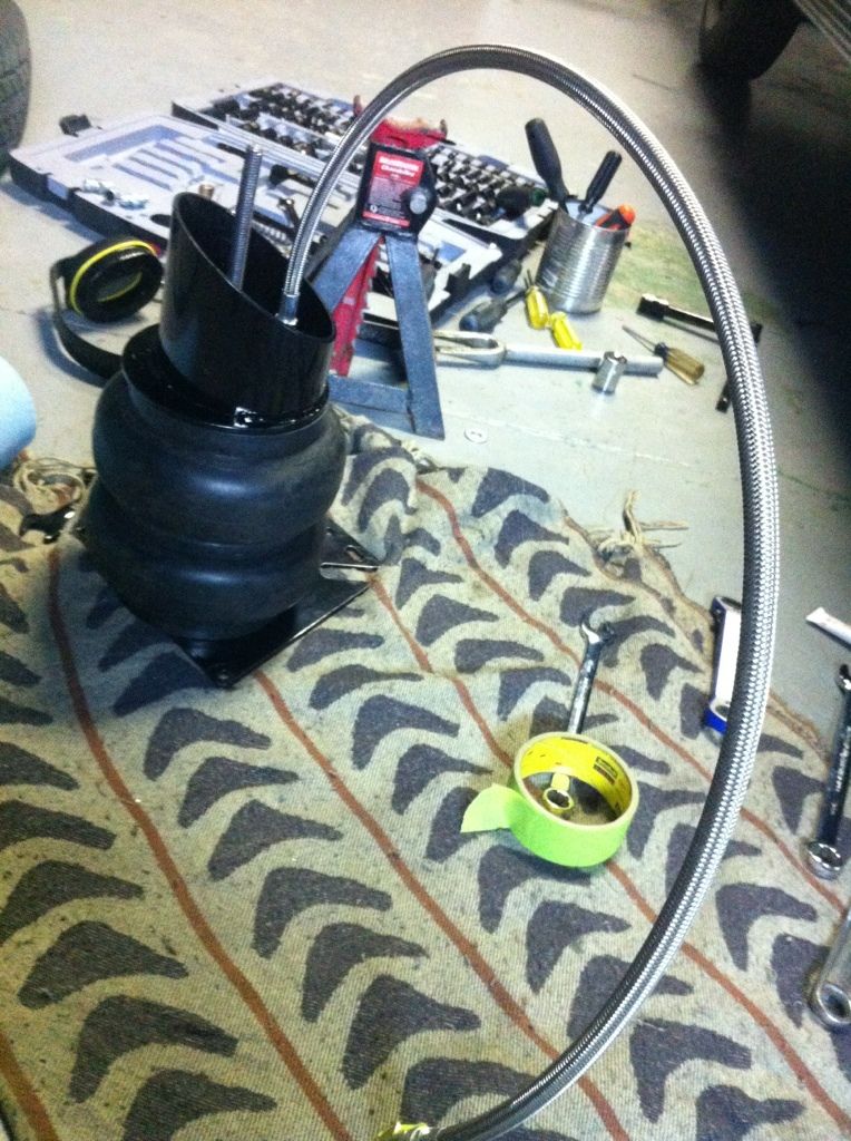

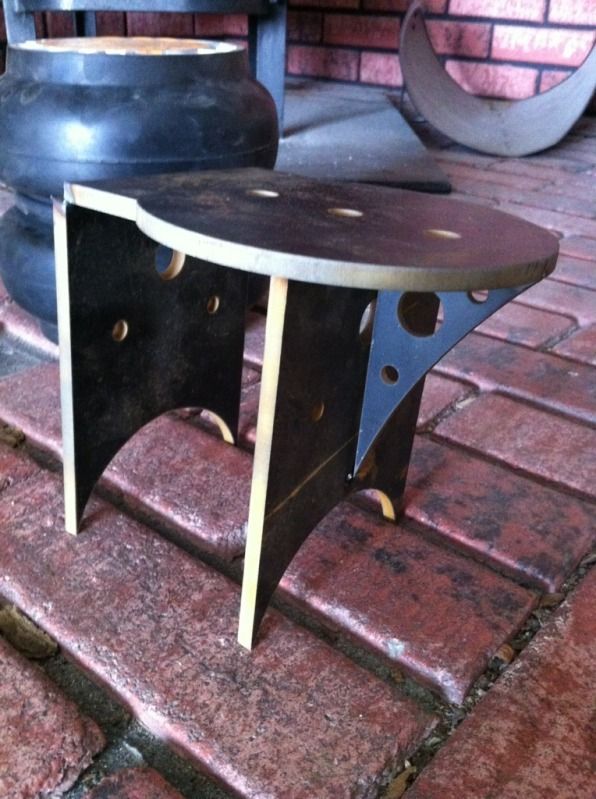

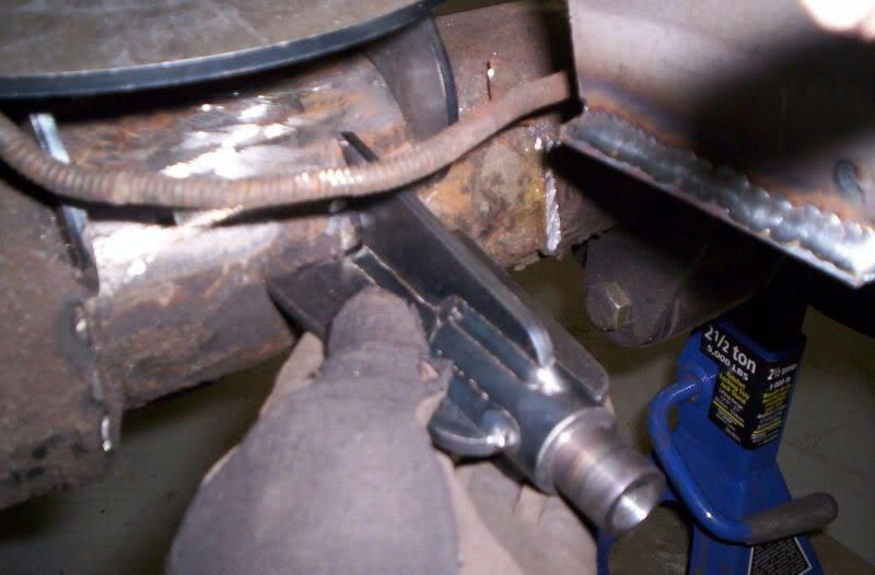

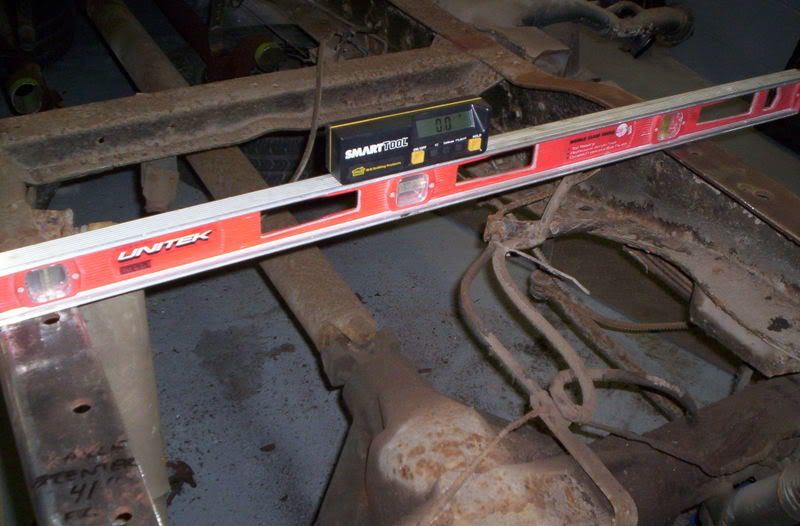

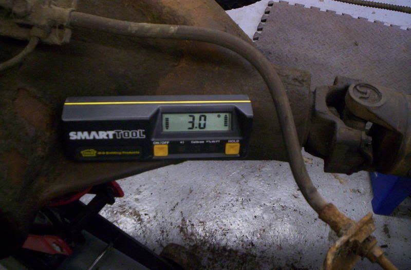

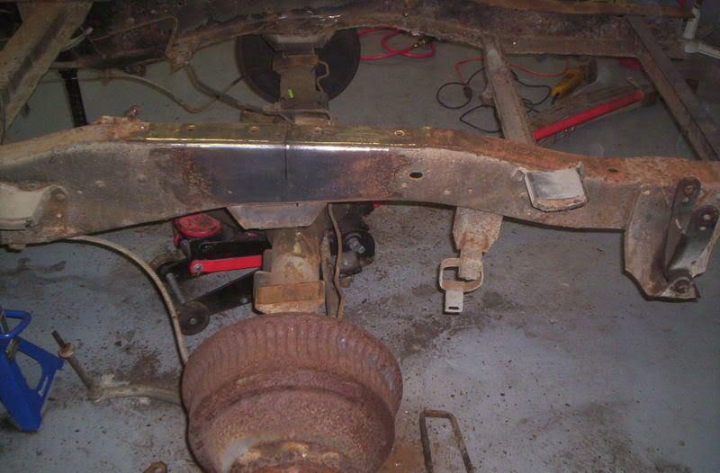

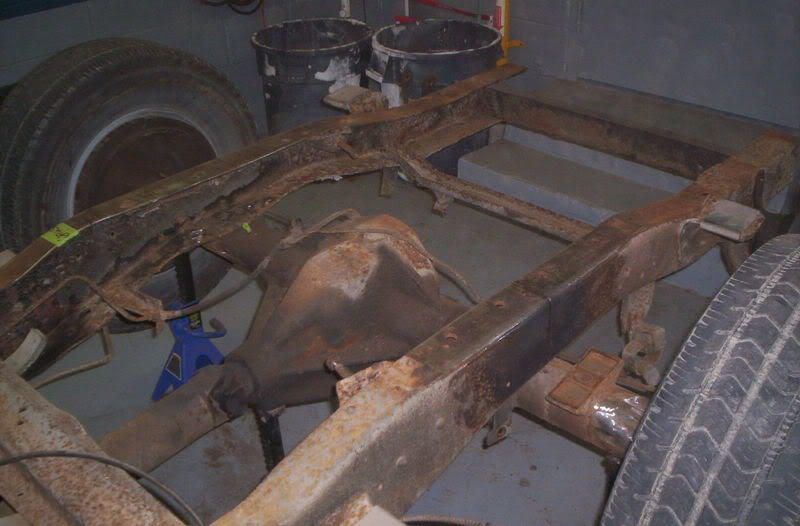

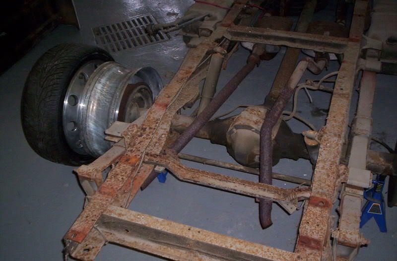

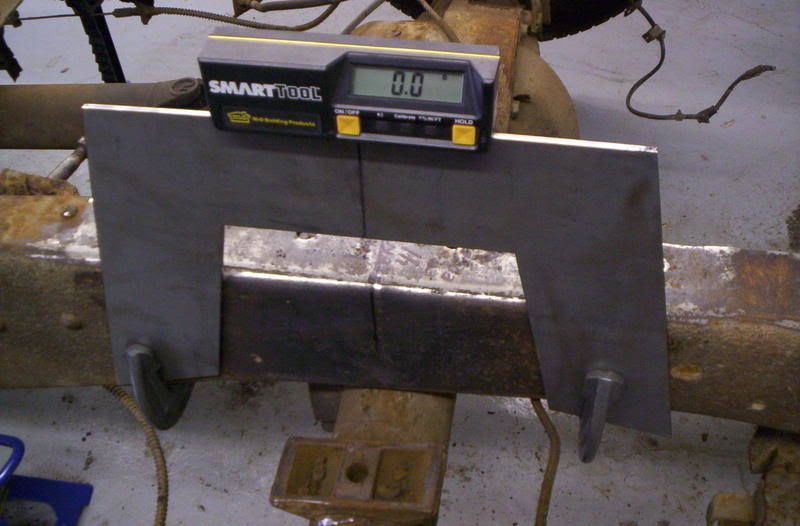

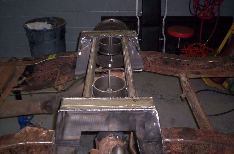

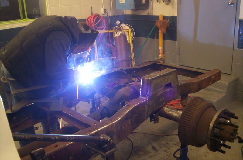

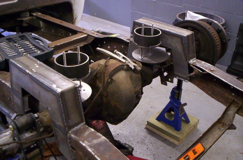

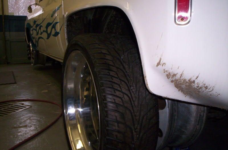

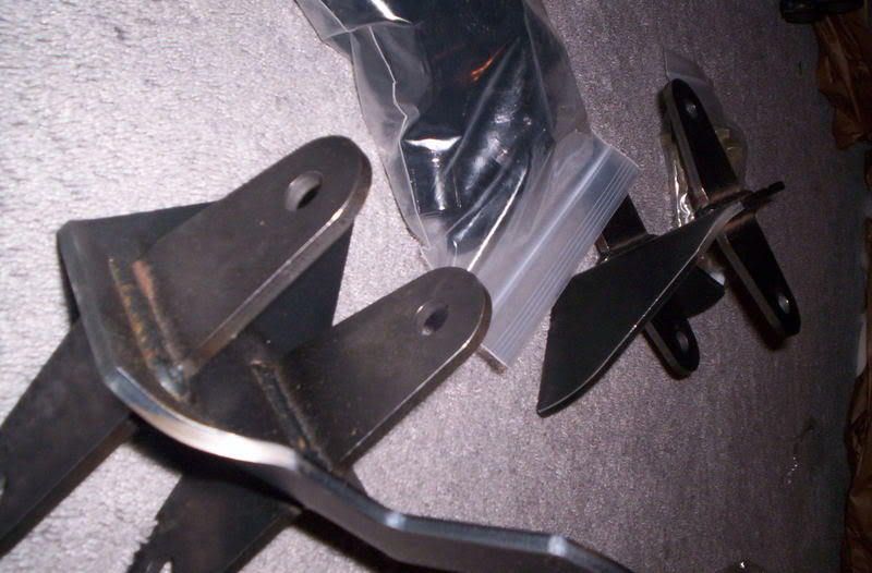

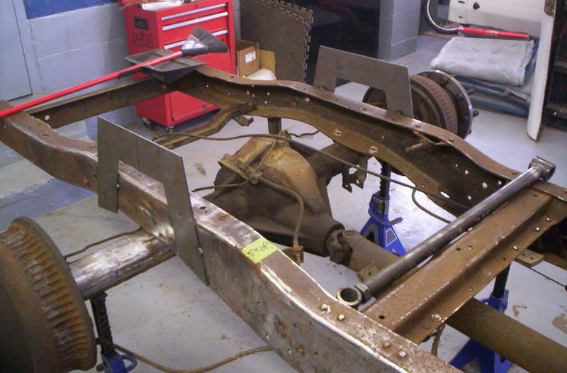

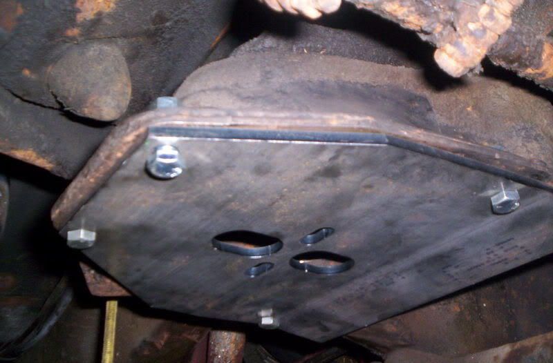

Ok so not much to report. But here are some pics anyway. I did alot of measuring Monday, and some buying of odds and ends.
Hit everything that wouldn't budge today with a shot of liquid wrench and i'll be back at it tomorrow.
I'm a little further along than the pics show, but I forgot the camera at the shop and this is all I had at home in my computer already.
Some SD 4 link shots, and the box is actually off now and i'm scraping away at the frame, not real fun pics. so here's the start of it all.
Got a little bit of widening to do...
More tomorrow...hopefully I don't forget the damn camera again...think i'll write a note to self...
