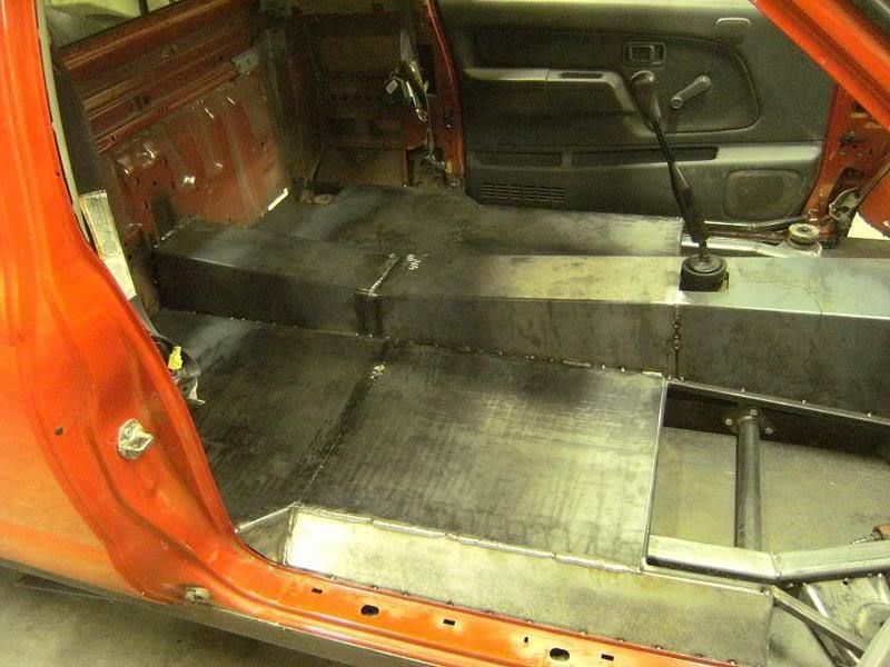

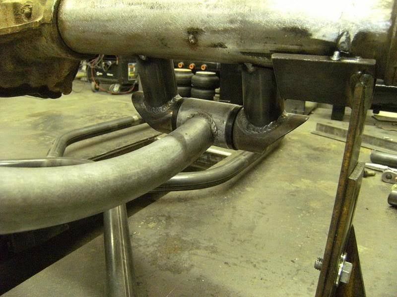

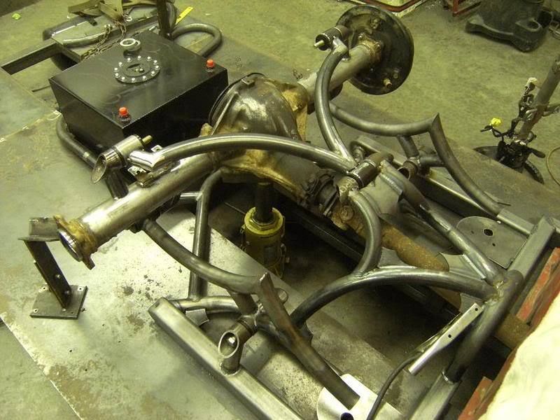

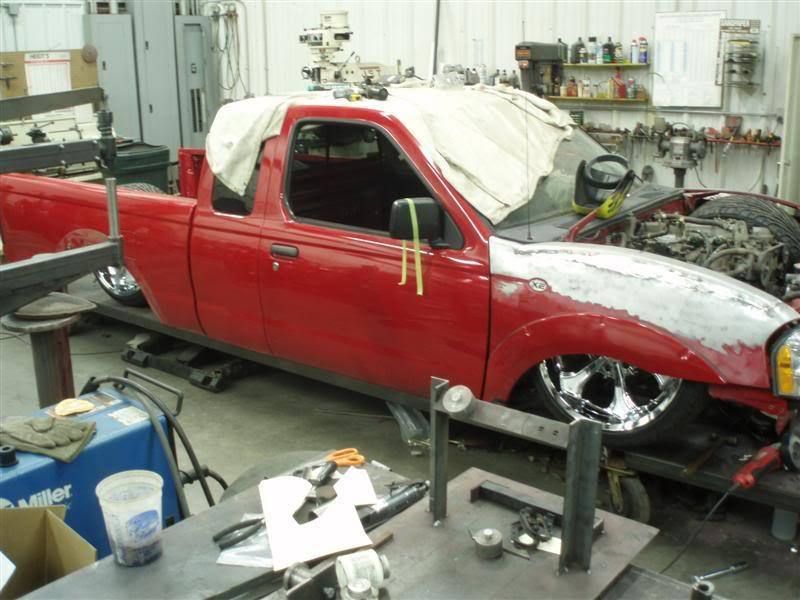

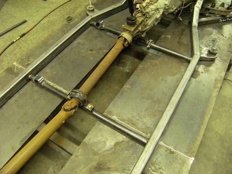

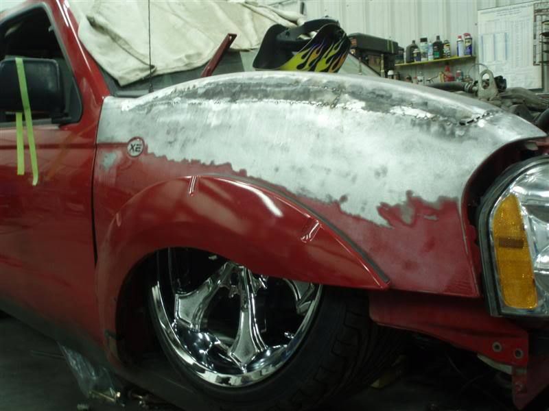

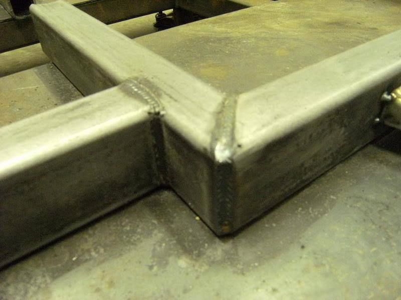

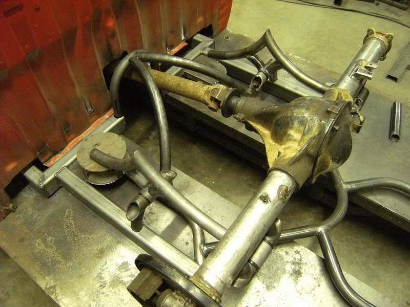

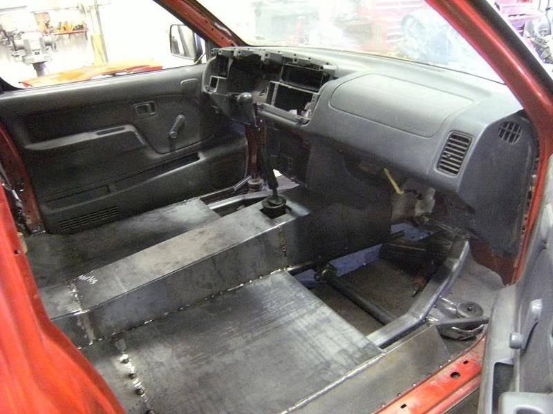

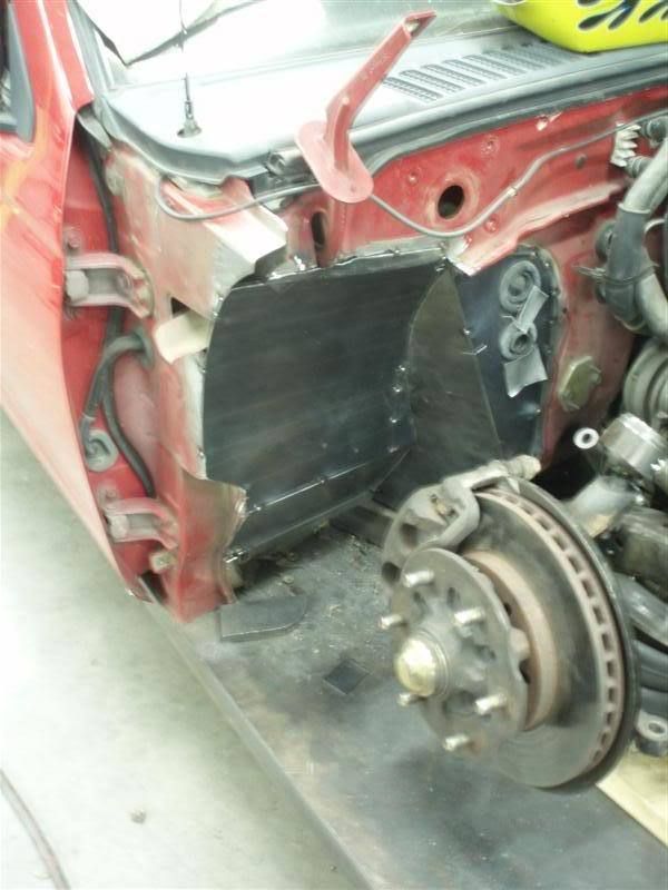

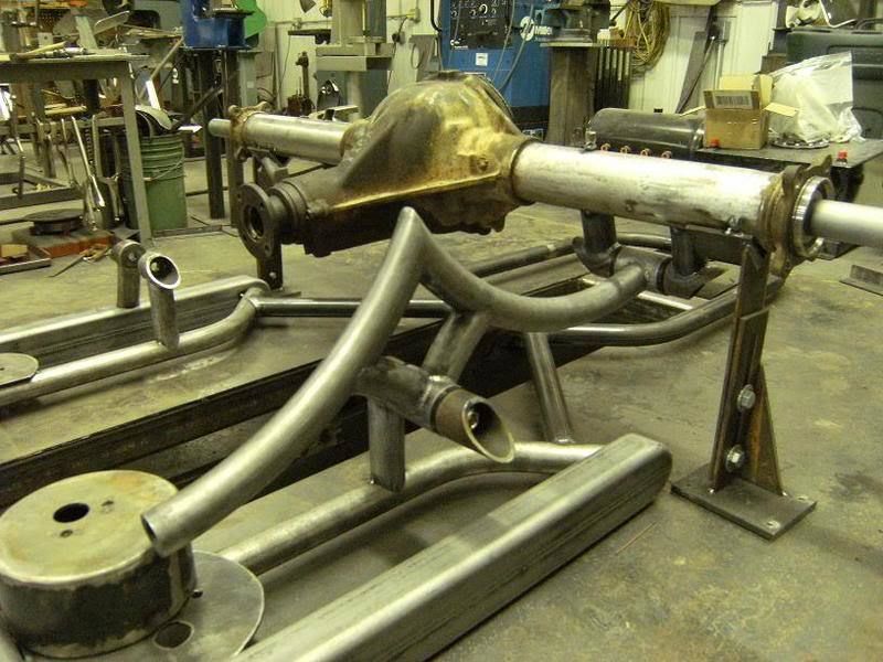

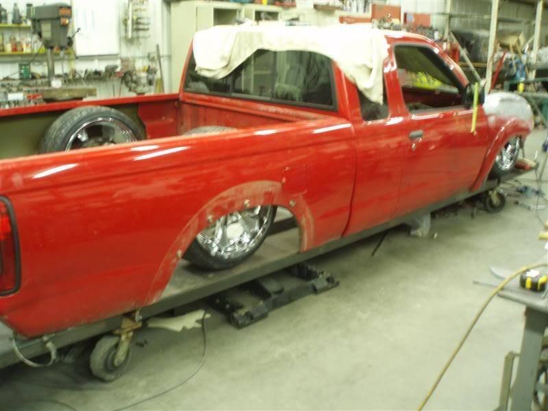

Heres what ive been playing with since my yota is up in KC. Its a 2001 Nissan Frontier that came from a friend in Oklahoma.
Plans are:

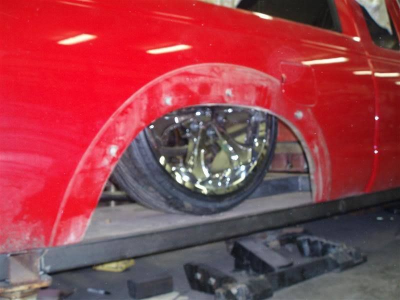

cut to the doors (true door)

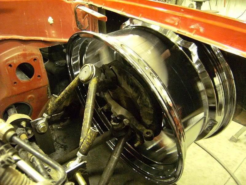

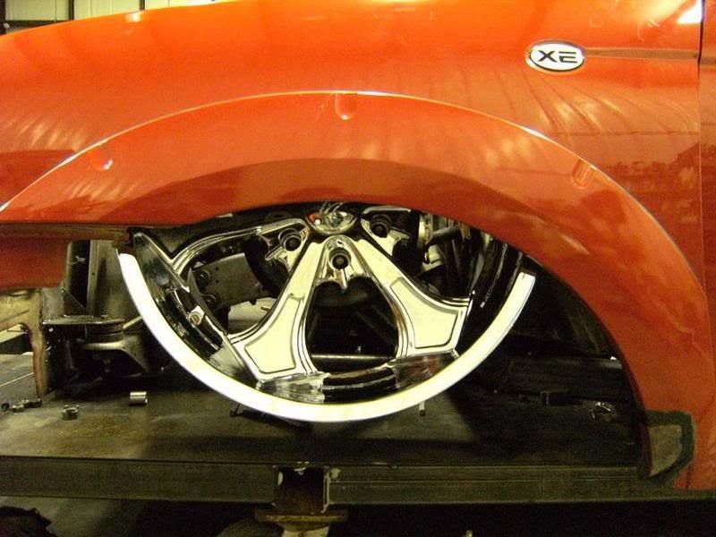

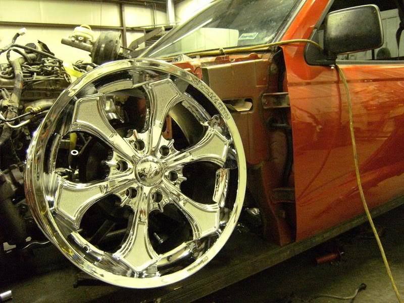

20''X9.9'' Martin Bros Hammerhead wheels

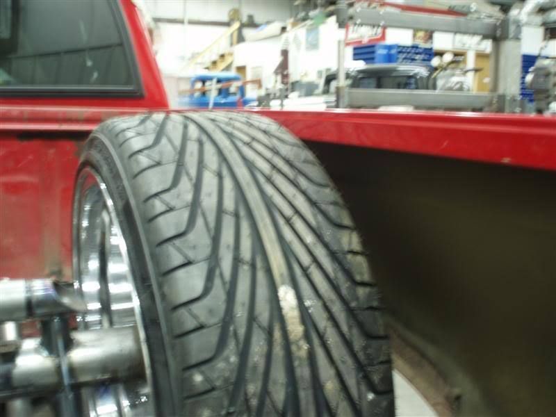

255/35/20 tires

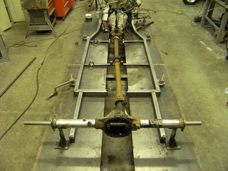

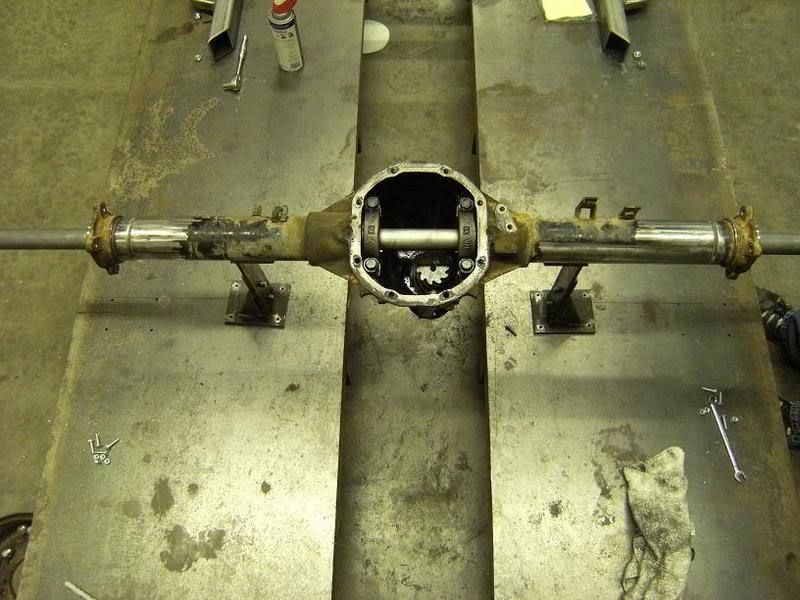

Narrowed rearend 7 3/4''
Custom upper and lower arms
flipped drag linkage (helps with toe in)
1.25:1 Cantilever link setup

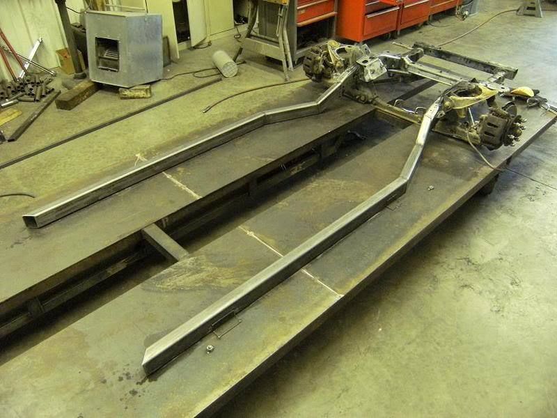

underslung frame
smooth sheetmetal floor

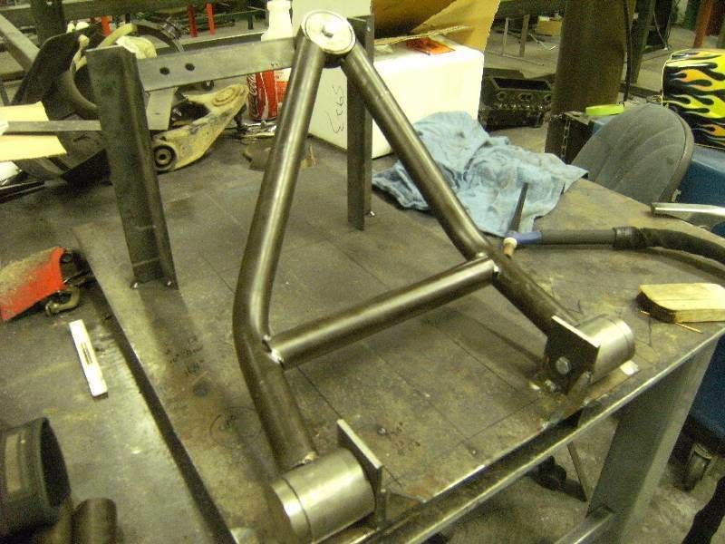

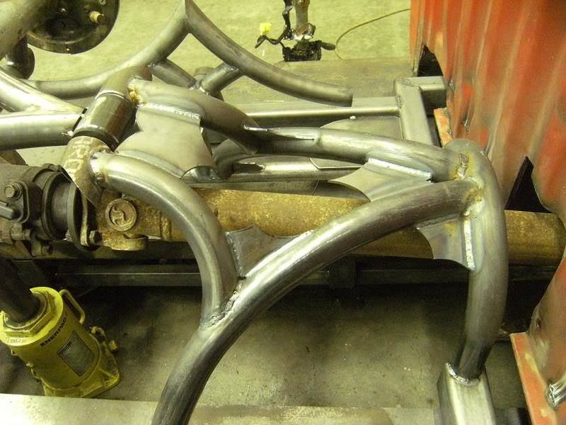

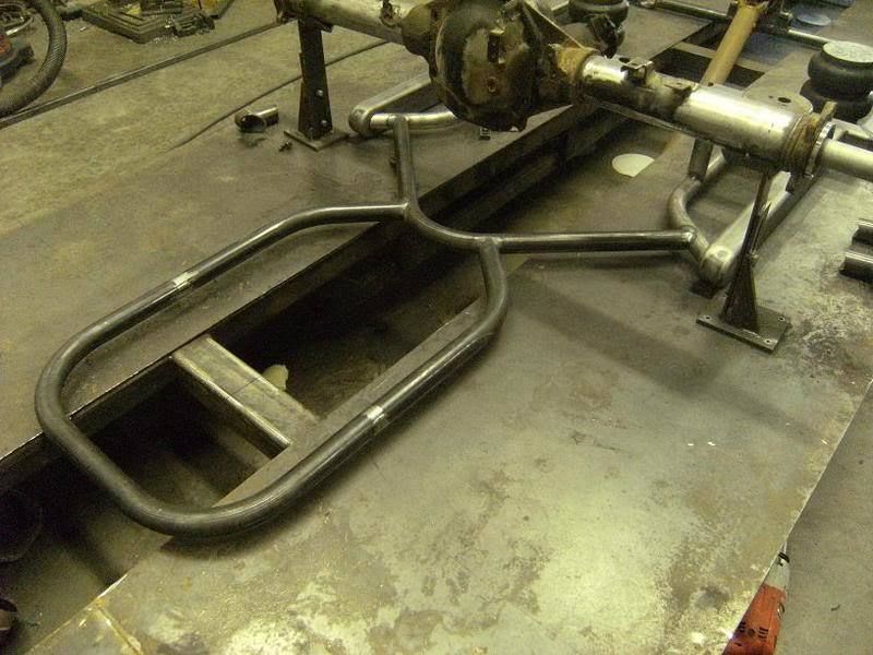

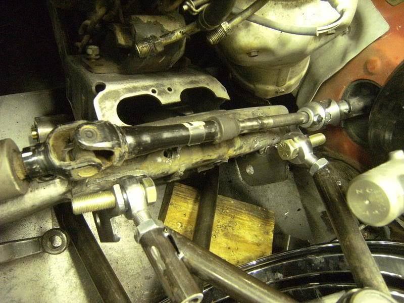

Canti arms

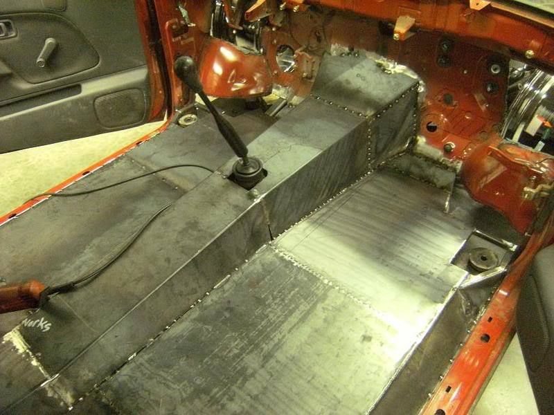

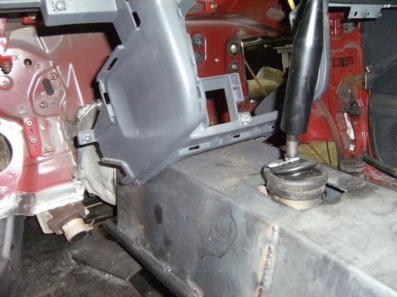

Floor
Stock dash fits back in
LCA

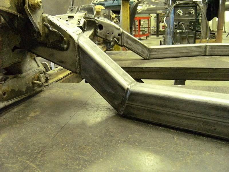

Most recent work with my new 180* die

pig rig's avatar
pig rig
looking good kyle but my only question is those wheels arn't spinners are they
guilty by design's avatar
guilty by design
no... guess it just looks that way. Unless you want them to be, sir.
