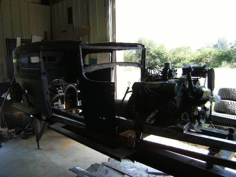

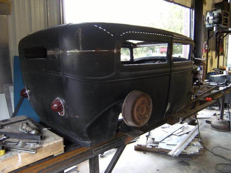

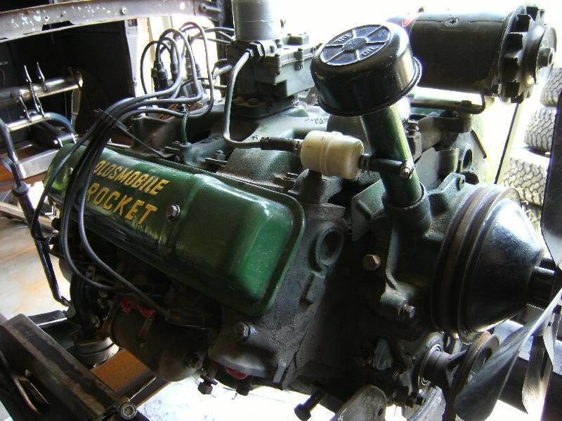

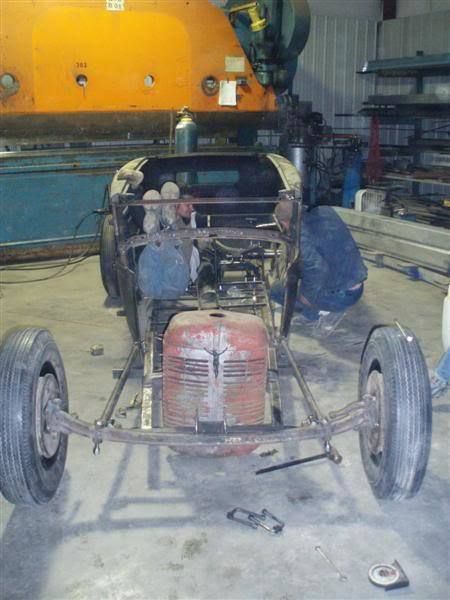

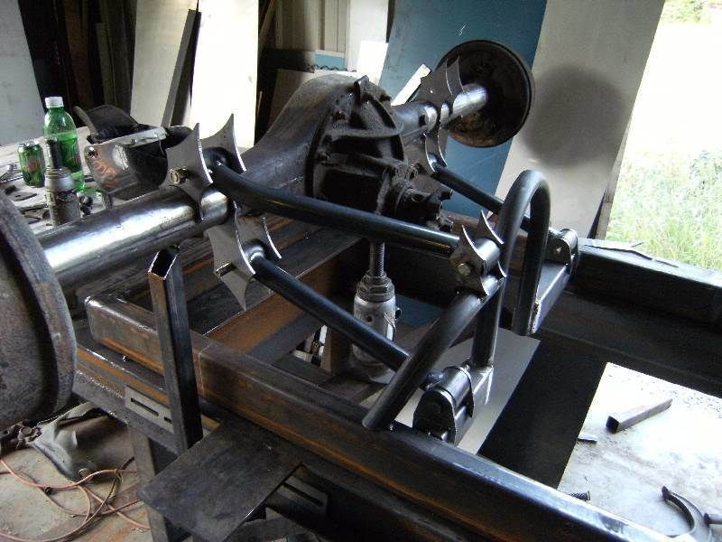

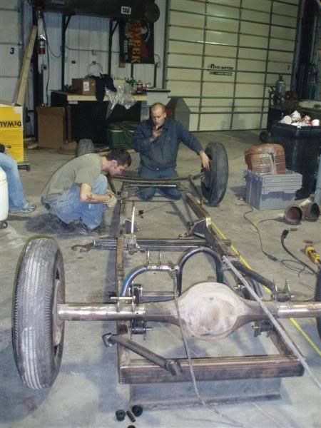

Got a 31' model A sedan in the shop right now, it belongs to Shawn Arcidino from Kansas City. I built a full frame for it with lazer cut front rails that are stretched 12'' and meant to look mandrel bent. The backhalf is an air storage tank that holds 3.75gal. Were using a 54 Oldsmobile rocket motor (heavy as hell), a ford 9'' rearend, triangulated 4 link, 34 ford front axle, massey-ferguson tractor grill, and shawn has already chopped the top 6''.
Started friday night with the framerails done and got the majority of the car built in 2 days.
The car will get a cantilever setup behind the axle with slam bags, wood floor, sprint car style steering, and a metal roof. Its being built with as many original parts as possible and in the end will just be a hotrod. Please do not call it a ratrod... i will stab you in the face with a soldering iron.
