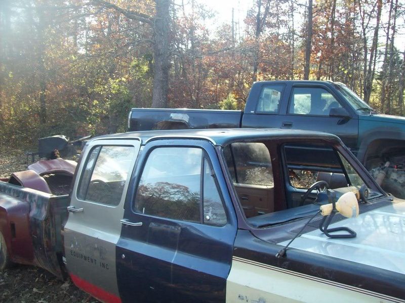

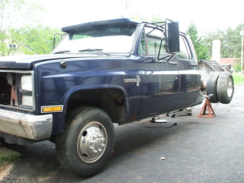

So i travel 1200 miles from home to work at a buddies shop and low and behold what is sitting there waiting for me..
None other than Gregs dually.... small world eh?

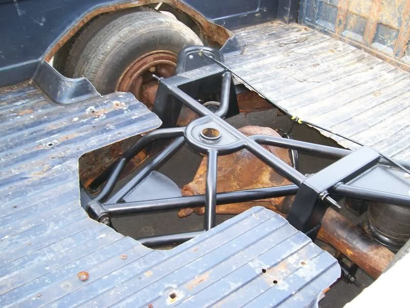

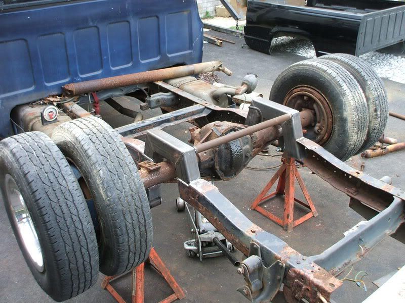

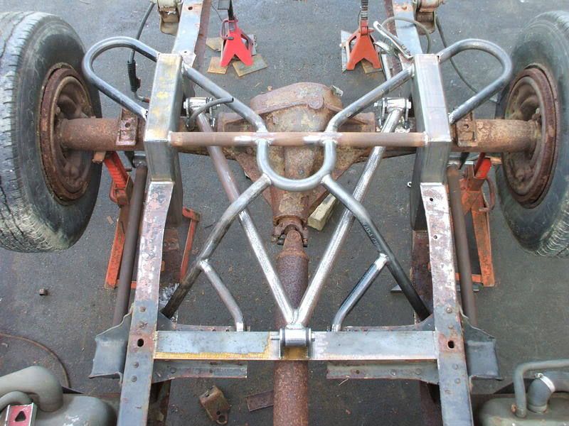

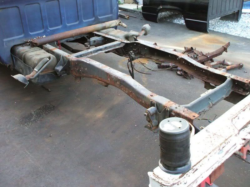

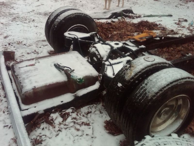

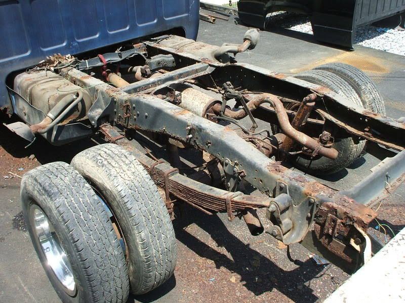

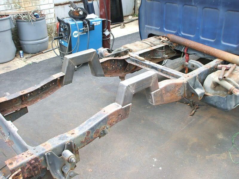

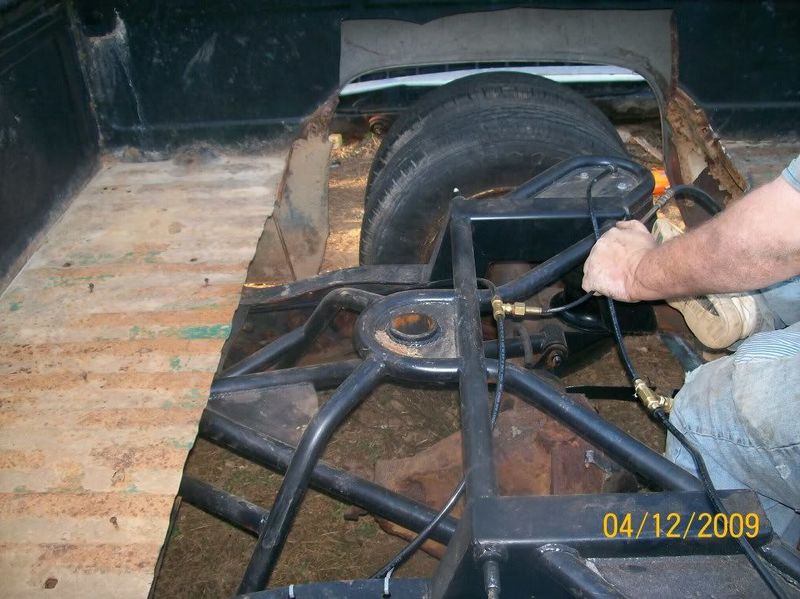

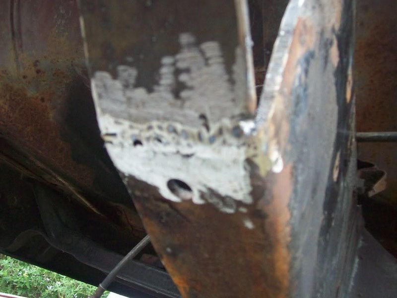

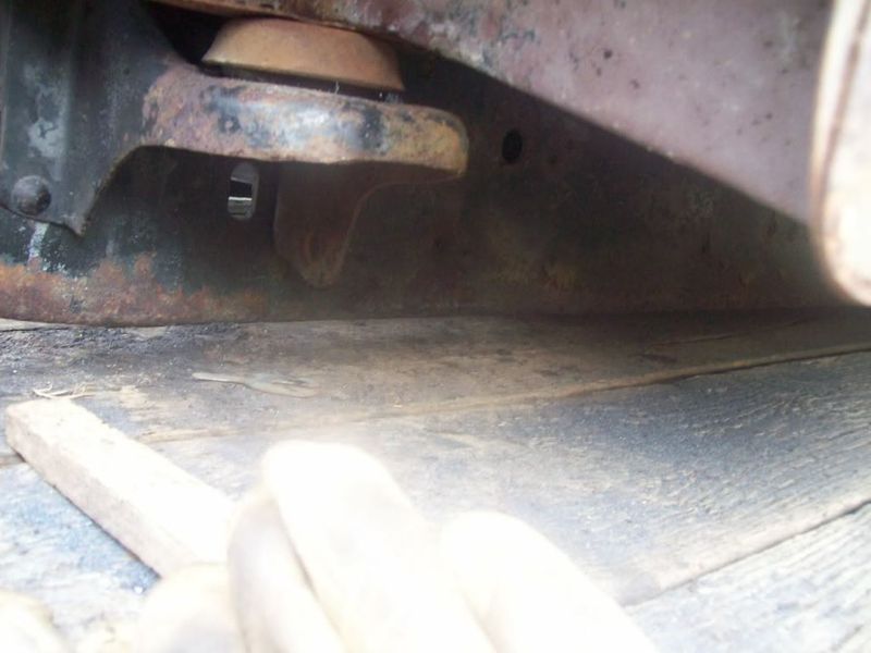

So i get my orders from the bossman, rear bags, notch, link setup, and a gooseneck reciever.
So heres what i have to work with, glad i got my tetnis shot already.
Cleaned up

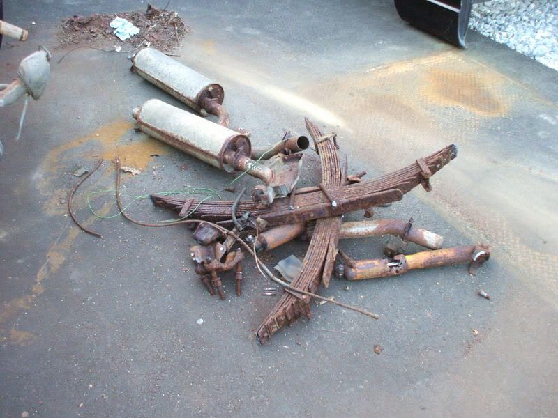

Wont be needing any of this...

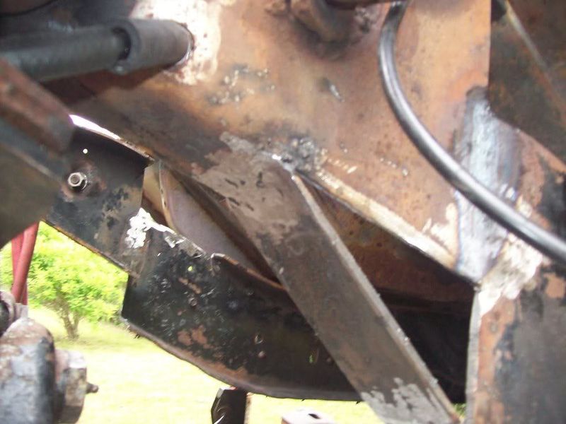

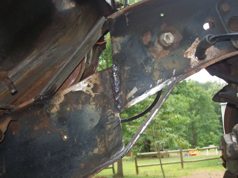

Notched

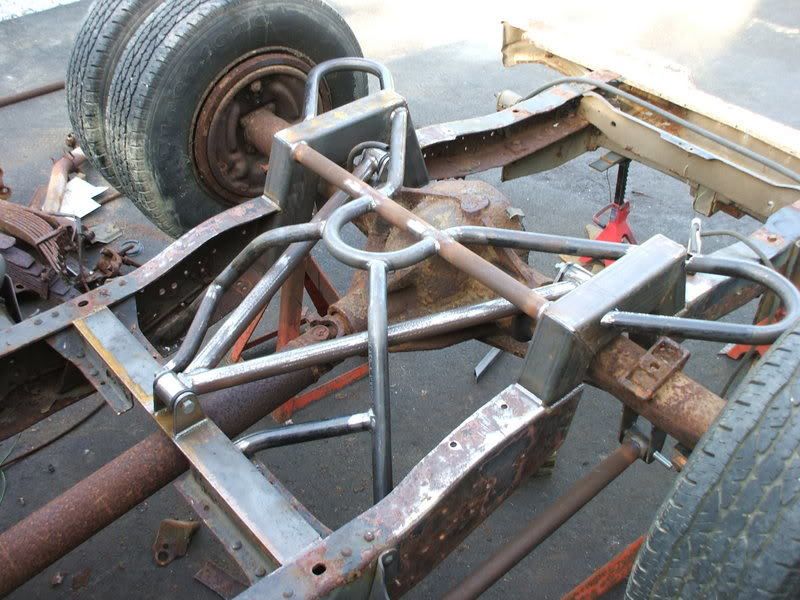

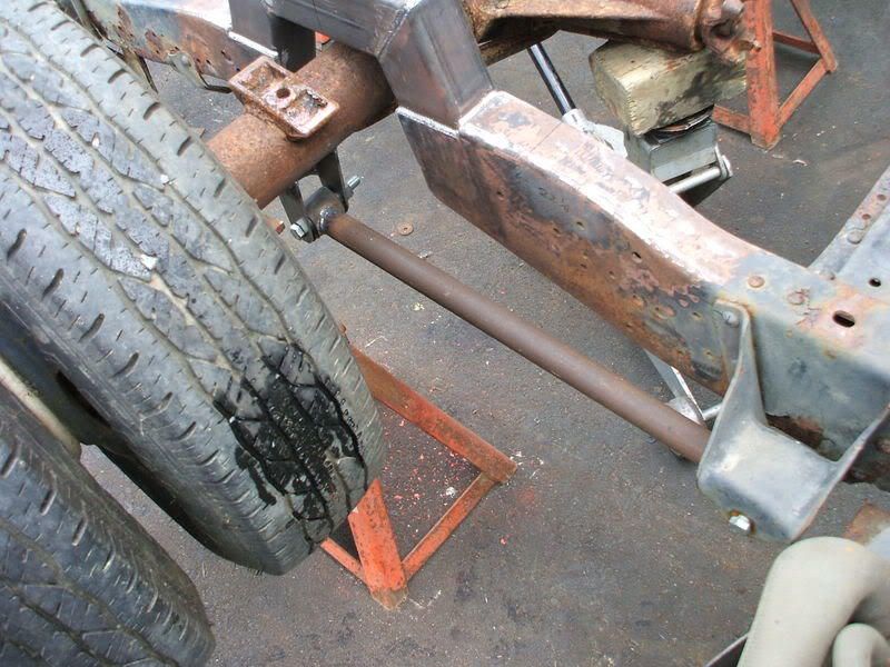

Setting up for axle
Link bars

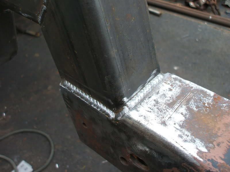

Thats as it sits today, couldnt work on the wishbone because the welder was being used. All the work is being done at Haggard Fabrication.

Aaaand 1 more
maz89
I think you're gonna need another tetnis shot there Kyle.... Lookin' good man, keep us posted!!
low95xlt

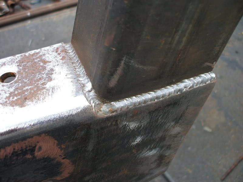

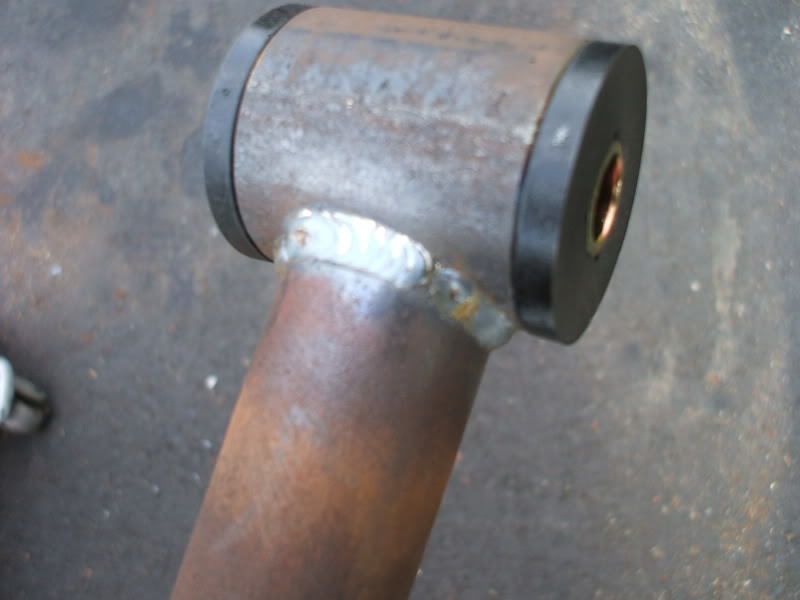

damn man nice weldign there and lookin good
lockone's avatar
lockone
Lookin good. Looks like you are making fast progress.
DK
diabolic kustoms

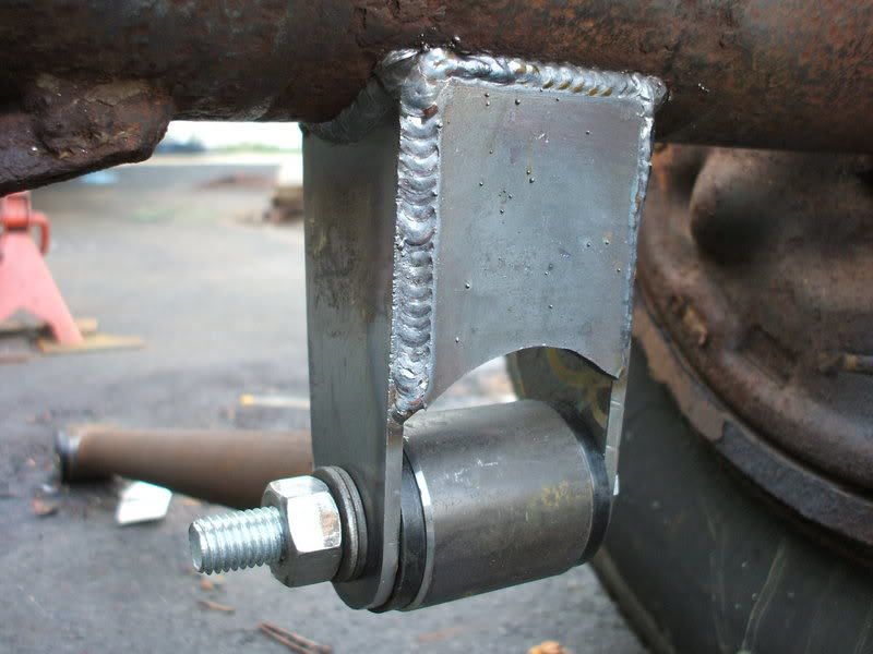

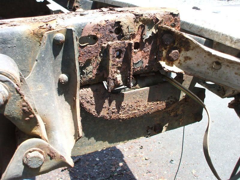

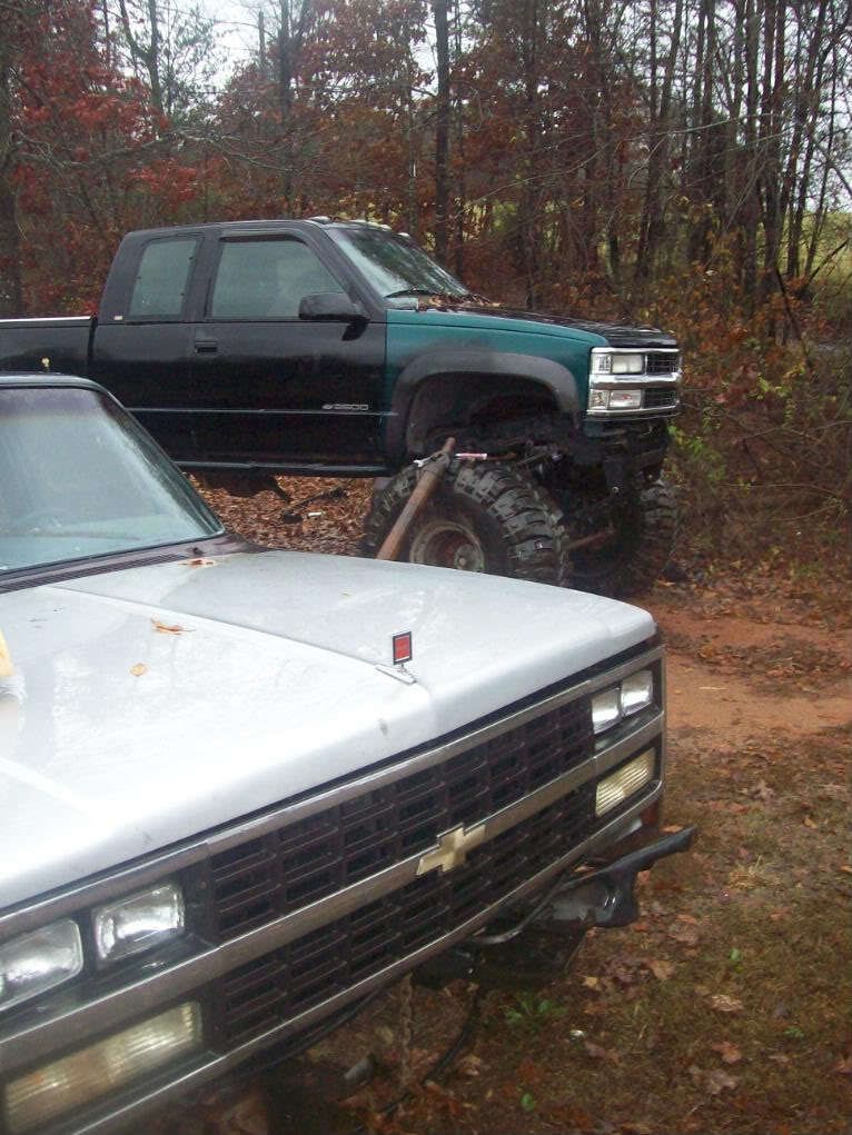

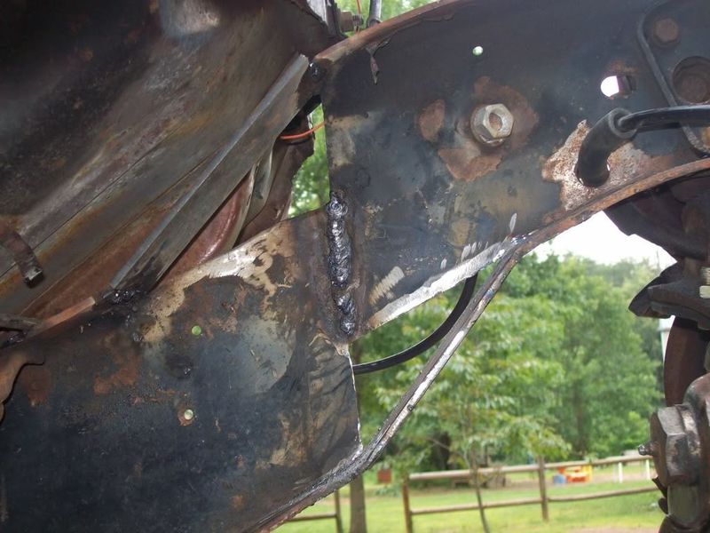

looks good.. haha another squrebdy. that axle looks a little rusty for you to be welding to though
guilty by design's avatar
guilty by design

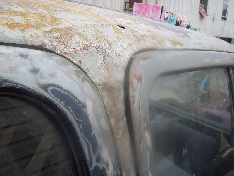

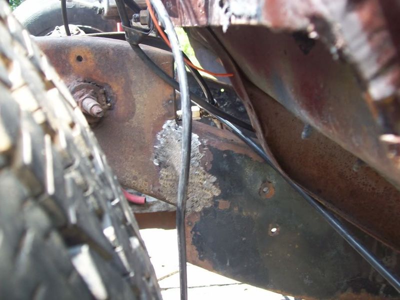

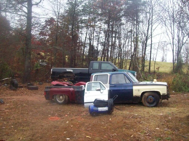

You have no idea DK. I used up 2 flap disks on the whizz wheel just cleaning the general area, then tack welded the tabs on and then carved a root directly where the weld was to go with a grinding stone. If you notice in the 3rd pic all the rust and whatnot on the ground.... thats what just fell off while trying to take the bed off. Look again in the pic of all the parts in a pile and youll see all of it swept up.
pig rig's avatar
pig rig
welds look nice I was A little worried that you don't have enought solid metal to weld
and I bitch when theres dirt and surfface rust
a fit
low95xlt
bitch - throw a temper tantrum like a lil school girl huh pig?? hahaha she a lil rusty but trusty its a chevy
pig rig's avatar
pig rig
hell yea more so when I'm on someone elses dime
