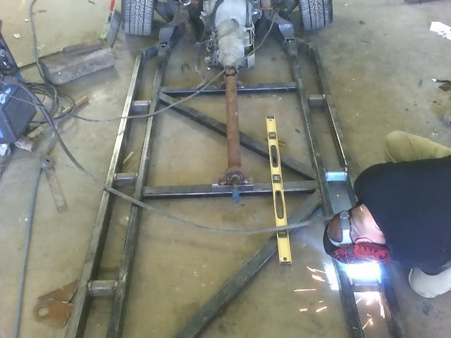

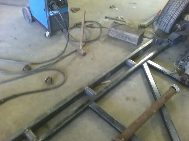

Here are some more pics that I took yesterday.

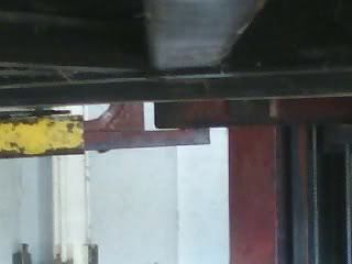

This pic shows some of the great craftsmanship that I had to work with. The inner rails were the rails that were originally built for the truck and they were more crooked than my d*$k. You can see the bow in the pic, our frame rails are in the back of the pic and the original is in the front. There is a good 3/4&quot; difference due to master welder welding a plate solid down the whole bottom of the frame. We just used the original frame that was built from 2x3 for some added support and built our 2x4x1/4&quot; rails for the strength.

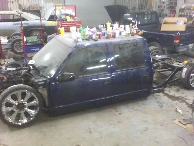

We took these 2 pics for PigRig becasue he likes to make jokes about Paul Sr. cooming into bust our ass about all of the cups lying around the shop.
Well he can kiss our a$$.
