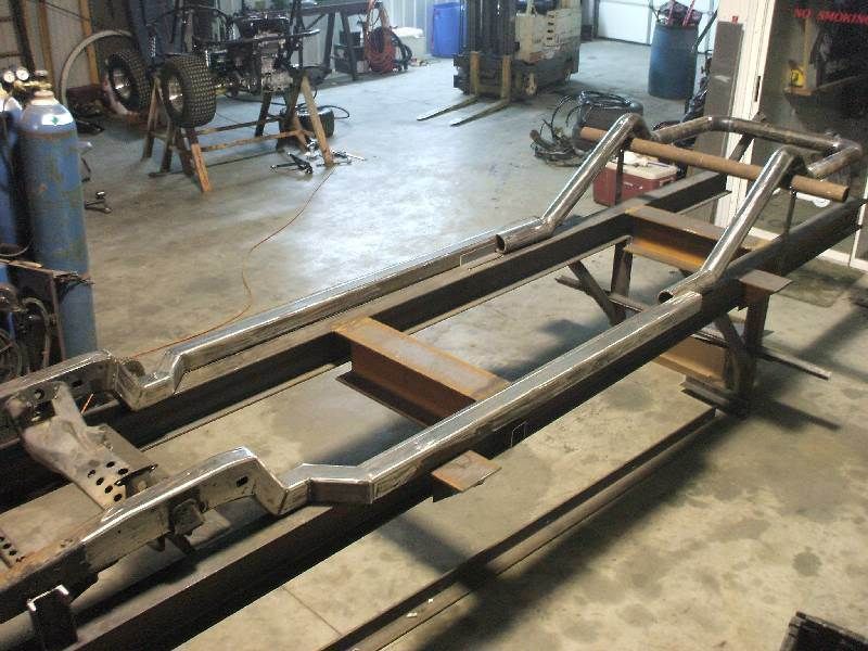

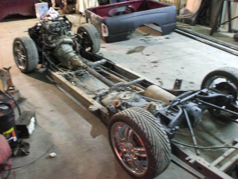

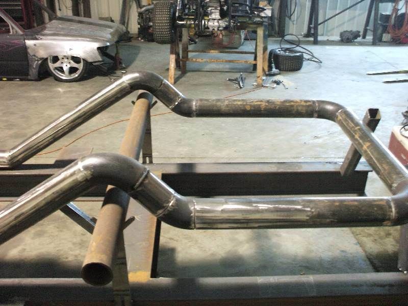

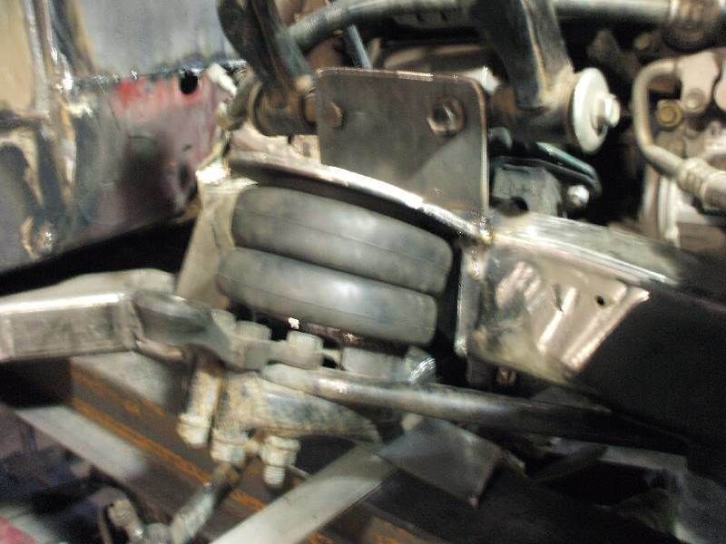

Heres the taco ive been working on. Belongs to a petitioning member of NR kansas. The owner is a forigen exchance student from japan, eventually you will see where that has any meaning.
Started with the usual weekend warrior built truck...
Tear down didnt last long...
SFBD 3/4 chassis...

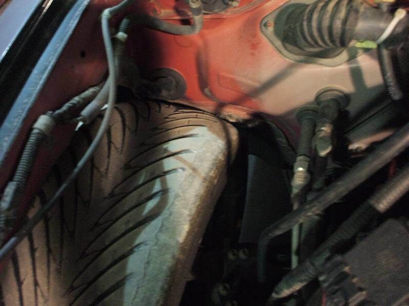

Had a little trouble with the front, apparently this is the only tacoma in the country that cant lay a 18 by flipping the BJs...
Fixed that by redoing the UCA mounts and moving them up 1''.

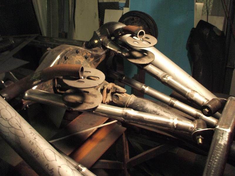

Now the past few days ive been working on the frontend and 4 link.
Ive got till Midwest Dragfest to get it built, then its off to Shawn to look pretty.

in the mean time you might want to talk kawasaki soyrice into calling lock for a retread kit for that front right

do the link bars resemble bamboo?
