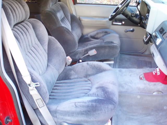

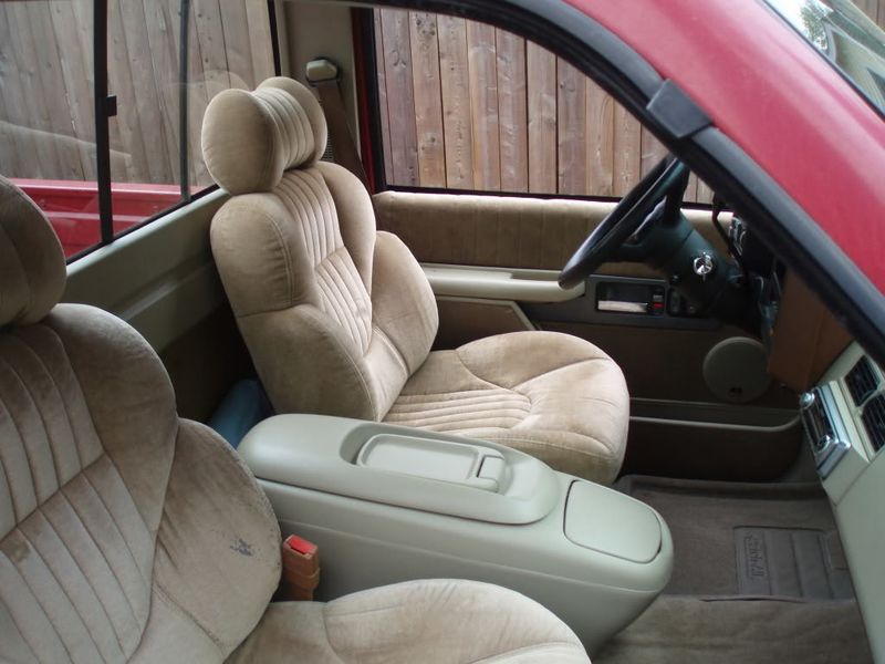

If you have buckets, Pontiac bonneville seats (availible in leather) will bolt directly to the truck seat risers. (power, or manual) if you have a bench, disassmble the riser and use the sides for one seat. Then you would have to score another set of risers, and drill the inner mounting holes for both seats.
My '91
My '94 (with power seats)

those look very nice in there . how did you know those bonni seats would fit ? was that a lucky guess and you had them and they were going in either way haha or did you know they would fit ?

I didn't. My brothers girl had a Bonneville, I sat in the car and said I have to put these seats in my truck some how, someday. Then a buddy had a car that was being scrapped at his shop so I snatched them. When I got them, it was just dumb luck that they fit the GMT400 seat risers perfectly! no mods whatsoever. not even an elongated hole.
They also have a 60/40 version with an armrest.
I even put two in the rear of my suburban. That was a little more involved.
