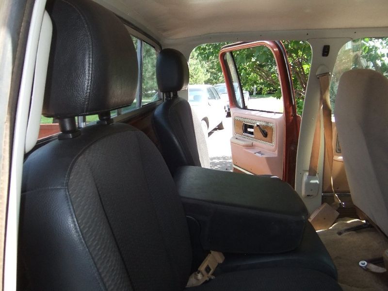

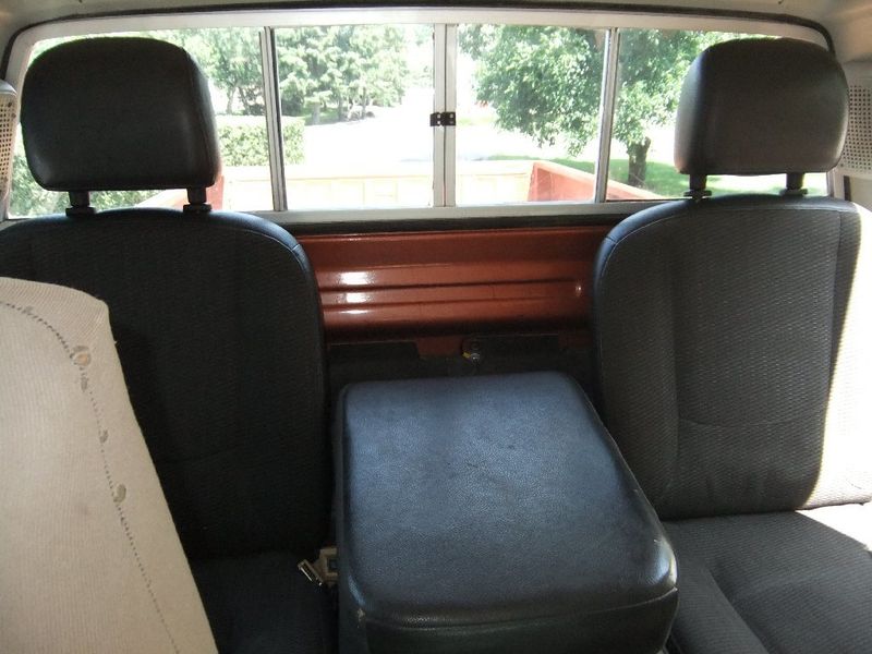

I just put 2005 Dodge Ram front seats in the back of my square. Picked the front and back up for $40.
