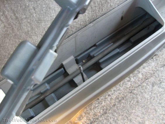

It looks like I'm suppose to have a Jack in here?
This is on the pass side behind the back seat.
& what years had the same parts in there?
I'm thinking of visiting the Junk yard for what ever might go in there.
But I'm not sure what all is suppose to go in there?

yea the jack and the ratchet handle for your jack and the deal to lower your spare tire if I remember right
liljlowrider's avatar
liljlowrider
^^^^ yep what pig said... mine is a 2000 and had those parts but dont know where they are now..

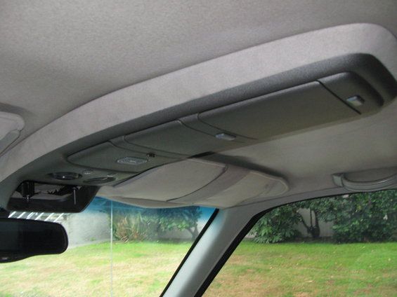

OK I have some questons about other interior parts.
Like what most of these compartments are for.

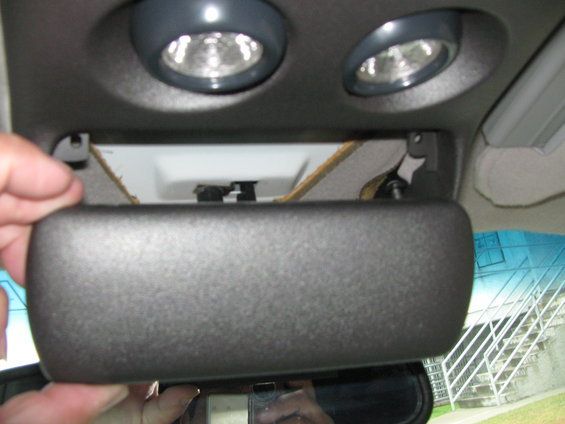

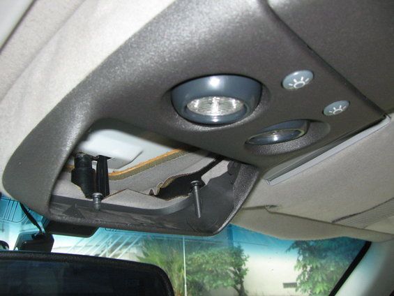

When ever we have a good rain I get water dripping in from behind this plate.
I took the face plate off to see how much water I might have sitting up there or moister damage. It looks ok.

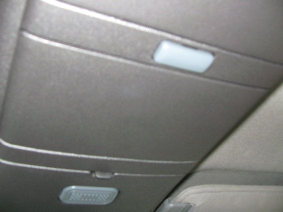

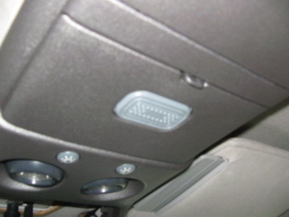

Whats this compartment for?
This one holds my glasses just perfectly.

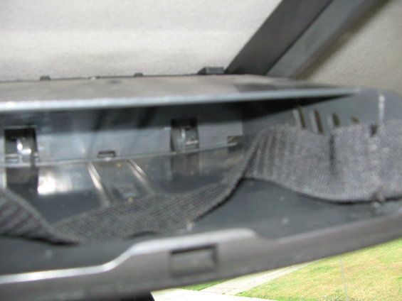

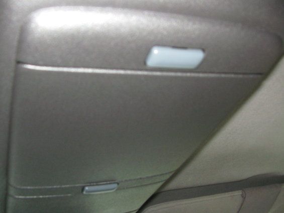

This last one seems strange as well?
This is as far as it opens.

The water is from your running lights on the roof. I took all mine off, then stuck each screw in some silicone to before I put the ligths back on. Have not leaked since.
E
ec_dually
yeah the rubber seal around the lights is letting water in, the compartments are
1. is for the garage door opener if you have one
2. is for sunglasses
3. is for cd and sorts, i have the same overhead in mine..

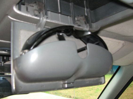

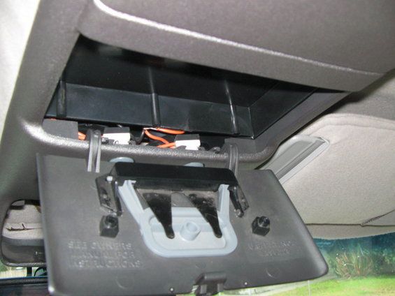

what about -01?
what is the face plate I removed there for instead of what factory put there?
I can see how the button would be for a garage door & I suppose I could see how chevy had made a bad design in a cd holder.

some had an opitional compass and outside temp there
thewebwheeler
was'nt that in the interior mirror?
