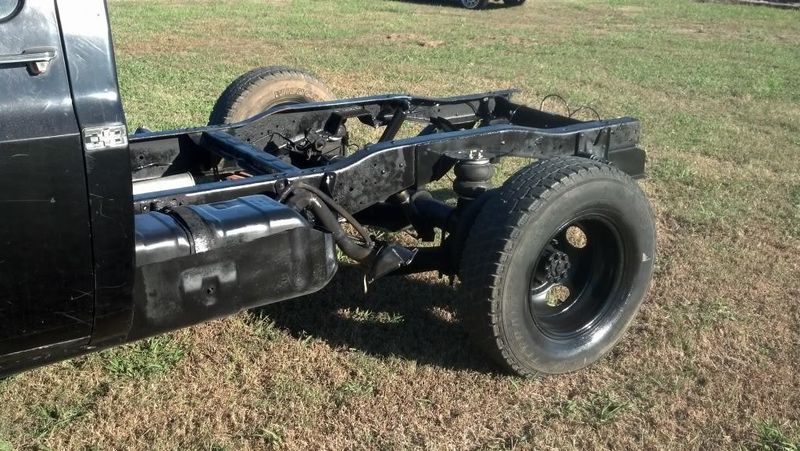

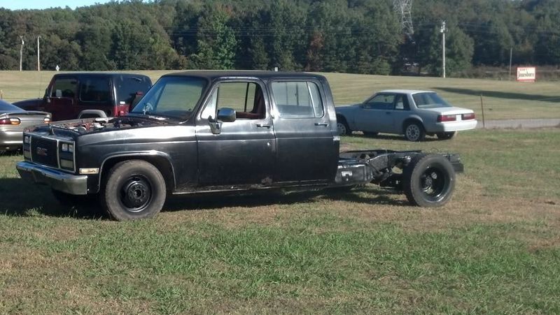

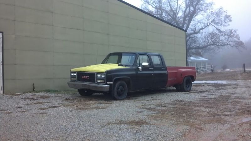

Lil update on the truck.. got the flip and notch built and installed. Was a lil low in the back so i put some helper bags on it.. cut a 1/2 round if the drop springs so the front was a lil lower
lownslow
Anyone got any clues on where to get a hidden hitch for this truck so I can pull my trailer.. I already have the roll pan on the new bed and its bolted on the truck..
