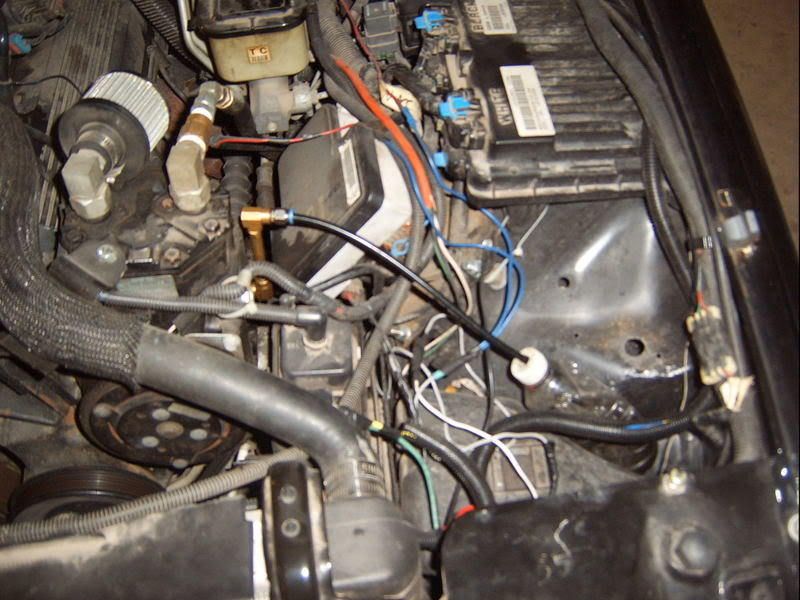

I will see if I have any pics of it. Left or right suction only matters if it is mounted on its side. I made my own bracket and is mounted right above the power steering pump. Its been on for a few years and cant remember all of the specifics on how I mounted it. Kilby enterprises has a ton of info on their site. They sell everything you need but is a bit pricy. Last I checked ebay had 210's with serpentine clutch for like 170 or so remans. I need a new one, when my last line got a pin hole it kept running and overheated and doesnt pump well now. I have a light on my dash so I know when it is running but couldnt get pulled off the freeway in time and smoked it pretty good

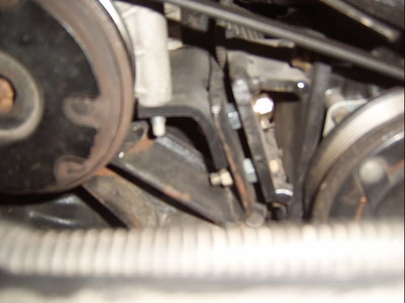

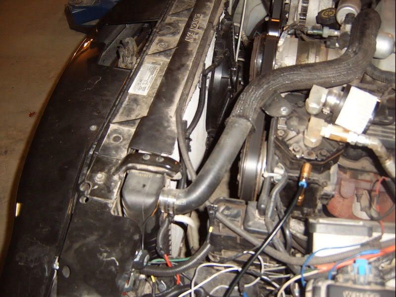

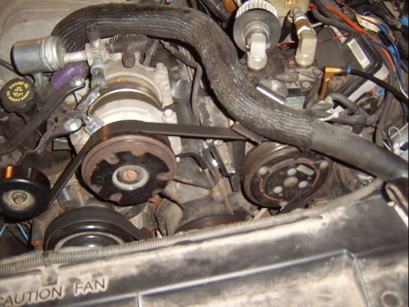

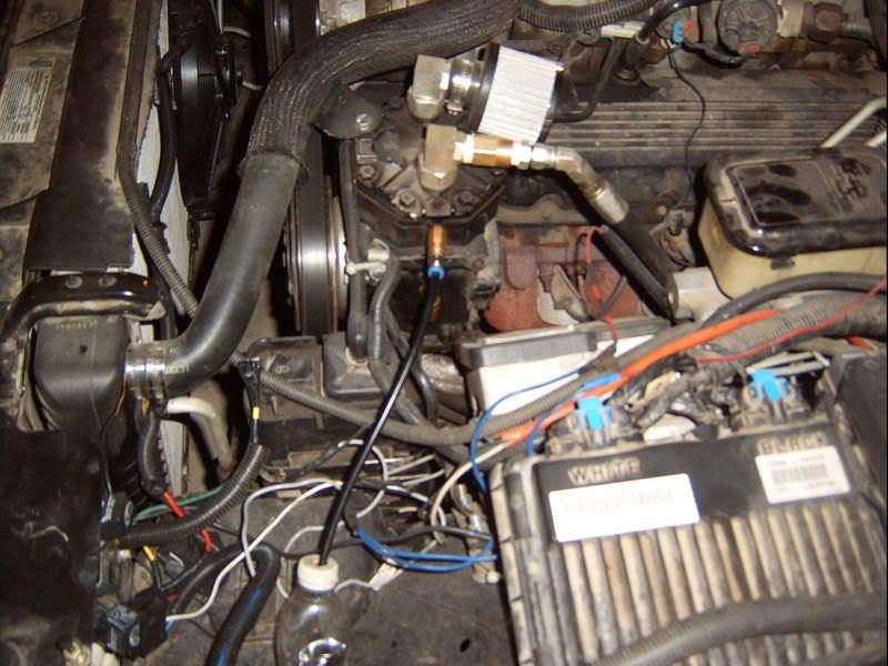

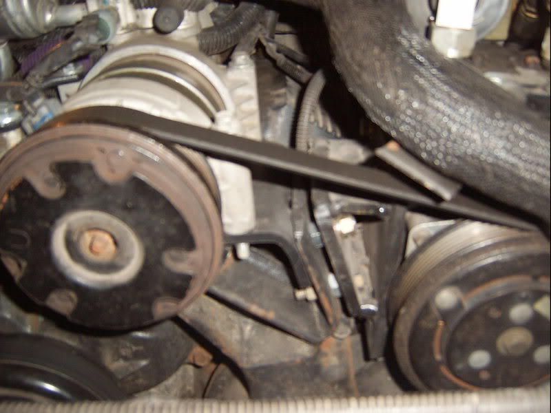

Did somebody say pictures? Heres a few...
I had to lower my ac compressor to clear my hood and integrated the two mounts together for both the york and ac compressors. It is sort of a tight fit to tight then bolts, but it works great.
