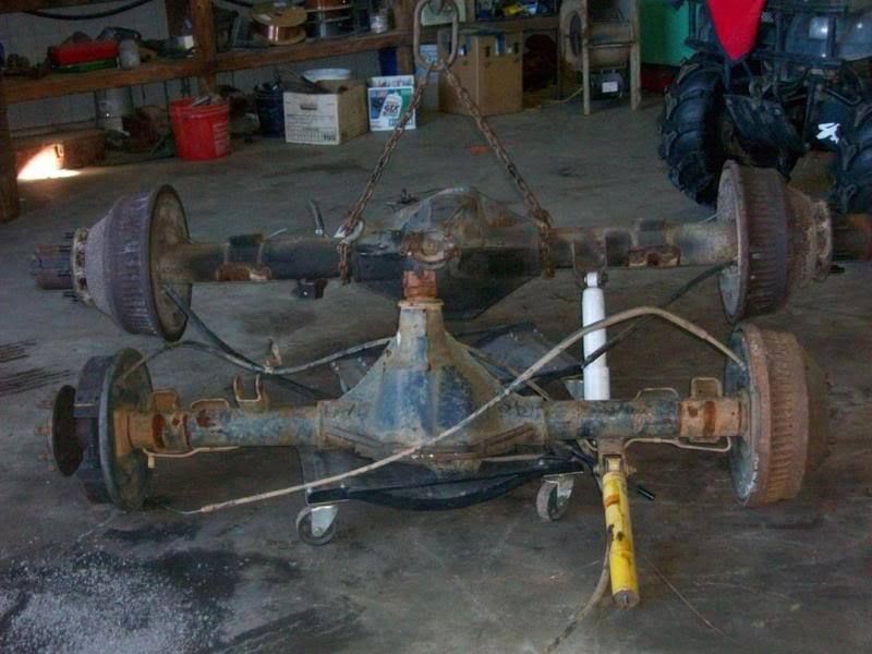

i just put the rear under my truck yesterday...it is a 3/4 ton rear end out of a 97 2500 truck...its 8 inches shorter than the stock rear end...you cant run 16 inch inners but if you are runnin 6 22s it works great and i still had plenty of room to run the link bars on the outside of the frame...ill try to get some pics...the rear end was 100 bucks from the U Pull it yard

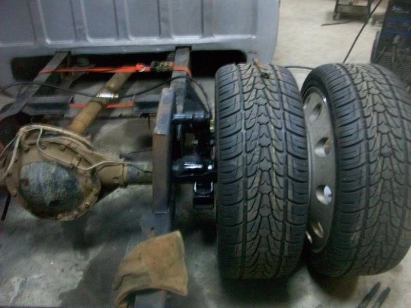

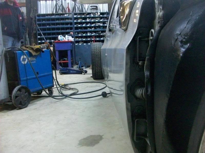

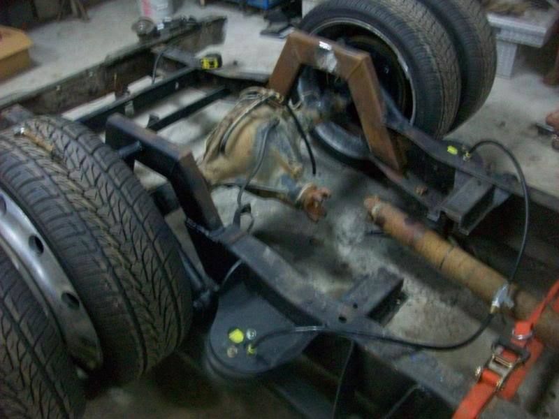

snapped a few pics at the shop a little while ago...the rear end come out ok a 97 2500 chevrolet truck...its 8 1/4 inches overall narrower...i worked out good on my truck so far and according to my measuring tape they should tuck 1 inch inside the fenders..had room to mount my 2 link outside the frame..here a few pics

thanks for the pics and info visual is always better what all did you have to swap over from the 1 ton axle?
