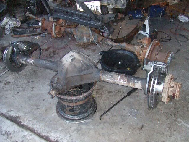

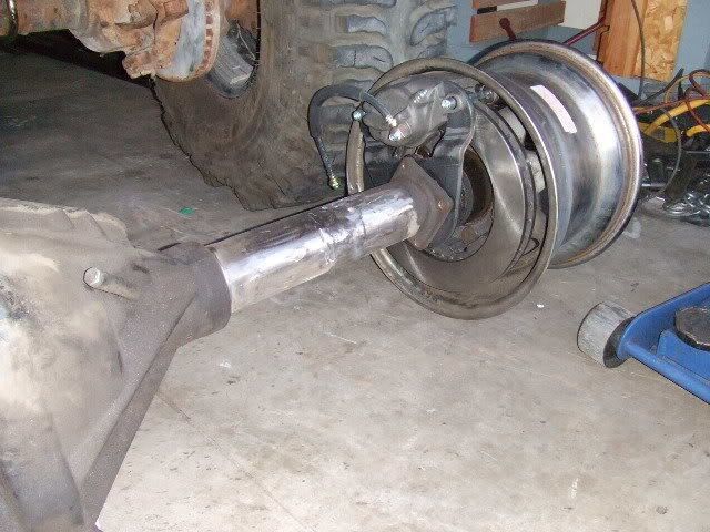

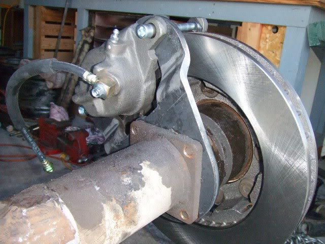

There 3/4 ton 8 lug 4x4 front rotors?? and i didnt go with the eldro calipers w/ e brake....there to much $$$
Ill hit u tonight with all the info...i thought i put up a link to the brand i have up on Shadys old project profile if u want to look back for it??

One dude has a complete kit for this.
I personally like the bent brackets from Ruff Stuff though.
You can use Eldorado calipers for the option of e-brake and you can piece together your own kit. Everything is off a 1978 era 3/4 ton chevy truck.
