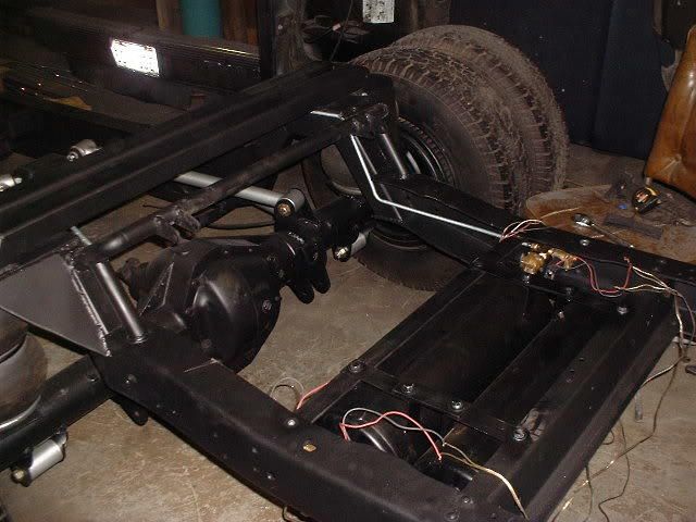

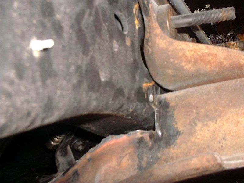

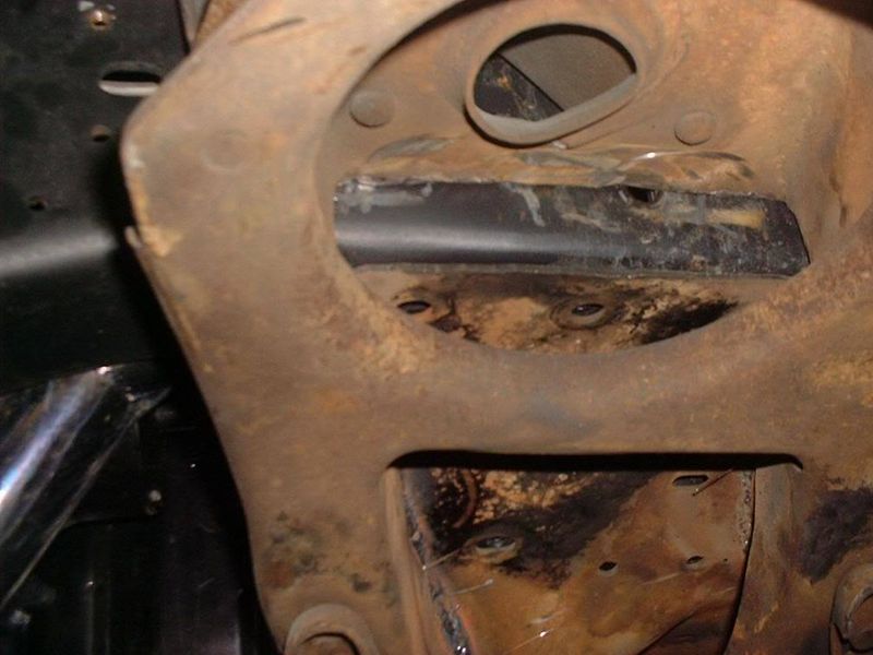

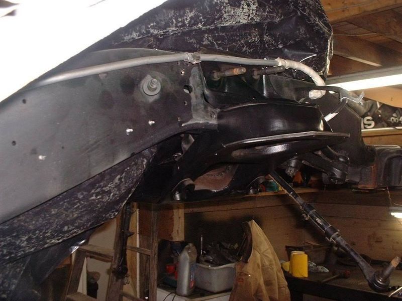

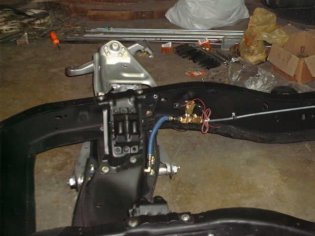

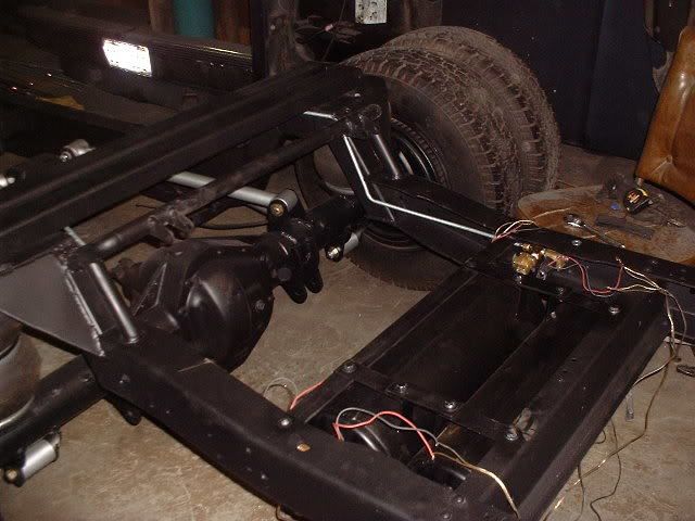

so whats with the air fittings going into the frame??? did you seal that thing off and make a tank out of it??
blazerpimp's avatar
blazerpimp

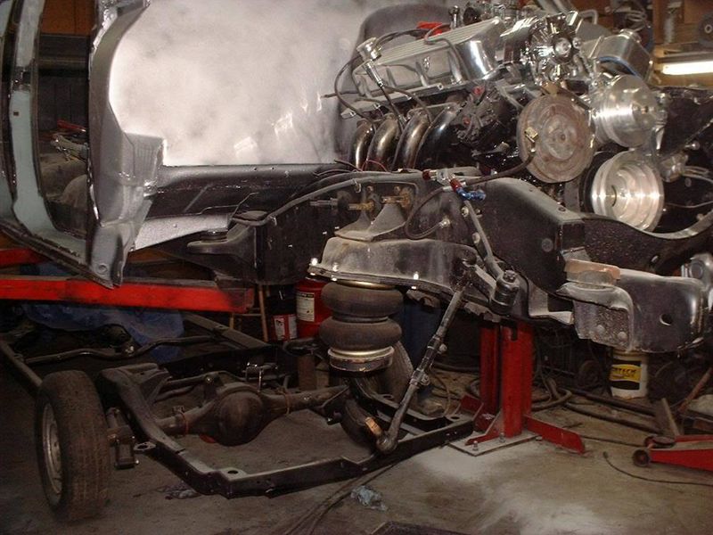

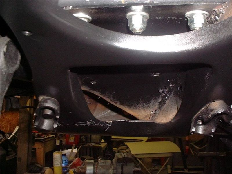

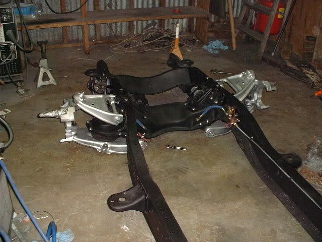

also, is that an alternative to "Z'n" the frame?? Ive never seen the crossmember done like that..is that pretty standard??
skidrow

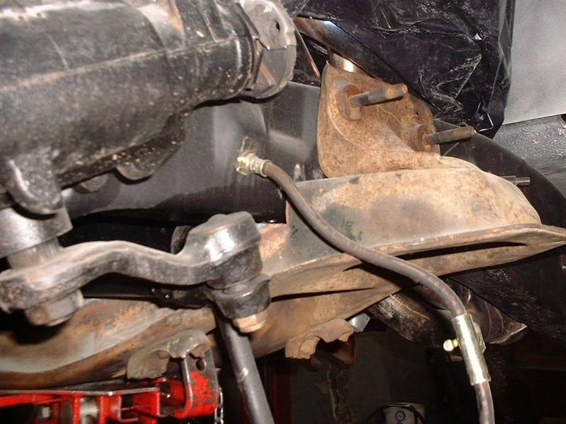

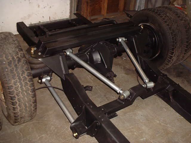

ya i dint what to z the fram and have my engen hanging out the hood and yes on square bodys to lay frame flat thats what you have to do or your lower a arms hit the ground 1st
the lines are going thru whats caled a balk head fiting and then to the bags in frount
you know me i hate air leaks ans line problems so all my shits hard lined and dot flex line i realy dont want to be haveing trubels with the suspention with the 31 foot tralor loaded and my 3 year old in the truck at 70 miles and hr would not be a nice

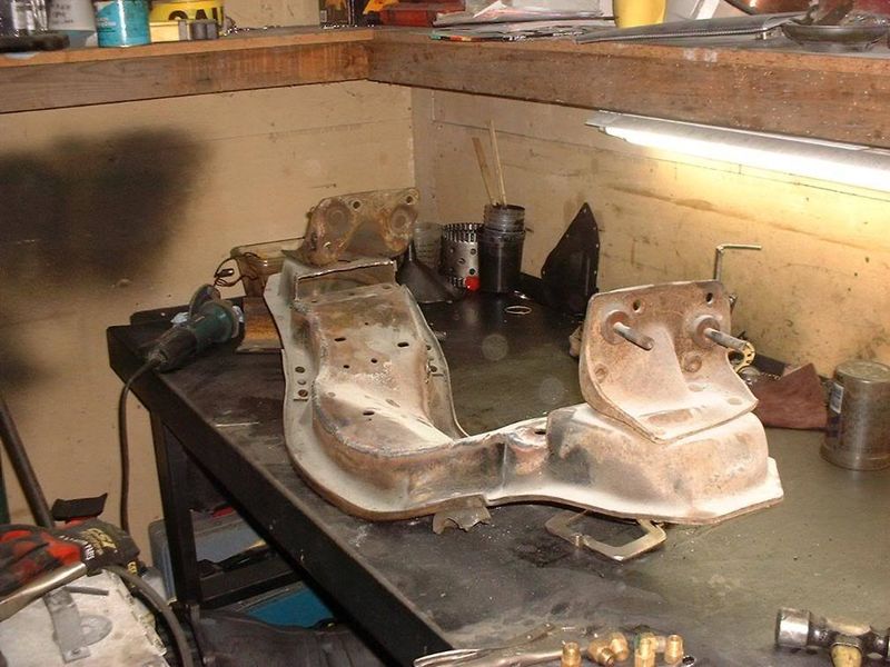

you need to come by the shop and look at the truck and ask ?? dude i have and extra x mimber to section
huskerdually
There used to be a company that sold the plates to section it like that. Bill Miller I think but I think he is defunk now.
