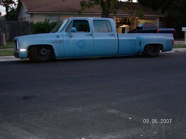

I have to z my frame

becaus the front of the frame does not lay, the Arms are on the ground along with the k member, and the frame is about 1 to 3/4 of an inch from laying
BD
b dime
hard to tell in this pic because the road is sloping down, but the back of the body is lower to the ground than the front.

for the orginal question, see if thses pics can help. I have RE8's in the front though
