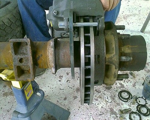

The problem with the brakes for my 14 bolt is I guess a 14 bolt full floater dually rear end is a lil wider on the ends than a 14 bolt full floater single wheel rear... So the caliper bracets are 2" from where they are supposed to be to bolt up.. So we are gonna just weld the bracket to my housing. They send a 3/4" spacer to space the bracket out from the mounting location.. BUt mine is 2" off and I don;t trust putting the big of a spacer in there.. I'd rather weld it on..
Oh and there's the Disk brakes I was talkin about Matt....

The kit i have the rotors like six inches thick...way thicker then the one in your pick.
ben_shady1
6" thick? Lemme see them.. What kinda caliper did they come with?

I wonder what those rotors come off of... think they will tell me if I e-mail them?

They should? mine has a alum. space/adapter you could see it between the rotor and hub...it makes the two hub centric...the rotors center hole is about 1/2" bigger then the hub...so i dont think it will work with out the alum. spacer??

Holy rotor, Batman!!! That thing is huge.

There huge!!
