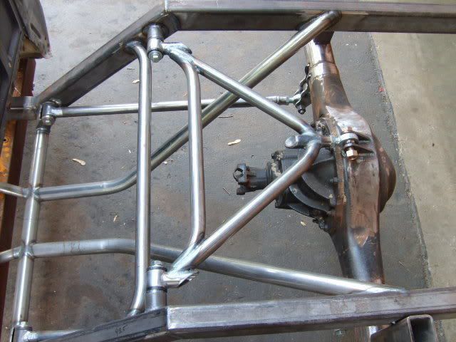

keep the mount height differance within 10% of the panhards bar length. example- 20" bar = 2" max height differance.

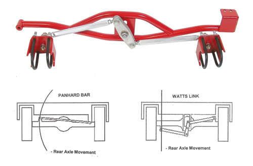

A panhard mounted to the right side frame lowers chassis roll while a panhard mounted on the left frame rail raises during chassis roll.
You can get cheaper watts links
Or just put in a y bar and forget about it..lol
