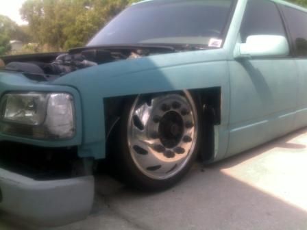

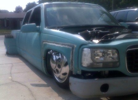

i am finishing up my bodydrop and came into the classic problem "cant run spikes with a bodydrop". this will just not do... so i cut and raised my fenders to clear. would love to hear some opinions of this (good or bad)

i ran into all kinds of issues with trying to clear the rims while retaining the stock arms and rotors. the face of the frieghtliner rims are rounded where the alcoas contour in between the lug mount and the rim lip. i could not clear this section of rim without bringing the wheels in about an inch. i would like to see the article to see how it was done myself. thanks for your opinions. lock, your fenders look good. i did not notice you raised yours until now. another reason i did this was to help clear for turning radius and still have good stroke on the shocks i choose when up. before i had to max out to turn.
