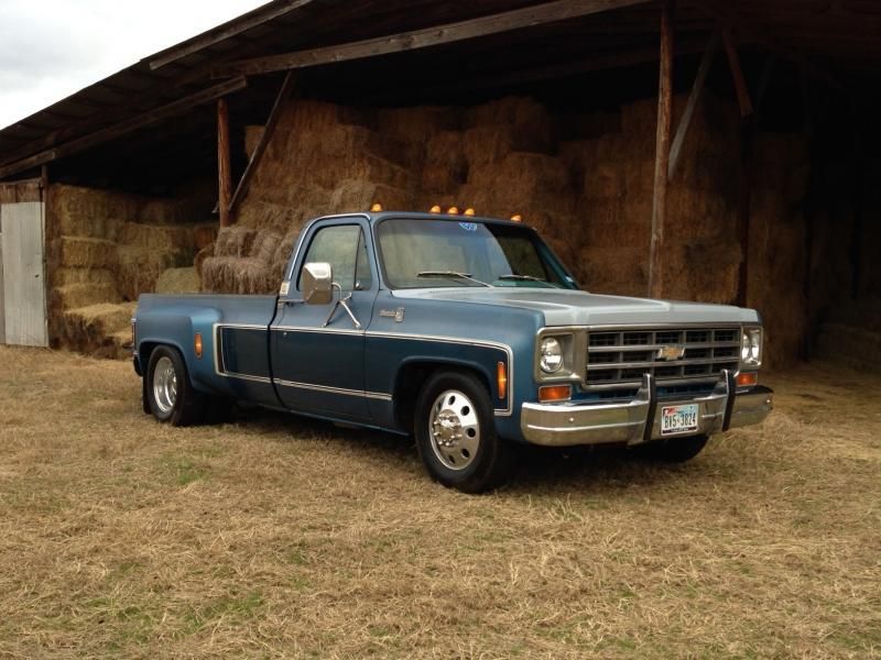

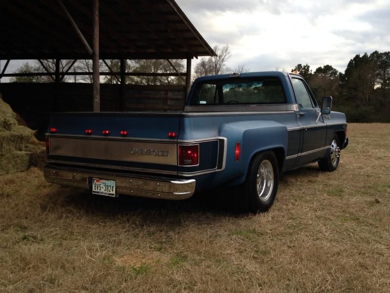

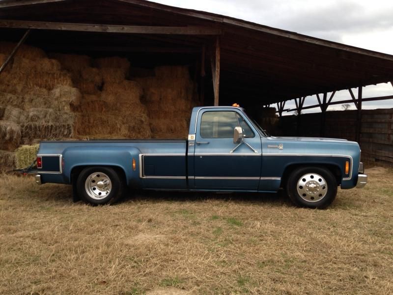

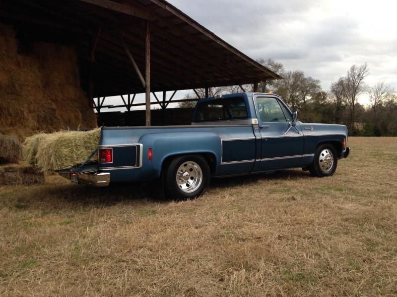

my '79 camper special.
2271 views
no.2steelshot@yahoo.com's avatar
camperspecial's avatar
camperspecial
-A.
chevy-art
That's a beauty.
56pu
Wow great looking truck. What did you do/use as you suspension setup? I really like how it sits.
jcampbell1180's avatar
jcampbell1180
I dig the shit outta that. Right-click and save, my brotha.
camperspecial
Thanks for the kind words guys! I haven't been on here in a while... on the suspension, its 3" drop lower front control arms, 3" drop coil springs, and tubular upper control arms. In the rear I flipped the differential to the top of the spring pack, removed all the over load springs, installed ride techs helper bag system, and notched the frame. I'm happy with the way it all came out, and the quality of the drive/ride. The front end even lined up within factory tolerances.
sadistic636's avatar
sadistic636
Clean and simple. Thumbs up man
