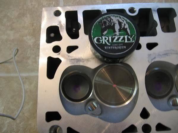

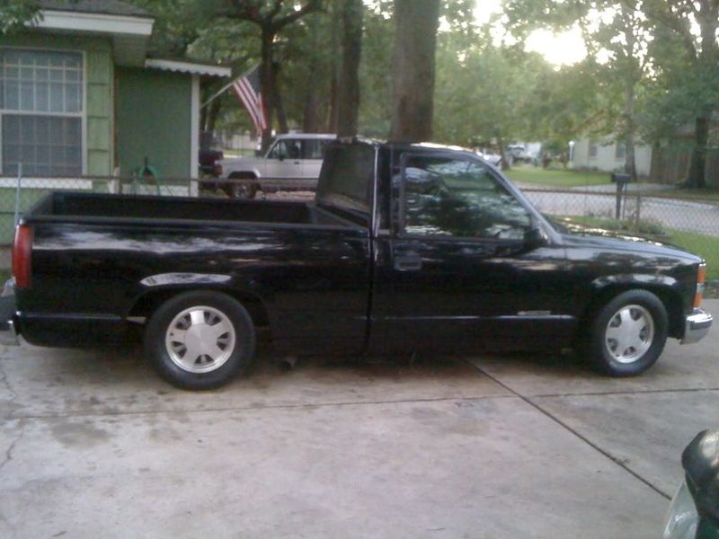

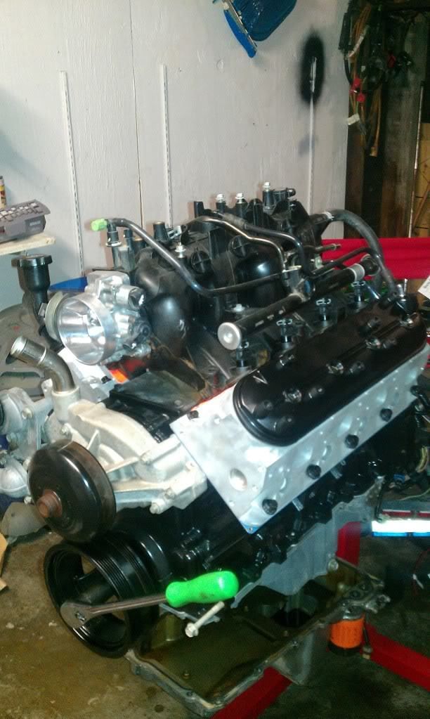

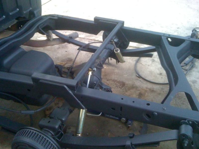

just wanted to show my last truck i built. i have the truck for 6 years i got it from the 2nd owner.. i pulled the old run down poor V6 that had well over 300k with a 5 speed. i built a 5.3 with 243 heads milled down to bring the compression up to 10.8 to 1.. all arp bolts, 595/598 lift 234/236 on a 112lsa, the heads was fully ported pack valve spring, ported TB, long tube headers, 3600 stall full built 4L60E trans, it dyno out to 425 rear wheel HP..

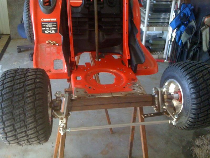

this is my new toy.. 75hp race mower lol that does 90+ mph

Thats freaking sweet....got any close up pics of how the suspension is setup on that thing? I rode a stretched wheeler last year at the track with a gsxr1000 motor on it and it was a handful compared to my Busa...im sure that thing is a blast in the corners
stroker52

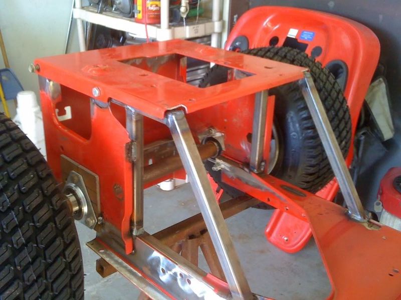

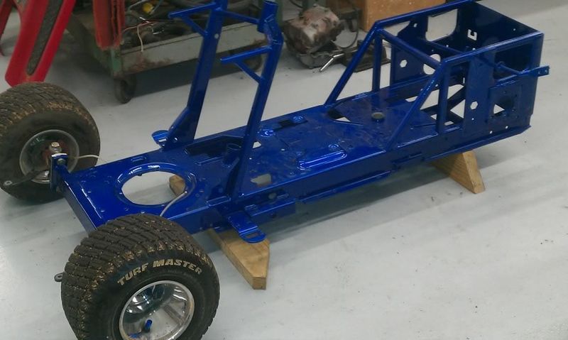

There is no suspension its like a go kart.. the rear is a 1 1/4 chromolly axle the front is fully adjustable I can set caster/camber toe and that how I make it turn.. the left rear lifts going in the turn to take the bite off that wheel.. its a had full driving it I just run 6 laps on that track and had to stop, cuz my hands started hurting trying to hold on lol..
The motor is a lawn mower motor not a motorcycle motor. It started life as a V-twin kohler the heads was CNC machine full ported, stainless valves, 1.6 comp cam roller rockers, roller lifters, roller cam 550 lift, je pistons, billet rods, 8 pound flywheel, but there is more done you get the point lol
