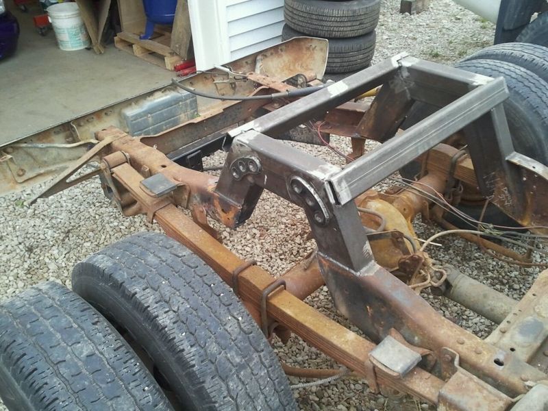

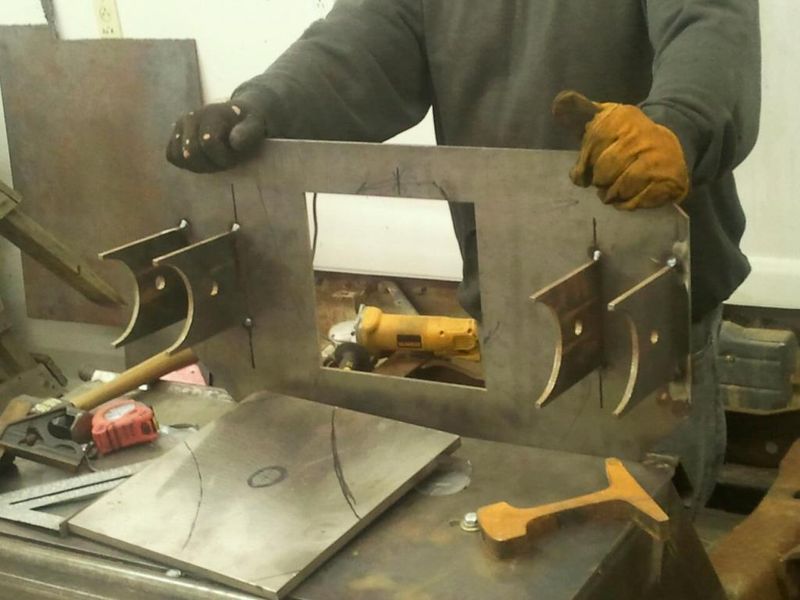

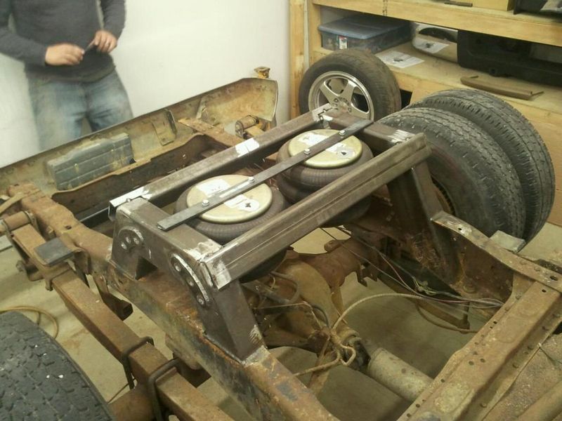

comegetsome....were currently slowly bagging my 85 crewcab dually .. its bag over axle..with coni triple stacks. its been done, just not too often on these squares from what ive read or seen..mainly due to the room ect...i wont lie, its tight and not alot of clearance, but its badass. were setting it up for gooseneck and such. its a beast. its definetly overbuilt lol. were far from done, but ill get few pics up for you. the few others ive seen are, bk2lifes truck..its setup with dump truck bags over axle on his square and ben shadys old square truck is behind the axle but built like a tank.heres a few pics for you. the one pic is of us mocking in the bags...the one pic shows the beast ass lower bag mount with pumpkin clearance cut out..you get the idea.. i have plenty more pics if youd like. this jus a few to give you idea.
BB
big bear
i wanted a slightly diff style look with the bridge bars..we placed them at that angle. it works perfect for setup were doing. they are now fully welded in since this pic and currently making the end caps for them.

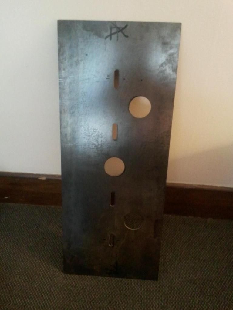

heres pic of upper bag mount we made...once again..stout as fuck...

Yep 4 bags re7 on the bars and re8 over the axle.use more air over te axle when towing..
