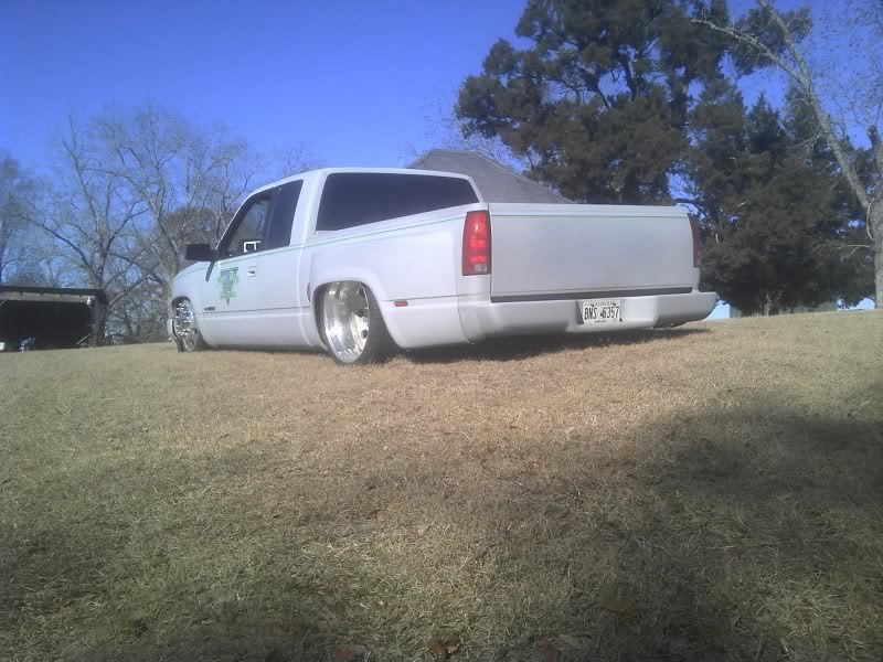

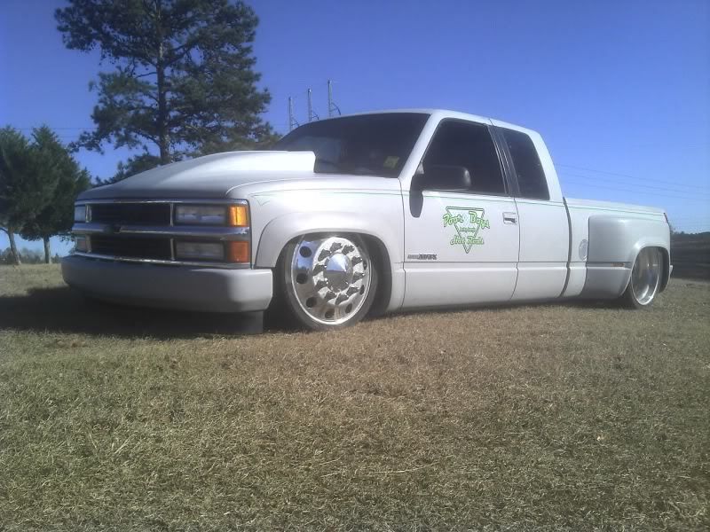

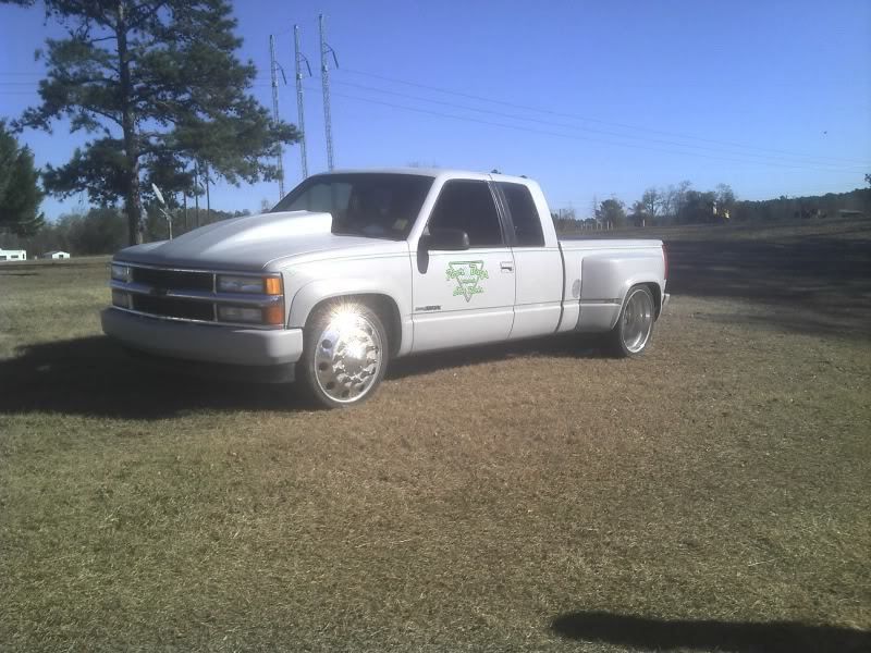

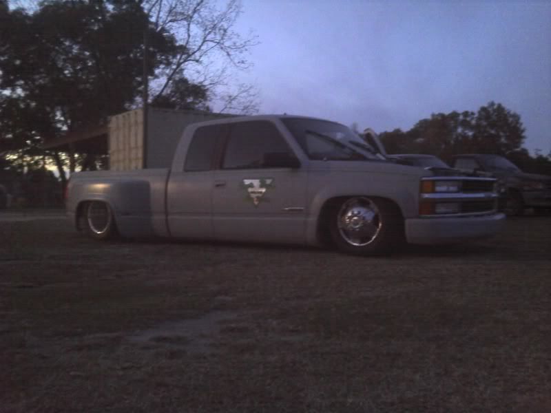

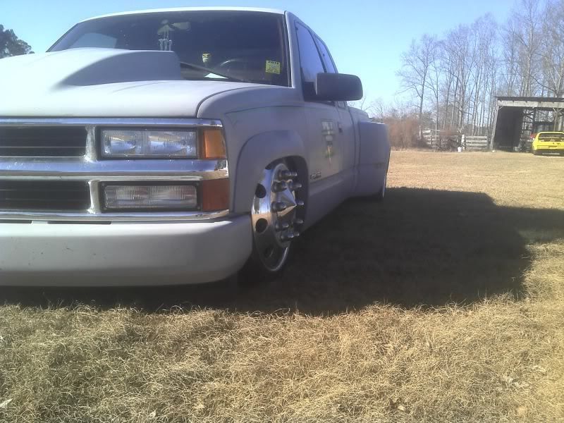

my friend dillion has a dually he has been workin on for a few years and hes finally about got it where he wants it....it started life as a extended cab 94 or 95 model shortbed half ton...so he made himself a dually out of it cause theres no extended cab short beds around here...we helped him bag it a few months back on 16s....looks clean but i been tellin him if he would come to the house we would stick my semis on it and take some pics...so here is a few pics from today...enjoy
right when we finished bagging it
donked up
and laid out
and my dually on 16s....i made a real sad face at the sight of this...so glad i bought semi wheels first lol
mintcrew

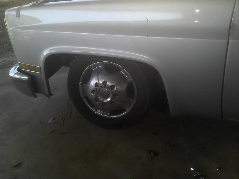

kewl truck man.. are those factory width rear fenders??? how are those rear wheels tuckin???
comegetsome's avatar
comegetsome
yeah they are factory width...his rear end is a SRW rear and he added 2 inch spacers with the dual 16s to space them back out...and im pretty sure he had to have the spacers to clear the SRW brakes but forgot to ask him...but we pulled the spacers off and my inner rim and mounted them up to take pics

I like it, it looks mean

Looks sweet

That actually looks good, I like it. The crew cab short beds look out of proportion in my opinion.

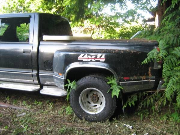

Looking at building the same right now, gathering parts.. 98-99 CC Duallys had a shortbed option.. fenders are 2" shorter than the 8' bed fenders.. just bought this one..
