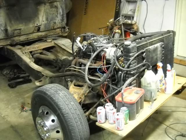

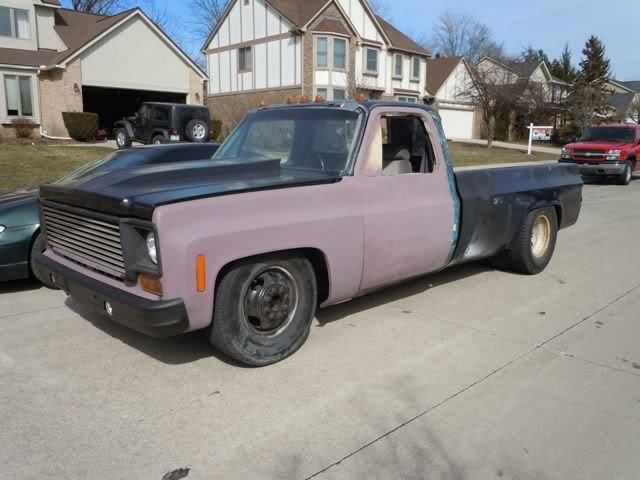

Well i finally have the truck lowered and sittin how i want it, i still have a lot of body work and the interior work to do but heres some pics of the progress, I took a 86 chassis cab truck and put a 78 body on it.

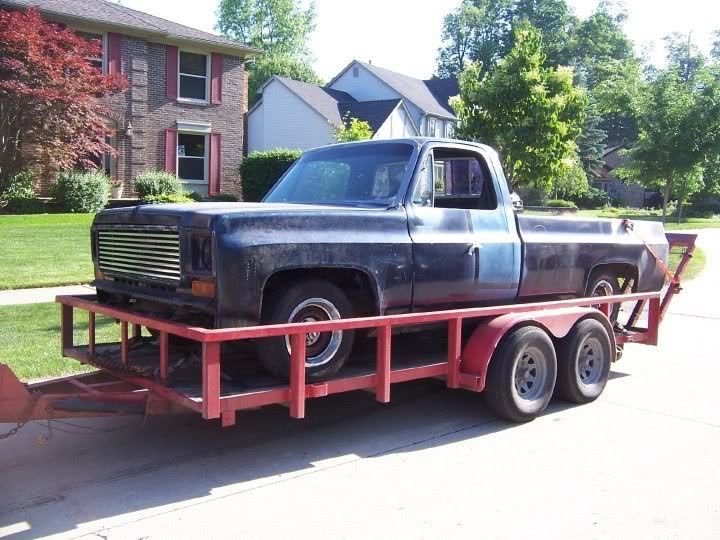

1978 c10 rollin chassis i picked up for $250

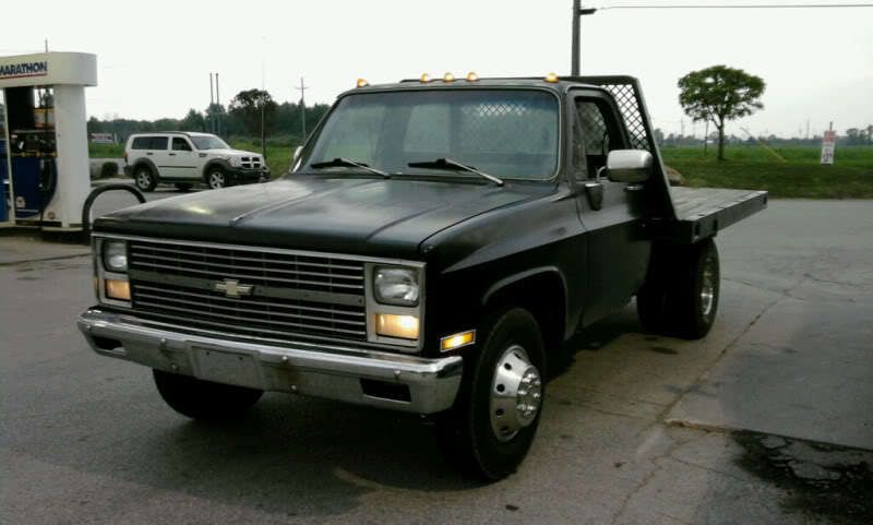

The Chassis/cab donar truck

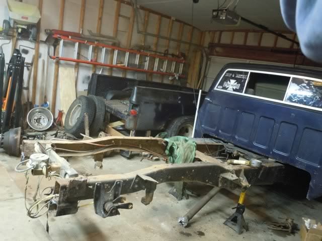

Removing the rotted out cab

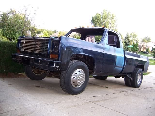

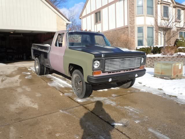

Body swapped

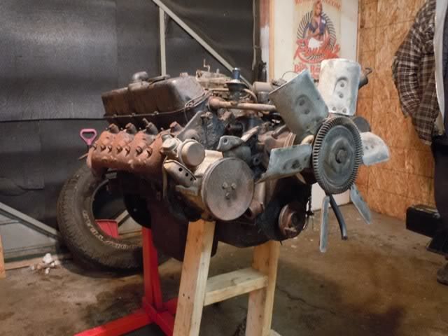

472 cadillac engine thats goin in after a rebuild and few things added to it

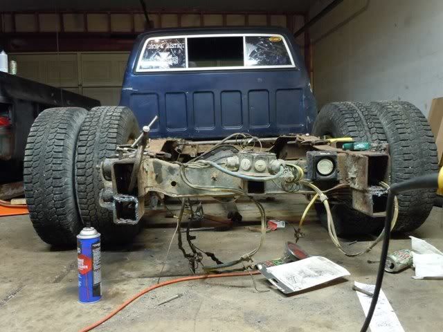

Rear end out

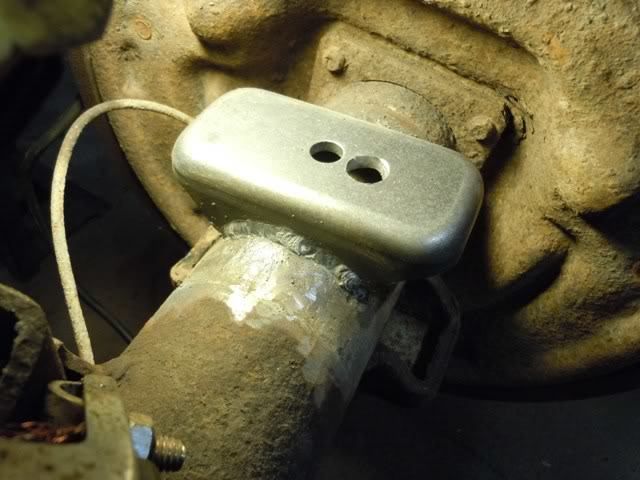

New Spring perches

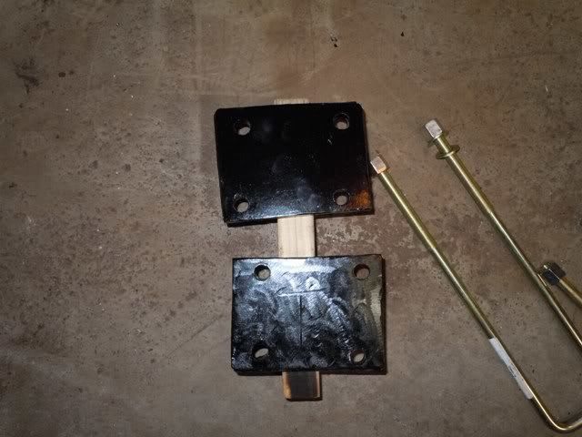

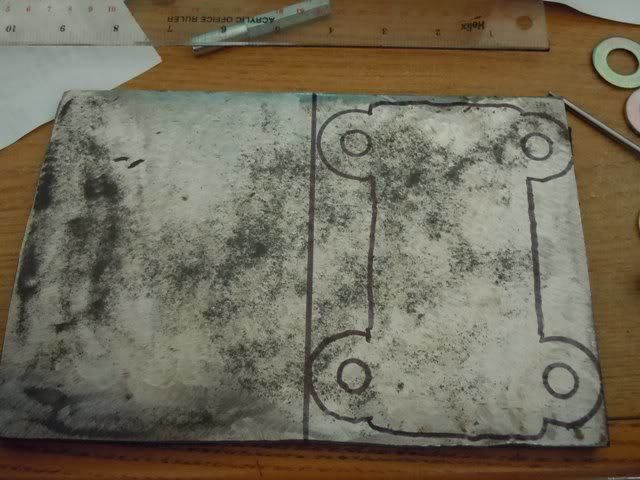

Made my u-bolt plates out of these plates and doubled them up, couldn't use a standard flip kit because of clearance issues with the cc rear axle
Plates done

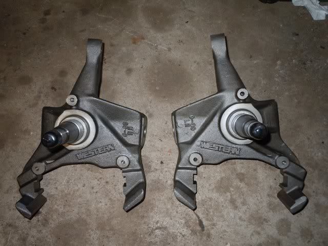

Western Chassis 3in drop spindles
On with all new balljoints

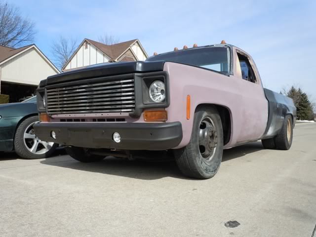

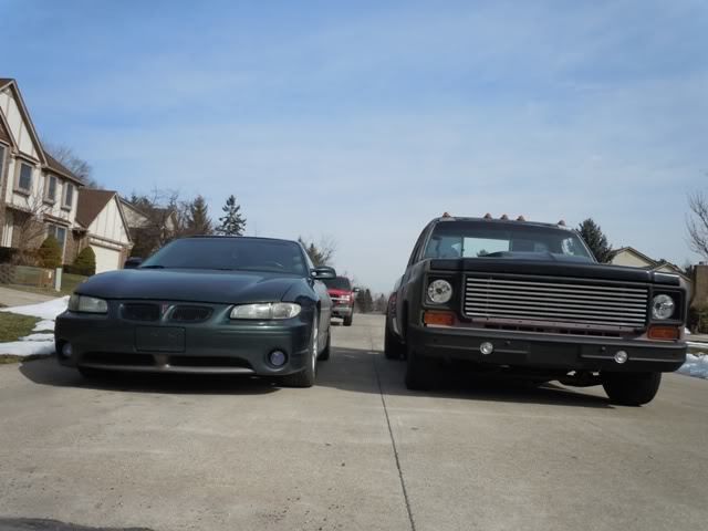

And heres how she sits today
To get the bed to fit over the wheels i had to cut the inner fenders out and a little of the bed floor, then i rolled the lip on the fenders and used threaded steel rod through the factory fender holes to push out the fenders enough to clear the tires, i can get some more pics of it tomorrow i just realized i forgot to take pictures of that lol
