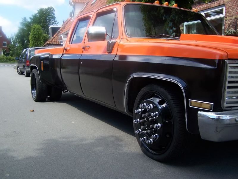

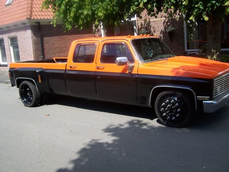

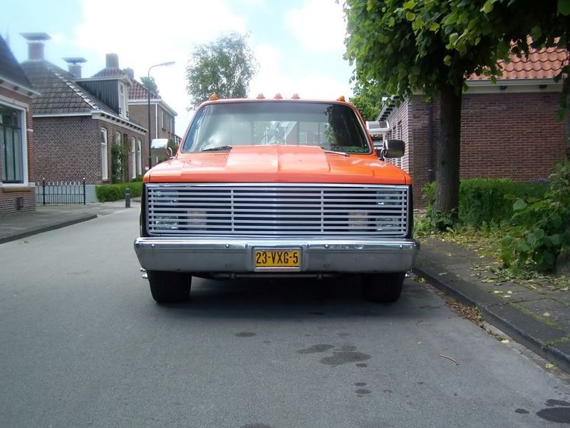

at last my new wheels are on it

see the photo's

What tire size and what drop is that?
dually-79 avatar
dually-79
Tire size is 265/35/22
and the drop i don't know in the front but in the back i got lowering schackles.
At first the wheels in the back came out of the fenders for 2" that was to much.
But now i have turned the adapters around en they are now on the outside.

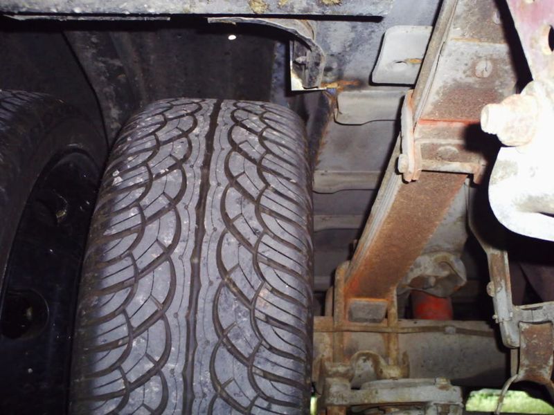

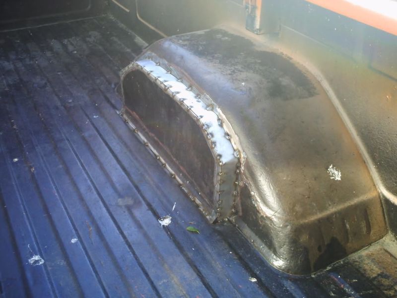

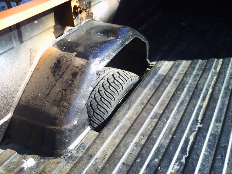

I think I understand what you mean. Are you able to run nut covers or center caps in the rear? Can you post some pics of what you did?

here are some pics.
i have welded little stainless bolts on the back of the wheel bolts and drilled a little hole in the lug cover
