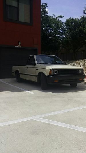

so the truck shifts and drives well. My only concern is that when its in gear and I let off the gas it makes kind of a scraping noise. Like "chink! chink! chink!" I'm new to the forum and this is my first Bseries looking forward to tinkering with this little guy. I'm not really a mechanic but I'm mechanically inclined. Any advice helps! Thanks
