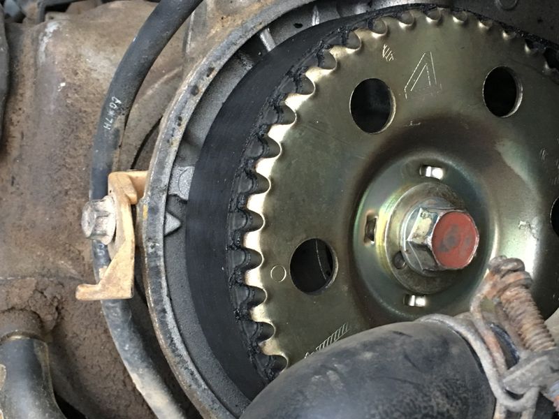

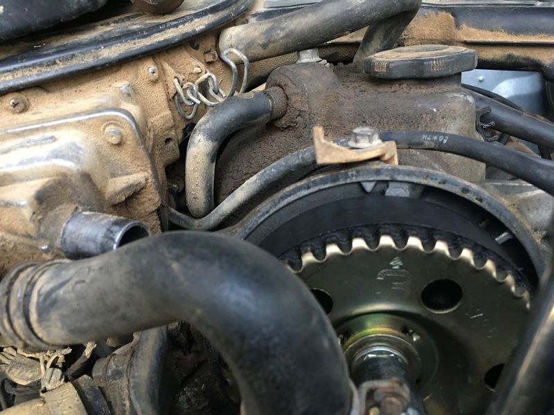

What I have done. Replace spark plugs, plug wires, coil, distributor cap and rotary button. Checked the timing belt all is good there.

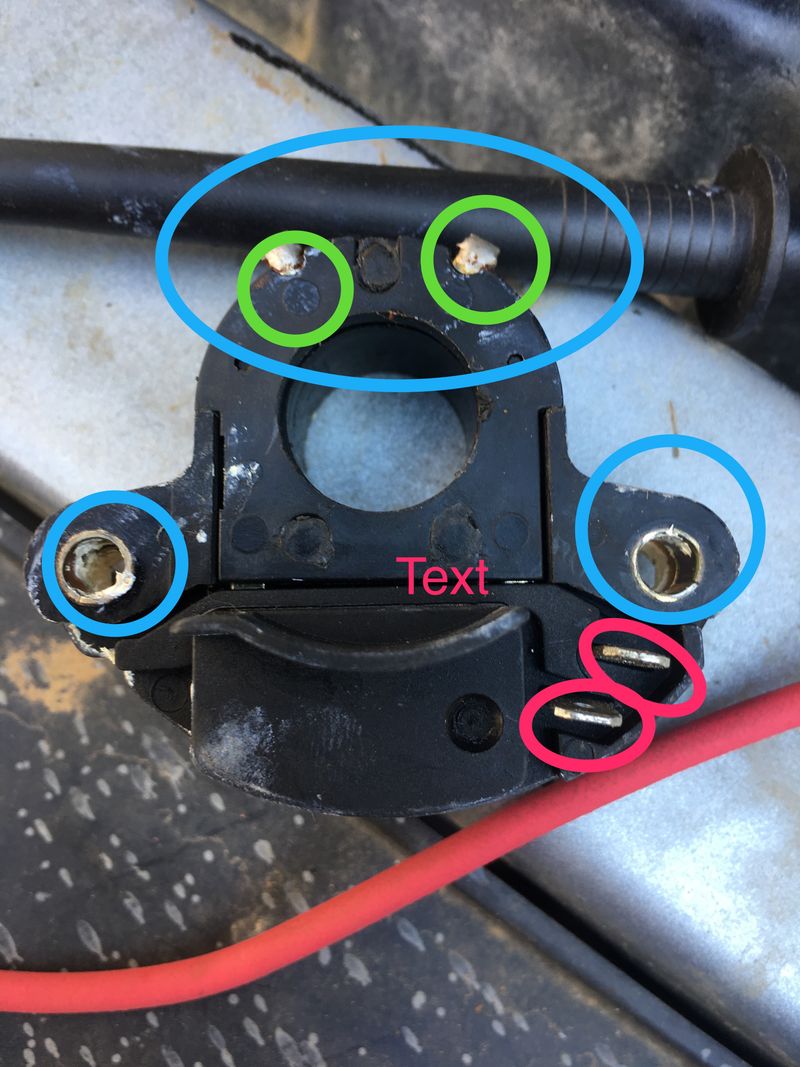

I pulled the Infiniti on control module out and checked it the best I could with a multie meter.
I have 12 volts to the two male plugs with ingnition switch on engine off.
I uploaded a photos
Red is 12 volts
Green only has 1 volt
I checked to see it the circuits where grounded (together some where) after I pulled the icm
The bottom male blade plug is not together with anything so I'm asumming that's incoming power?
The top male blade plug is together with everything circled in blue.
I'm assuming the ice is bad? Am I correct it's assuming that?

Seems like you are fixated on replacing a lot of expensive parts with the hope that that alone will somehow get you past this non-starting issue. That is the "throw money at it" repair method. What have you invested already . . . plugs, a coil, wires, a cap, and a rotor and lots of time that hasn't given any results. What I suggested is do a compression test and because you couldn't do that it somehow must be ok. That test doesn't cost you any money. If you replace the ignition control module (more money) and it doesn't fix the problem you will be in it for more money and you will still need to do a compression test to rule out low compression. There are a lot of auto parts store that can test modules, but because you are getting spark I don't think that is your issue. The way ignition control modules work is they are grounded through the mounting base and they ground the coil when they are in phase with the iron reluctor that rotates on the distributor shaft.
