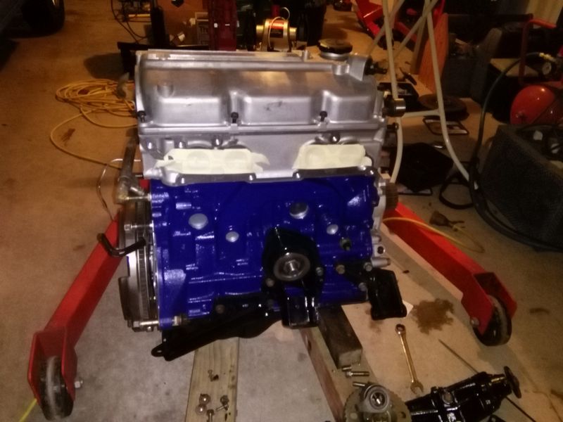

Just purchased my Mazda Cab+ 1988 B2000 8V 5 speed manual. It only had 178Ks, but previous owner cooked the motor. In need of a rebuild. The bottom hasn't been opened yet, but on the surface looks OK, but the head has been destroyed - burnt the ali away from No2 plug hole and undermined the exhaust valve seat.
My aim is to rebuild with the aim of getting a bit more out of the motor using some basic mods - increase compression ratio, cam timing and lift changes, webber carb and extractor, electronic distributor.

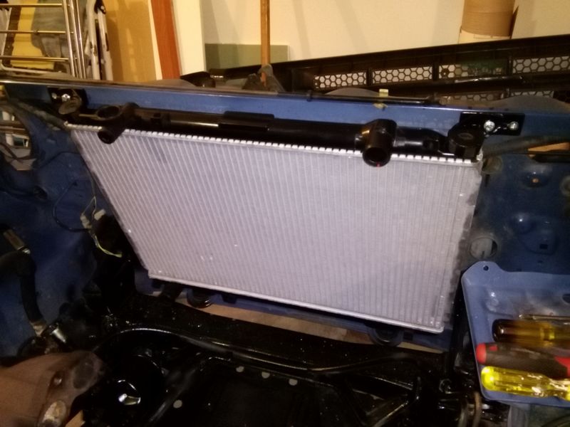

Twin core radiator installed. Motor nearly ready to lift in.

What's the radiator for? It's not a B radiator.

Radiator is for cooling :) (Silly question) The original standard radiators were a single core and side mounted directly to the front fascia panel.
The new one was bought on line and was supposed to be for the b2000. It has twin core so will provide better cooling.
When I opened the box I found it had different mountings, hence the change to the rubber mounts. The inlet and outlet pipe positions are close enough to the original to not be a problem. I had to offset the radiator from centre to match up the pipe positions on the motor so I can still use the standard hoses.
Possibly looking at mounting an electric fan and shroud to match.

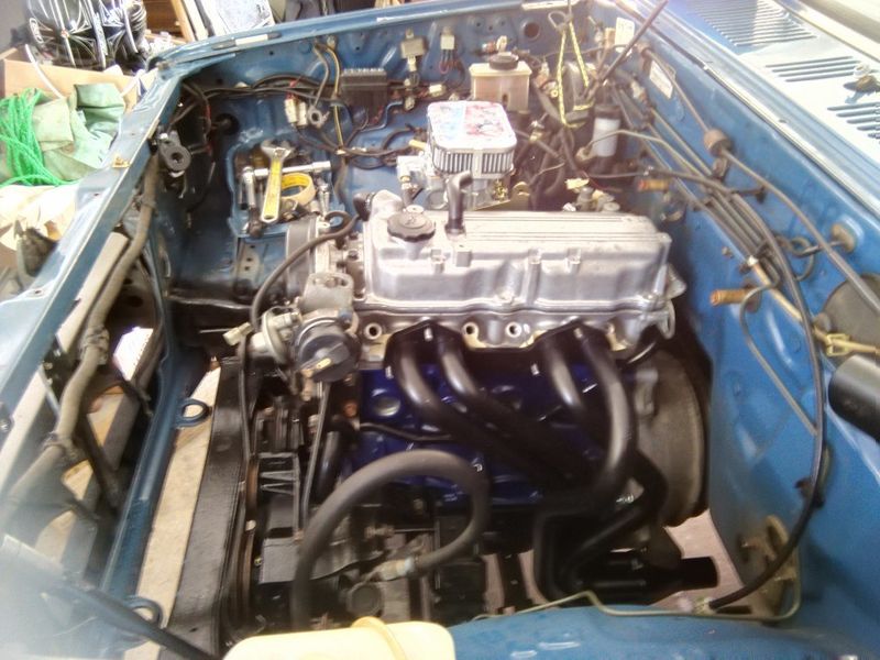

Motor in the hole, a few more bolts to put in, exhaust extractor to bolt up, electrical wiring to connect, and fuel lines, plus refit new radiator.

Motor fired up. A bit of tweeking on the ignition and sounding sweet. Had the flywheel skimmed, and fitted new clutch and pressure plate, but looks like I have an issue with either pedal settings, air in hydraulics, or I stuffed up the clutch install. Been working on electrics at moment so will get back to that issue soon. Any good tips would help.
