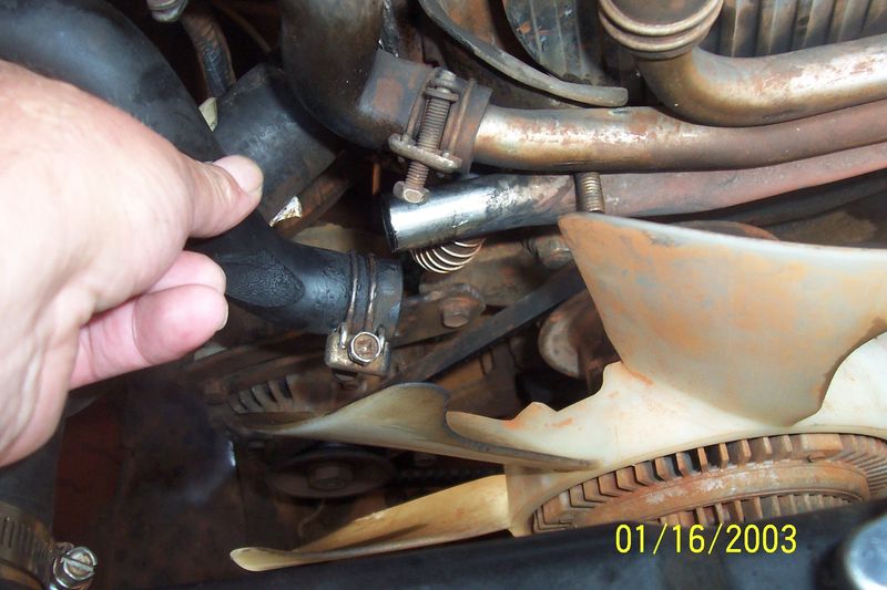

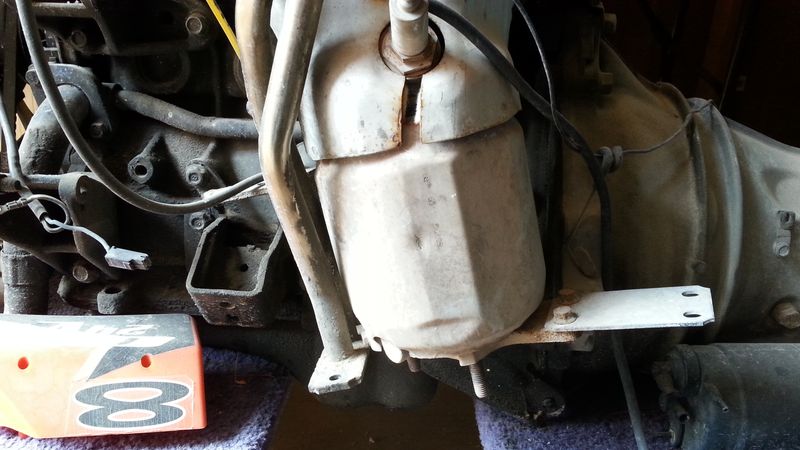

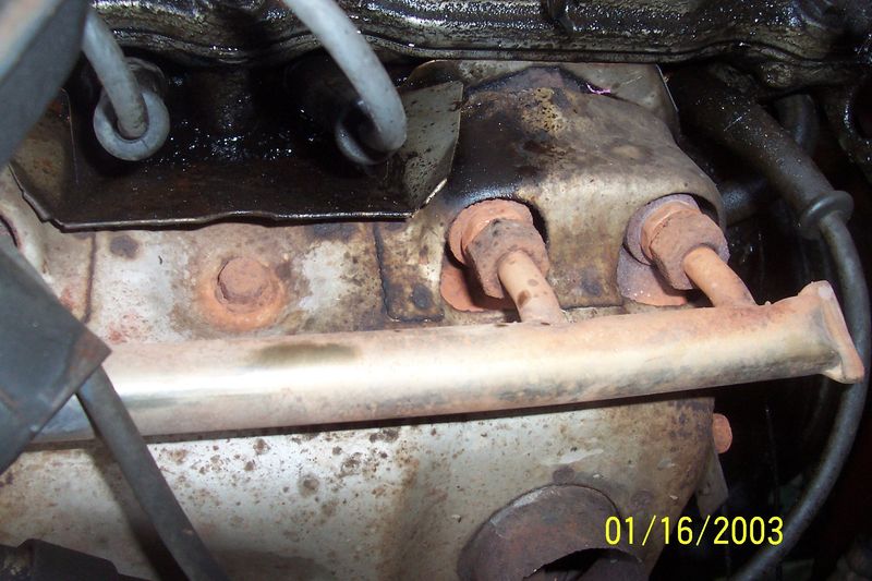

I have been trying to get my '91 B2200 pickup running so I can at least drive it. It only needs to get me til October, then I get another vehicle. It has always blown white smoke for the first few minutes after I start it then stops smoking. (I have had it for a year and a half). When I give it gas it bogs down like a vacuum problem, but don't see any vacuum lines disconnected. I can't get it past 2000rpms. (if you look at the attached photos) When I give it gas and try to get it past 2000rpm back pressure builds up and blows the hose that goes into the air cleaner cover off the nipple. that is the hose you see in my hand in the center photo.That hose goes into the metal pipe in the end photo on the right that goes back into the engine or manifold under the spark plugs. When the hose blows off the engine will rev up but make a loud sucking sound. It was suggested to punch out the Catalytic converters that they might be clogged. I did the one right before the muffler that didn't help I have heard there is another one, where is it? and is this really my problem? This is my only vehicle, and being on SS disability I can't afford to take it to a repair shop. Any help would be tremendously appreciated. Thank you all for your responses so far.

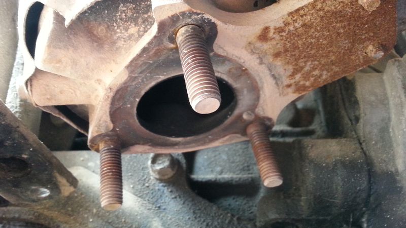

The other one is bolted to the bottom of the exhaust manifold. To the untrained eye, it looks like part of the manifold. Just drop the exhaust pipe and do the same as the first. Once you open that one up, you won't have anymore back pressure issues.

are the gaskets that important? the first converter I took off didn't seem to have a gasket or it had disintegrated with time. still working on getting the 2nd one off.
