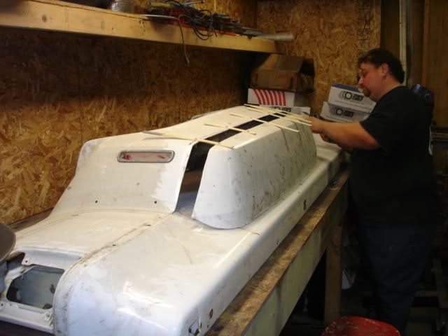

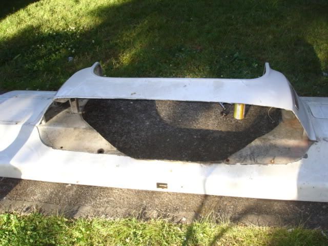

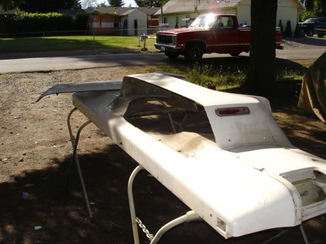

looky what ive been up to

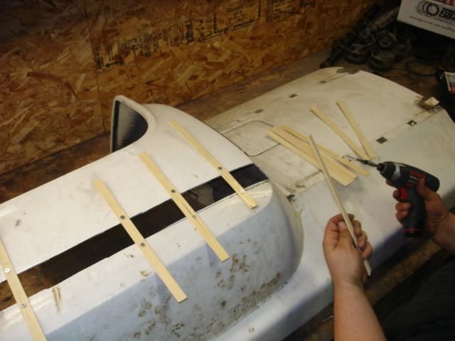

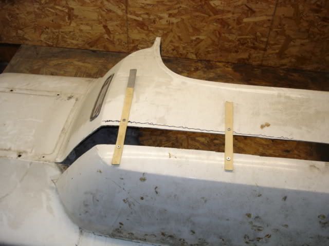

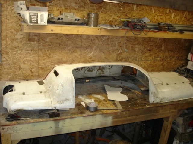

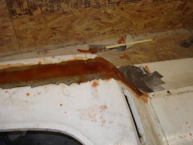

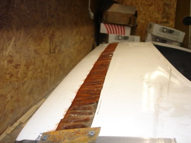

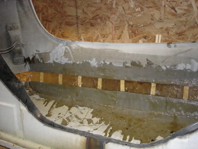

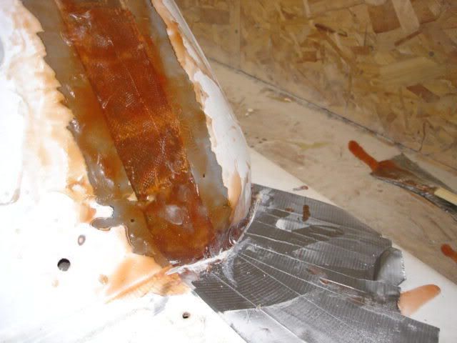

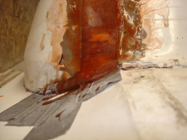

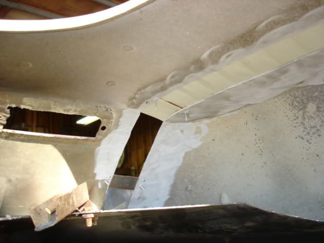

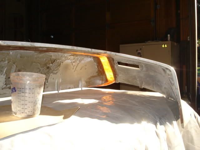

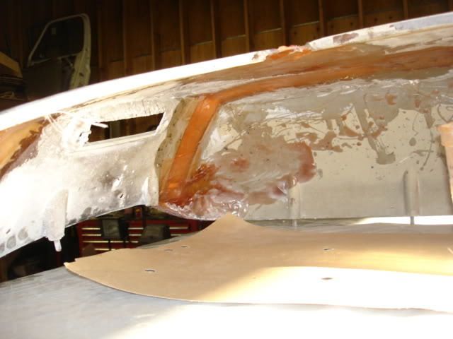

looking and learning ....... that ducttape seems to work whell , did you had a lot of trouble getting it off again after the resin sets ?
erock805's avatar
erock805
cool man...
skidrow

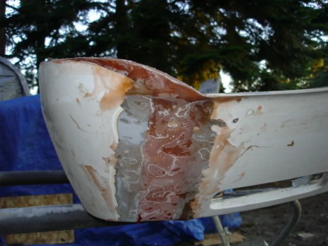

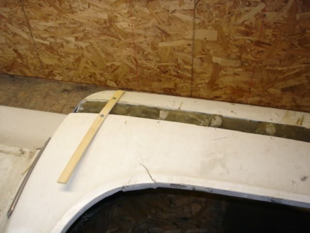

nope it cam right off but i dont think ill use it agin need to have somthing more solid
to hould the from of the fender
the 1st one with paint sticks is slopyer but it turned out nicer as in the flow of the fender
the duck tape left a huge low spot for me im going to redo it

a roll of roofing tin works awesome
