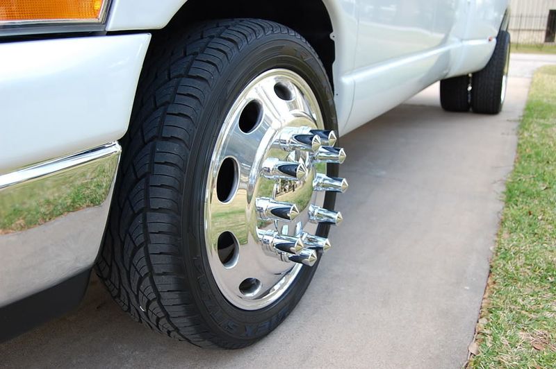

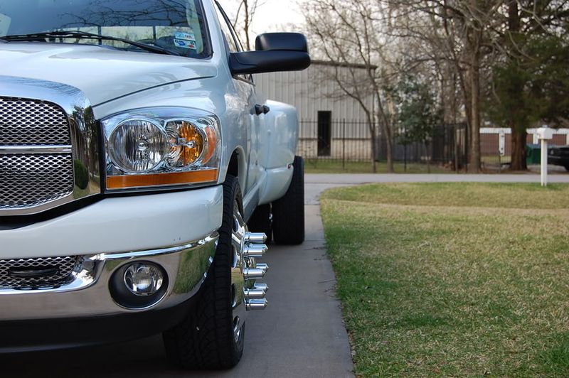

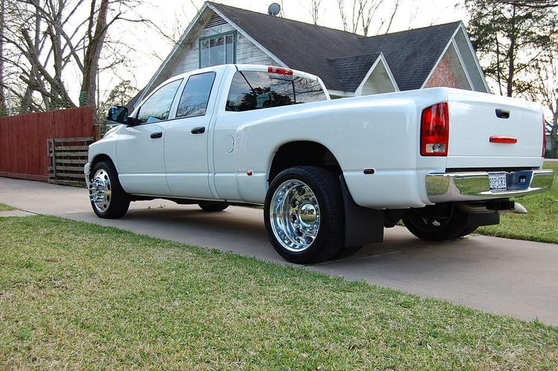

I've got Pete wheels on now. Here are a few pictures. All 6 22's on 285/45/22 Falken S/TZ Ziex 04 tires. This is the Gulf Coast Speed outer rear wheel, but to use a tire larger than a 265/40/22 a spacer is needed between the dual rear tires. A 1.00" spacer is used here. A 0.75" spacer could also be used. The GCS outer wheel places it closer to the inside wheel and tire.

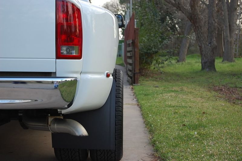

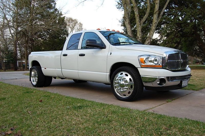

A few more pictures. Note the decreased wheel stick out when using the GCS outer rear wheels. Remember this is with a 1" spacer. If you want to run a 265/40/22 or 265/35/22, this spacer is not needed. The stick-out would be 1" less than what you see below.
