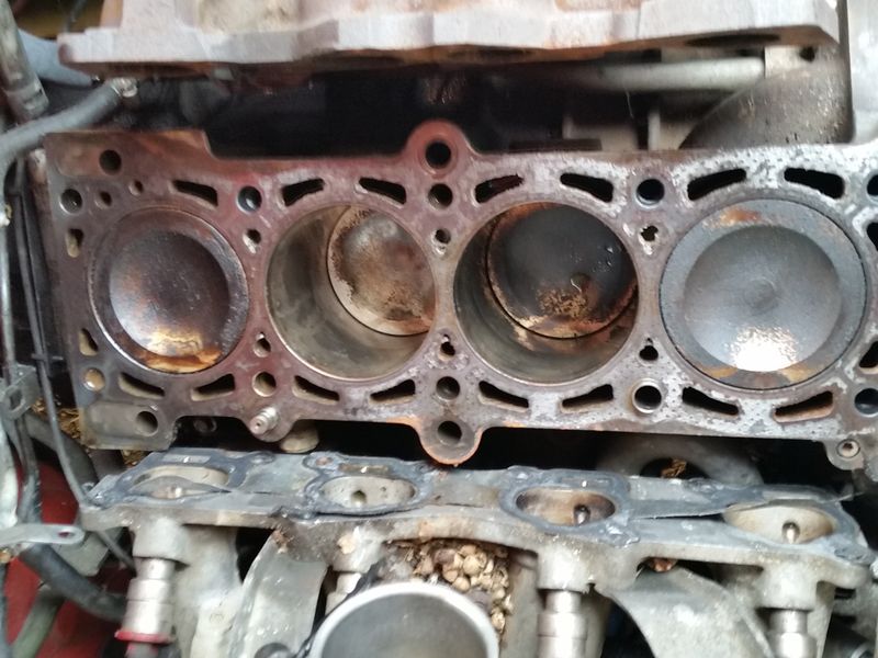

I bought my B2600i last fall for a good price as it had cylinder head water issues, blowing steam-smoke in exhaust,
I love these trucks as they're easy to work on relatively, practical and affordable.
I verified this truck has 57,000 miles with carfax, and based on all the condition of everything I'm sure its legit.
So last week I took the head off finally with much of my sons help. We've sent the head to the machine shop for pressure testing, warp test and resurfacing if needed.
My main question is when I drained the oil from the pan there was about 1-2 quarts of coolant that came out first.
Someone told me I should remove the timing chain cover ( and of course that means oil pan comes off). They said I need to make sure there isnt a leak from the timing chain area into the lower end. he said apparently the chain can lash and damage enough to cause a water leak.
The chain is in great condition and I dont want to take more off than needed. Anyone have any wisdom on this?
Could the coolant have gotten into the lower end another way?
with the head off the coolant chambers seen from above on the block all look to be holding coolant still.
Thanks!

Thanks all! I did a compression check before taking the head off and 3 of 4 cylinders were about 140 lbs and # 3 cly was about 110.

Gidday, yes well done on doing those compression tests, they agree with your photo; the #3 cylinder is stuffed and has big droplet of water sitting in it. So it may have done its head gasket? or the head is warped somehow? Will be interesting to hear what the machine shop guys say.
