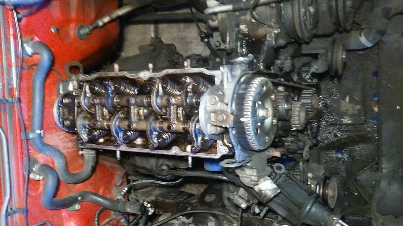

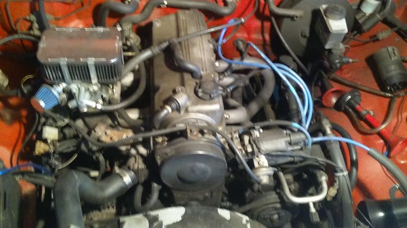

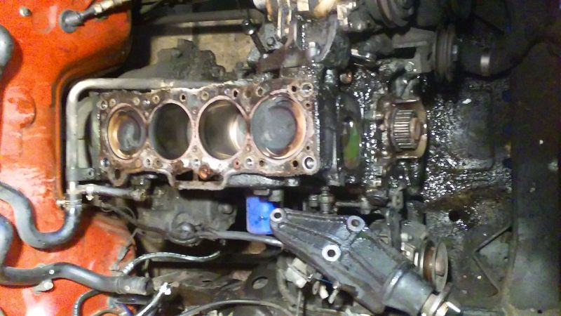

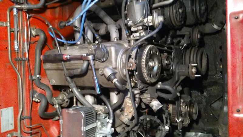

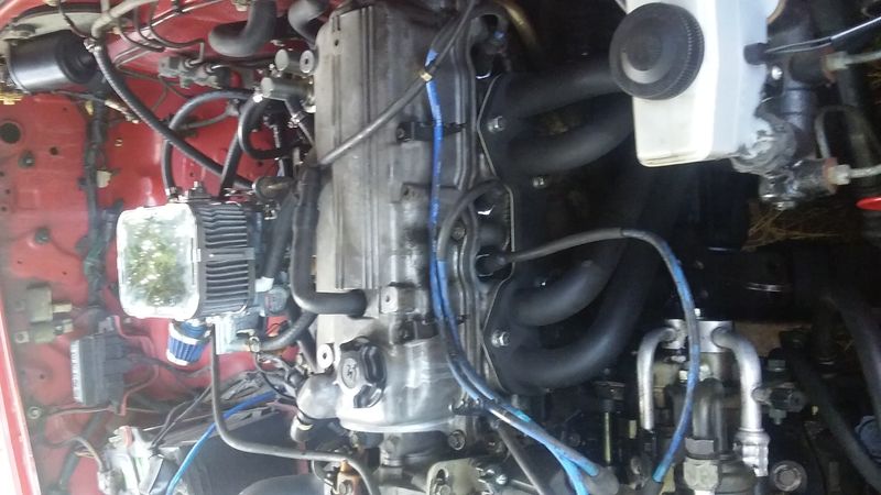

So it has come to be the time to replace the headgasket in my 86 b2000. Have had a small oil leak from the head under the distributor for some time now. It just started leaking coolant also, so im throwing in the towel and doing the swap. All of my parts came in so I started on it today. I got the head off and started cleaning everything up to put it back together. Im also changing the waterpump, timing belt and tensioner while im in there. Some pics to follow and ill be taking more tomorrow as i clean it up and reassemble.
mazdaB-lazer420
Pics
mazdaB-lazer420
more photos
mazdaB-lazer420
I cleaned the head up today to find that it was warped. Had well over the .006" service limit. Im ordering a complete new head. Found one for 375$ complete from valves to rocker arm assembly. Hopefully ill have it by the middle of next week. Ill take the time to nitpick and clean the rest of the block before it gets here.
