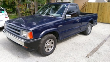

Hello everyone, new here.
My 1990 B2200 decided to quit while I was driving and now it won't start. A bit of background, before it all out quit starting I had two other instances where it quit while I was driving, but started right back up after a few minutes of sitting there. Couldn't visually see anything wrong, but when I tried to crank it went ahead and started.
That last time it quit I thought I was out of fuel and the fuel gauge was broken or something, but added fuel and no dice. I replaced the fuel pump and fuel filter, and right after that it turned on for about 30 seconds and then it it shut off and was back to nothing. I replaced the spark plugs and wires since they were old anyway and still nothing. Distributor rotor and cap are good and about 6 months old. Battery is good. I even replaced the ignition switch since it seems to be one of the common items that go bad about this age.
Ideas and suggestions would be much appreciated.
