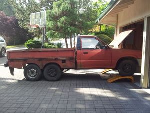

I'm new to the scene and have a unique 1986 B2000. Six wheels and a dump bed!! Working on it with my son as it will be his first car when he gets his license. Ran very poorly with the Nikki car, so swapped out with a Weber. It is running great! Yeah! We removed quite a lot from the vacuum system and plugged things. However, there were 3 pipes connected to the old air filter (secondary air, I think) and head down to the exhaust system. Can I remove these? And what is the best way to do it? If you have any other advice on what I can clean up after getting rid of the craziness that was this OEM setup, would love to hear it.
