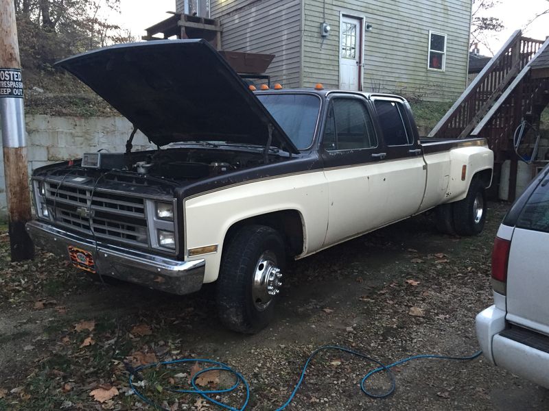

Gradually getting parts rounded up to the get the freshly rebuilt big block in and get this big ol girl on the ground.. Can't wait to get it on the road

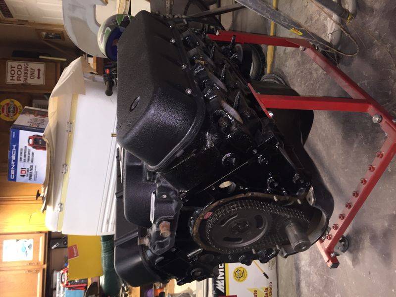

Here's the freshly rebuilt 454 that's .30 over with a forged rotating assembly and a .680 lunati cam.

What are the duration numbers @ .050" for that cam you installed? Roller?
FrostDesigns's avatar
FrostDesigns
Correction* .554 lift at valve, duration at .050" is 227 in. 233 ex.
FrostDesigns
It's hydraulic
Old as Dirt's avatar
Old as Dirt
That will be a good mild cam for your truck.. and still have a better sounding idle.. just got my boat running in Sept. 496BBC with a Comp Solid roller.. 271/282 duration @ .050.. sounds killer! here is a link to youtube after getting the timing set.. http://www.youtube.com/watch?v=K7t--R8pUPM

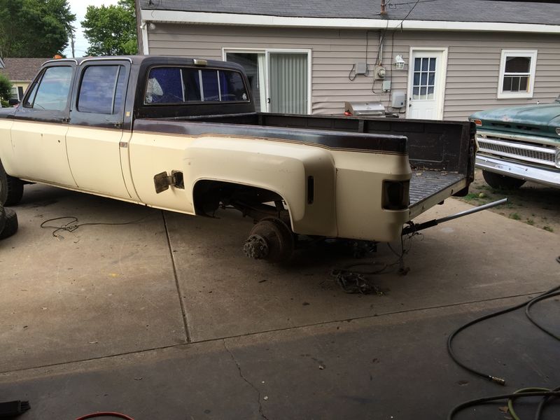

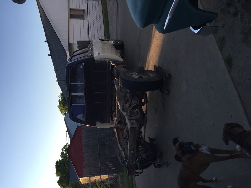

Some progress on the C30.. Waiting on parts and sandblasting at the moment..
