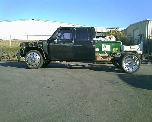

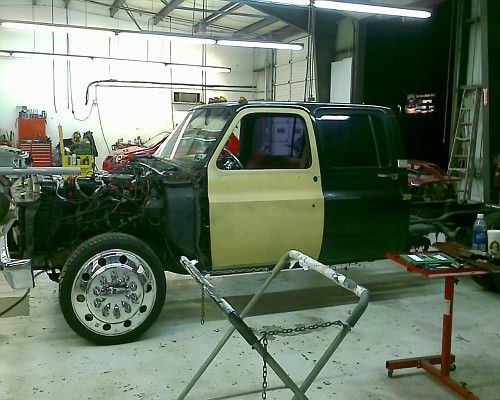

Well I got the bed off finally.. I hate the design of the bed bolts on square bodies by the way.... Anyone know where I can but a new set? I had to cut a few of them off.. So anyway here's a pi.. I got the headers installed tonight and I get my exhaust on it tomorrow...

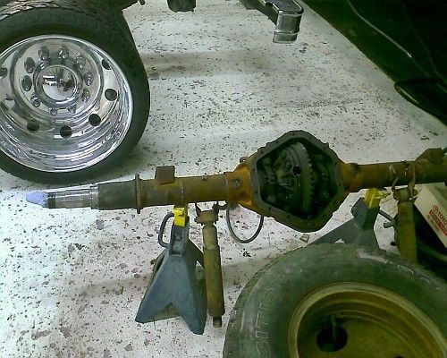

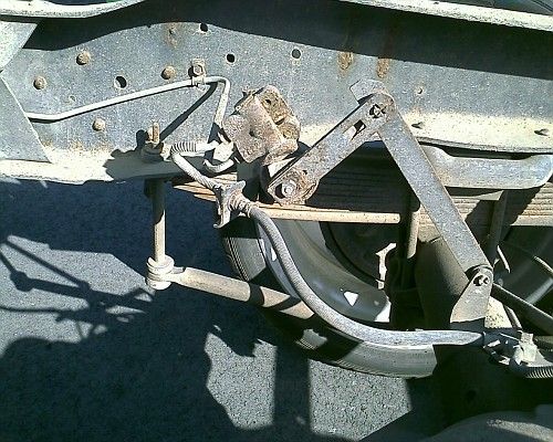

And what is this? Anyone know?

looks good
lil to much gapage bag it

its something to do with the anti brakes the way it looks like it works is if the rear rolles to much it releases pressure so the rear doesn't lock up
shit can it

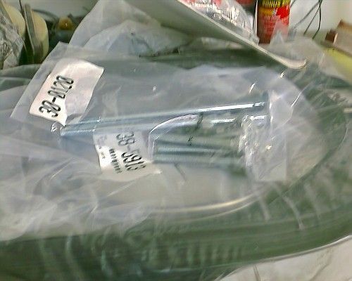

just run down to your local box store and get some carriage bolts and use nylocs and neverseiz so you can get them off if you want and

I had to do the same when I took my bed off a couple weeks ago, pain in the dick!

That thing is actually a proportion valve for the brakes. It probably doesn't have antilock. That thing changes how much front/rear bias you got dependent on the load you are carrying. It is attached to the rear suspension isn't it?

ben_shady1
Yeah it goes from the rearend to the frame. so you think I can bypass it?
huskerdually
Ya I think you can just take it out. You can try just hooking the flex line into the metal line. But you made need an adjustable valve to get it set right.

Yeah, just take it off and hook the metal line on the frame directly to the rubber flex line. Glad to see the progress!
