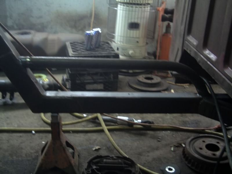

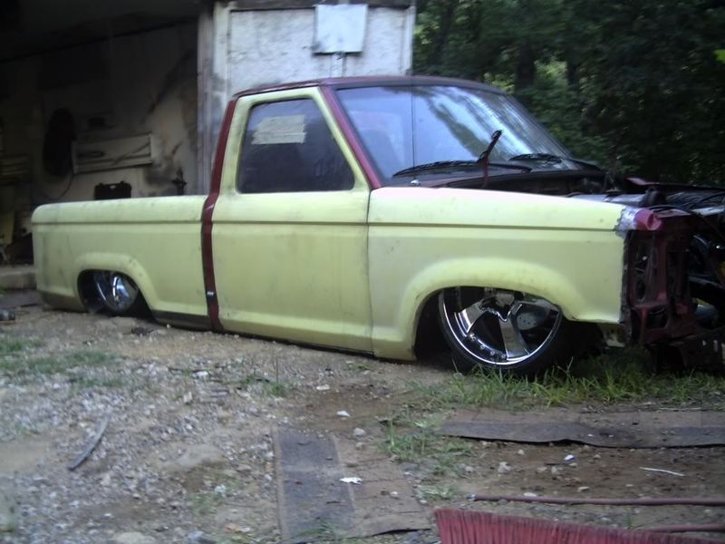

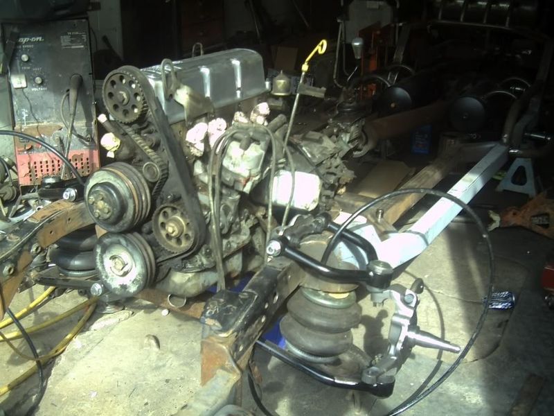

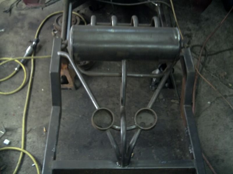

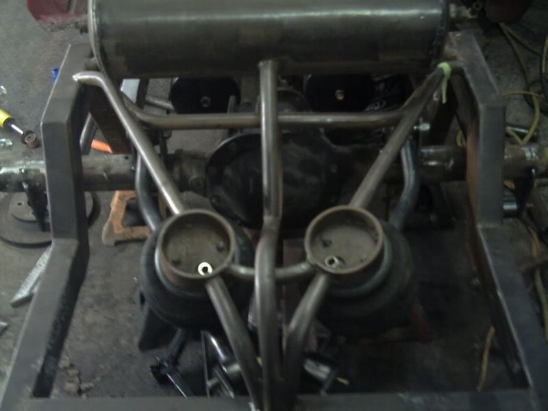

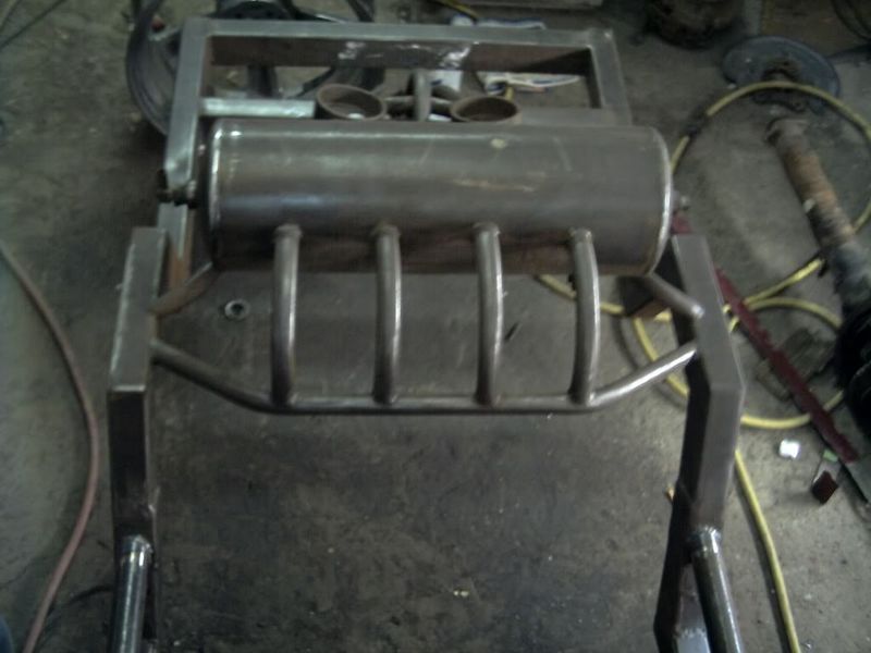

this is my 1990 ford ranger ive been building for the past 4 years on a low budget.its full tube chassis with 2x3 box tubing with about 100ft of bent round tubing throughout the frame. its got mustang 2 upper and lower tubular control arms with 2in drop spindles 11.5 in drilled and slotted brakes. the rear axle has been narrowed 3in and centered. it has 95 mustang disc brakes on it with 12in slotted and drilled rotors. suicide doors custom bent 4 link.its been stock floored 3in and cut floor 3 with 2.5in sectioned out of the rockers fenders and bedsides and its fully shaved. im running a 86 turbo coupe engine thats gonna be mostly stock with a few upgrades.
