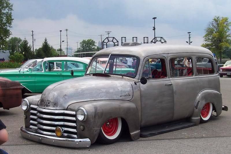

'53 GMC Suburban. Ex- U.S. Army vehicle bought new by the Army then used by the Colorado Forestry Service. Has a chevy hood and grill. MII with drop spindles, tubular a-arms, with c/m raised up into the frame. NoLimit Engineering "FatBar" 4-link with a 7" notch.
2-tanks
2-viair 400C comp.
8-SMC valves
4 switch control
2-dual needle KP comp. gauges, and a tank pressure gauge
