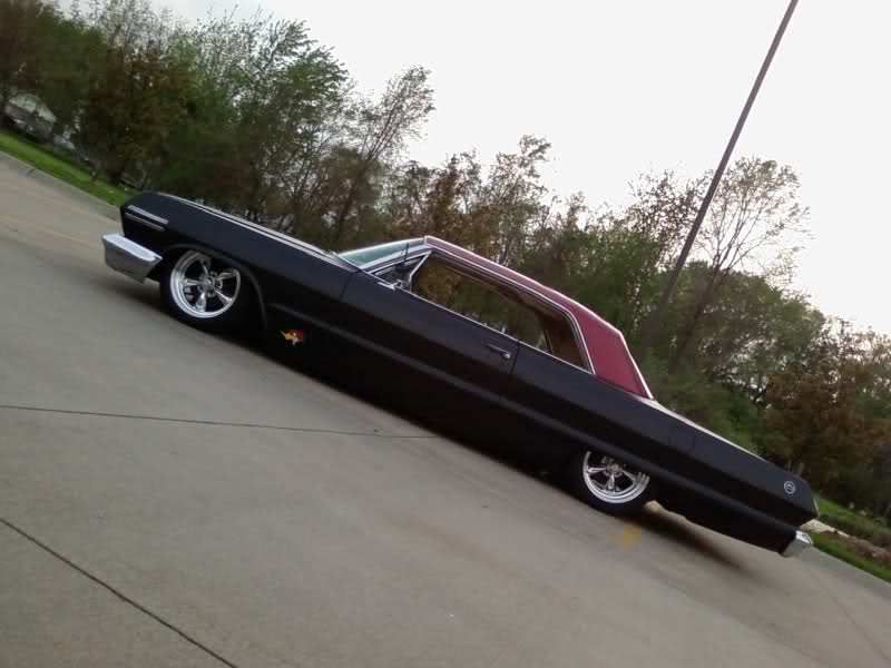

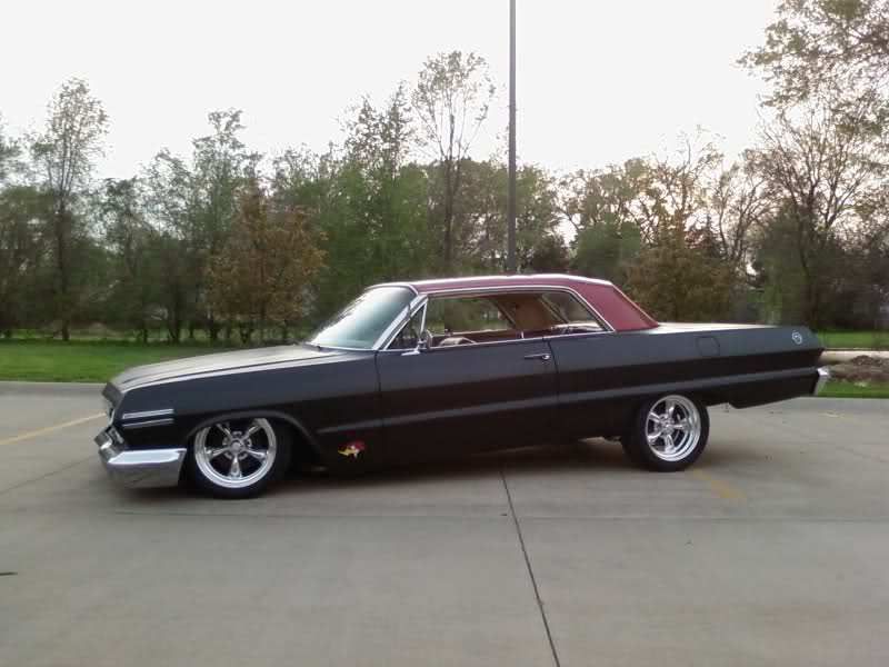

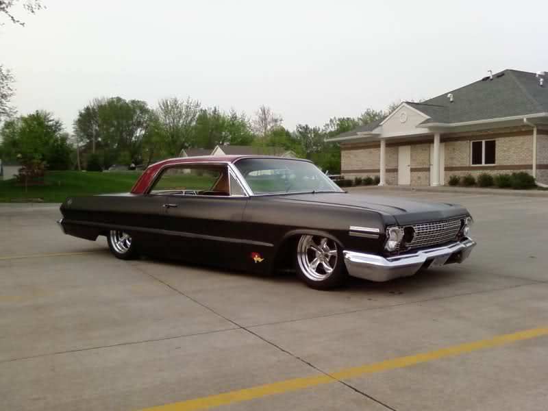

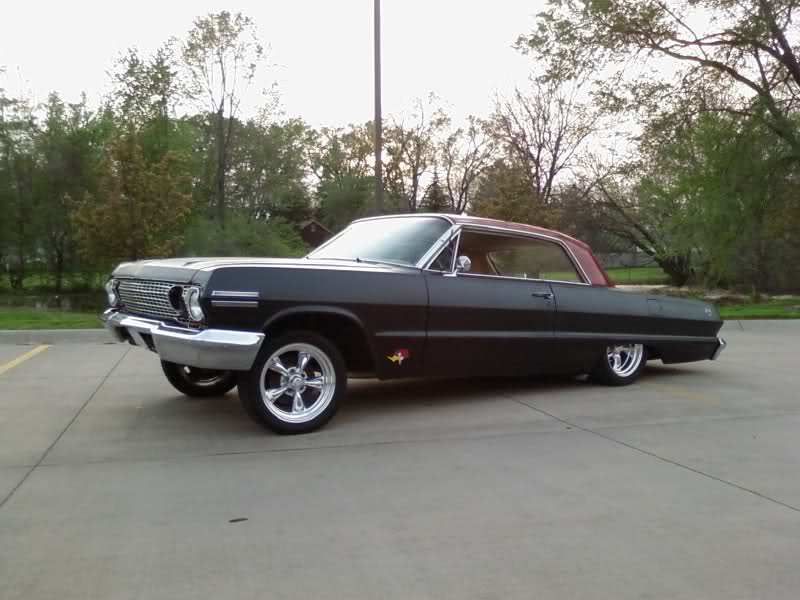

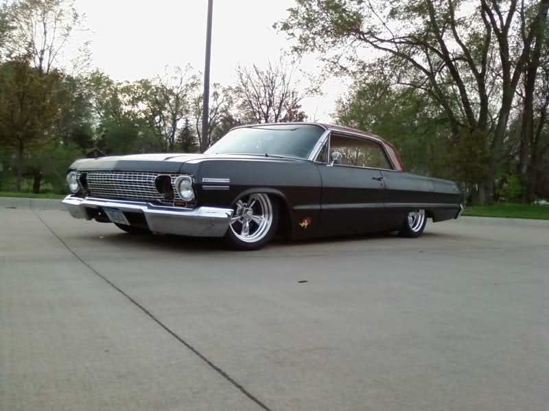

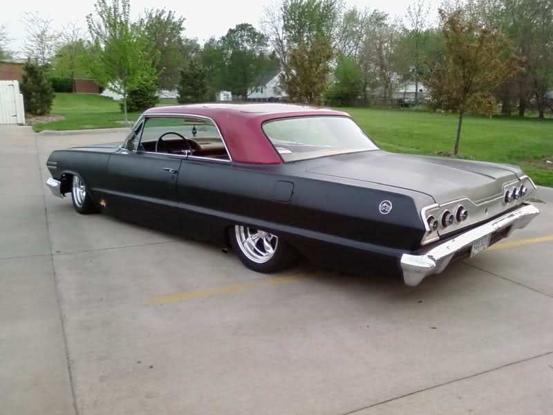

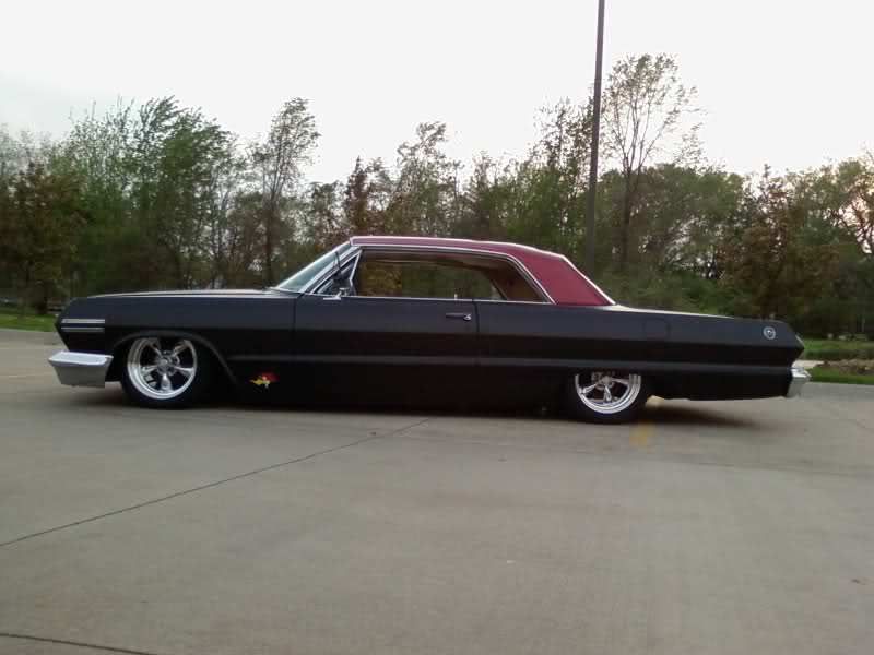

I know this car doesn't really fit on this board, but I was talking to low95xlt because I he saw my old dually project for sale again after I got rid of it. I traded it for this Impala body, with which I bagged, installed a TBI 350/ 700r4, flat blacked and have driven the crap out of.....anyway...here are some pics and a few videos...
The air setup consists of:
Airlift 2600 180psi bags, SMC 1/2 fills with 1/2 ID hydraulic hose, 3/8 SMC dumps. Single 5 gallon tank with a Viair 460 for backup. Engine driven compressor not finished yet. Video is at 250 psi with Nitrogen.
Engine is fuel injected 350/ 700r4 combo.
