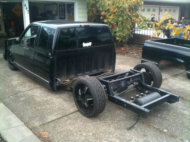

Got the front all cut out.
Started tearing apart the rear

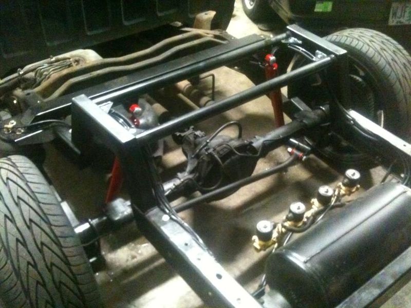

got my link bars and front cups from ekstensive.
Got my bags, relays, and valves from autoloc when i was working there.
Made my own notch
I've seen worse welds. i'm sure someone will pick them apart though.
Upper bag mount
Aired up
Aired down
Clamped down all my airlines

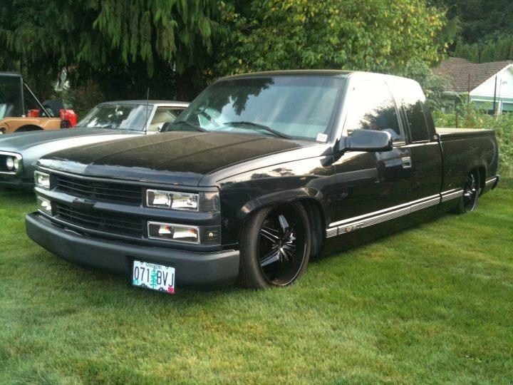

First time out of the garage since it's been bagged.
Rear set up
Shocks are on, used thor bros upper shock mounts. i think they look good.

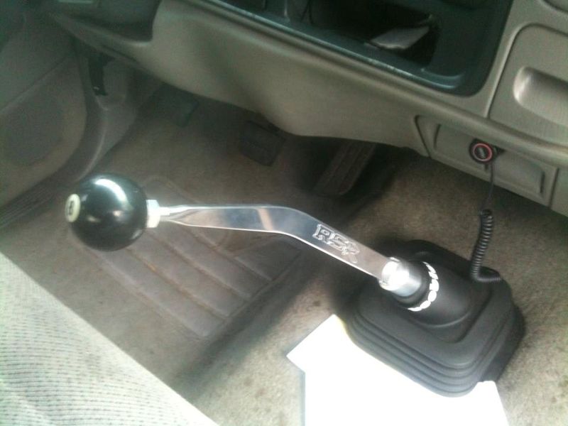

Got a new shifter
What it looks like as of now.
i've got taillight fillers, a rollpan, caddy buckets, caddy lights, and a handle flip kit for it too. just wanna drive it for a little bit before i start working on it again. i'll post up more pictures as i go.
