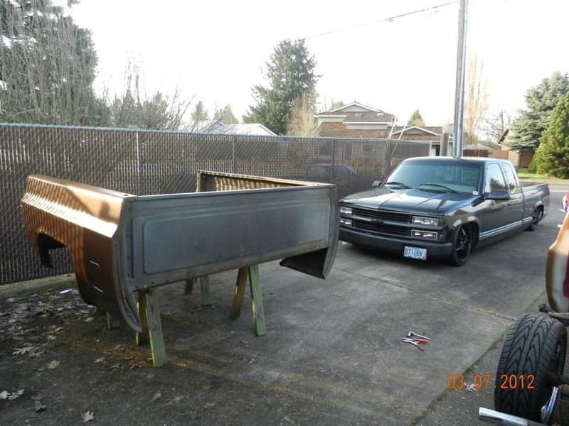

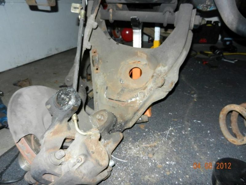

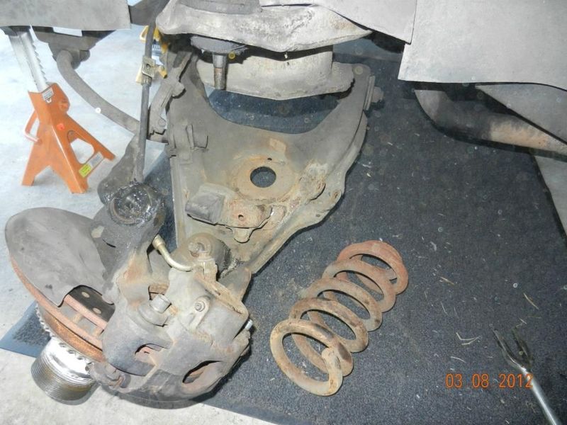

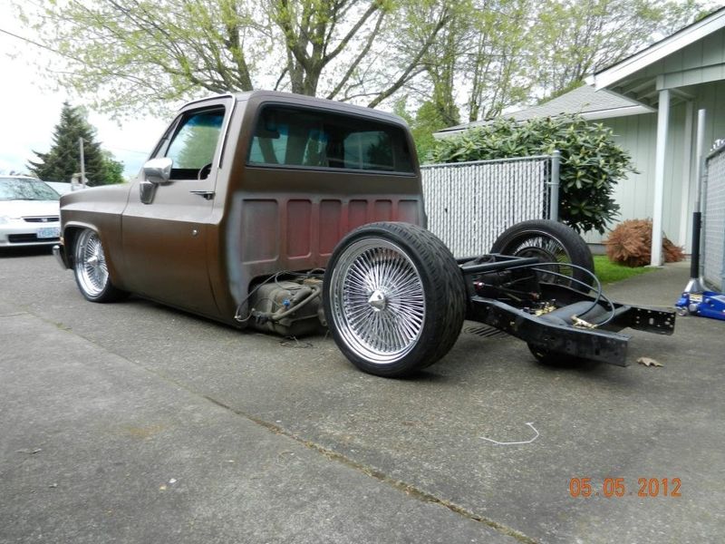

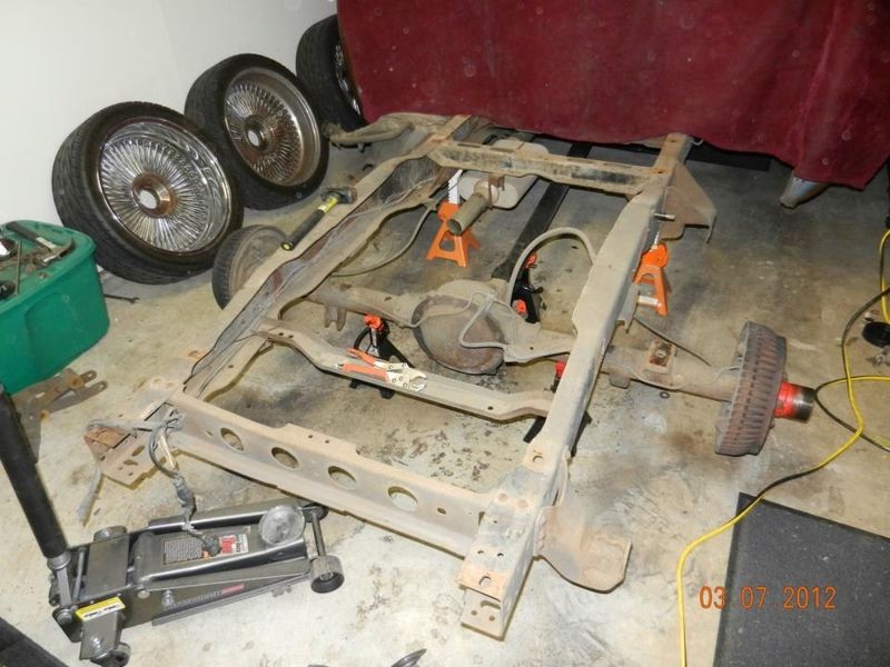

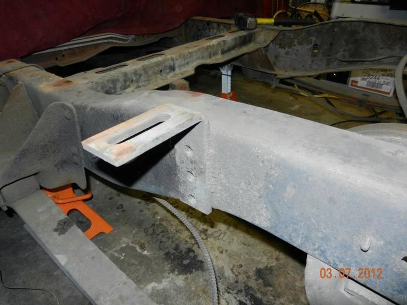

Alright so i worked on the truck for a few hours tonight. got the bed pulled off.
Looks like this thing had a fifth wheel hitch hooked up on it at one point. got them cut off.
i got the wheels pulled off and the truck up on jack stands plus got the rear end pretty much stripped. pulled off the leaf springs and shocks And cut the exhaust off infront of the axle. just going to put a 45 on it to point it down.
that's it for today. i'm sure i'll have more pictures for tomorrow.

Looking forward to seeing this come together. In the meantime I'd like to see some pics of the fullsize in the background.
TooLowSdime's avatar
TooLowSdime
that's my project. i'll see about posting up the build up of that too here soon.

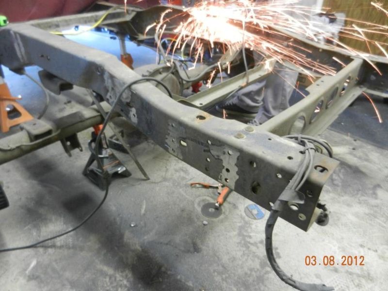

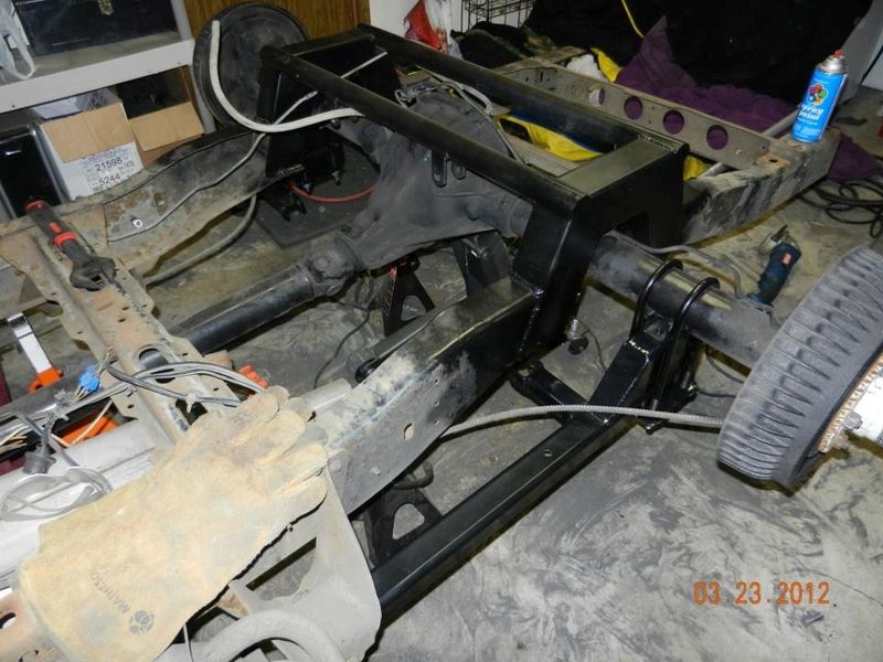

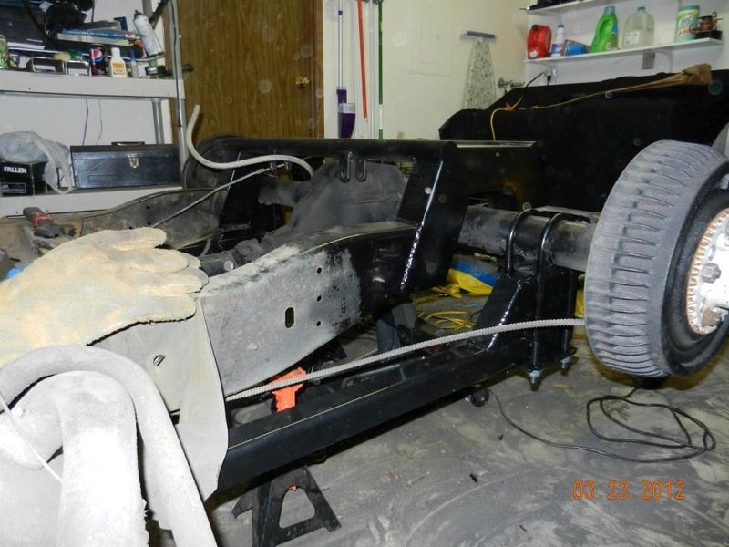

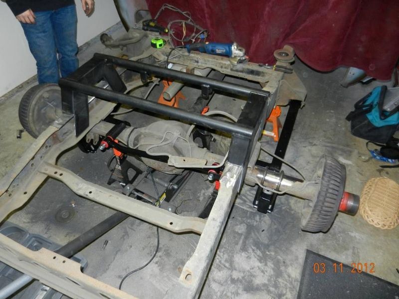

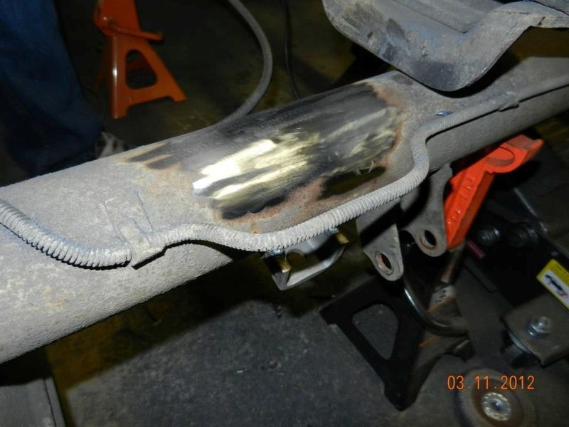

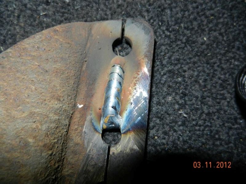

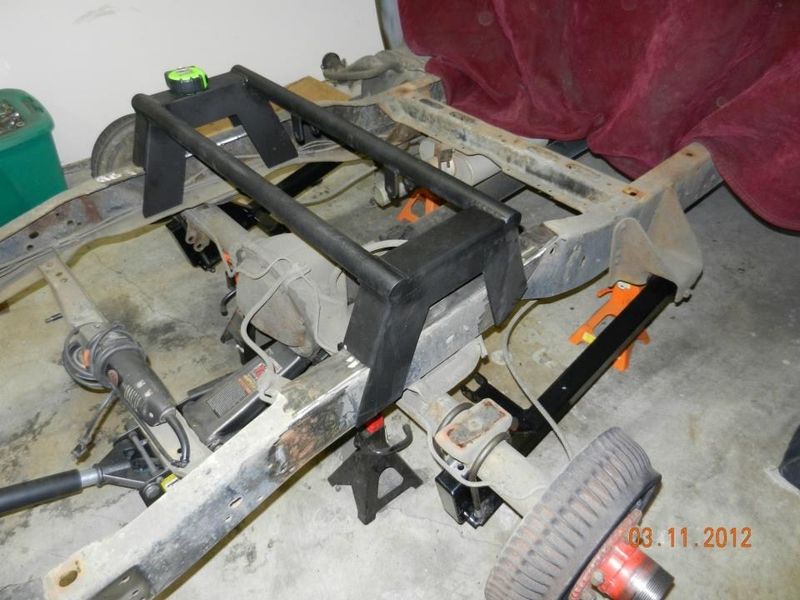

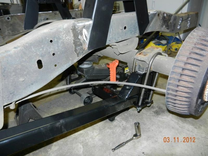

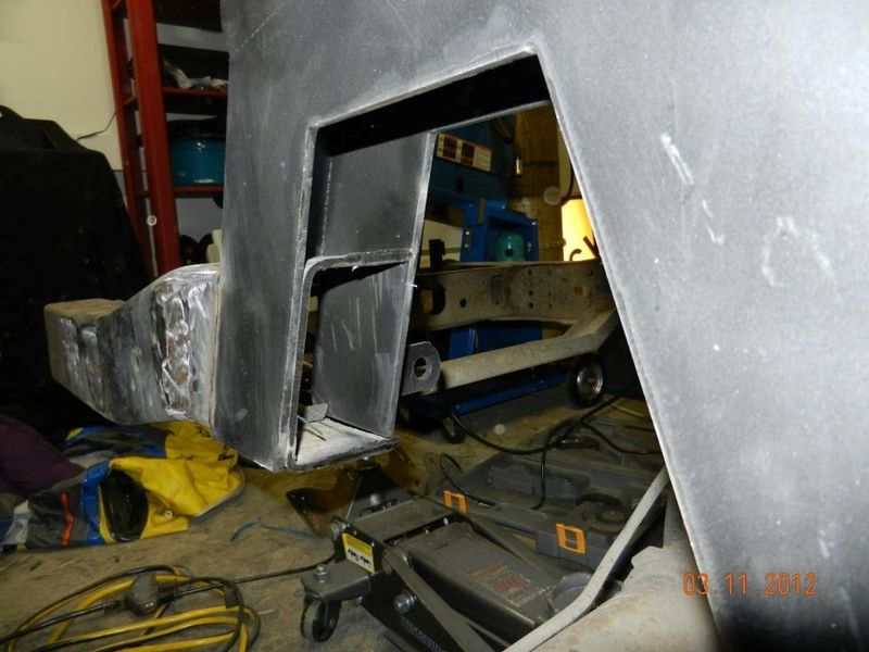

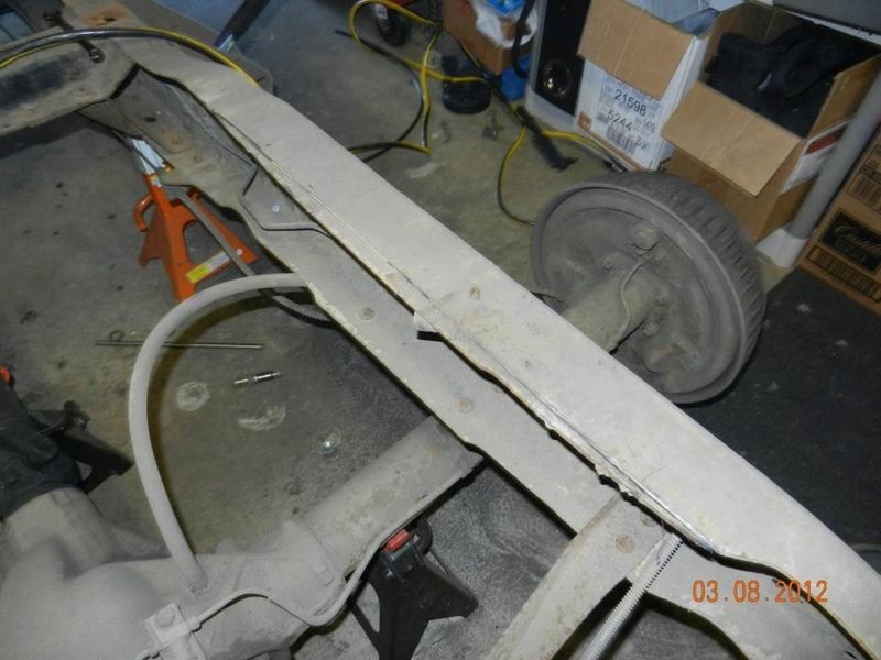

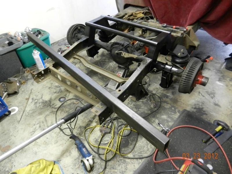

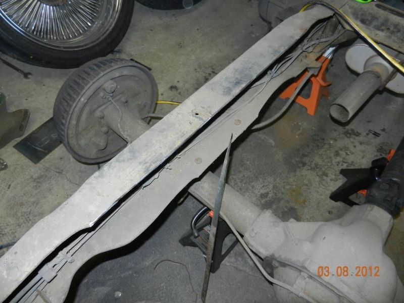

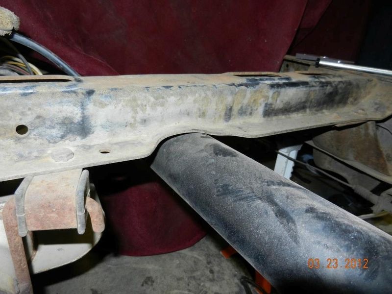

So i started out this morning by taking the link bars and panhard bar down to the powdercoater. then came back and started cleaning up the frame. Taking off all the stuff that isn't needed any more.
Started trimming the frame so that the notch will slide over it.

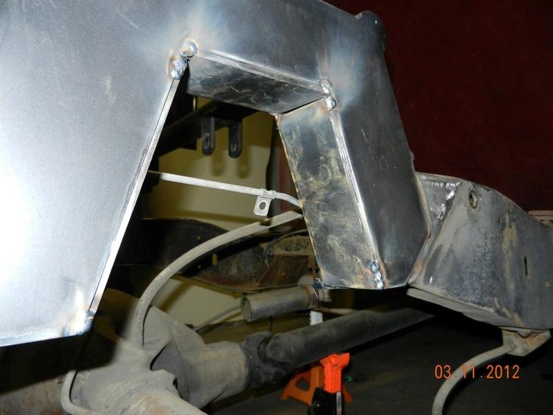

After it was cut down.
Got the springs out and started cutting off the bumpstops.
Got the rear leaf spring hangers cut off and other brackets we don't need.

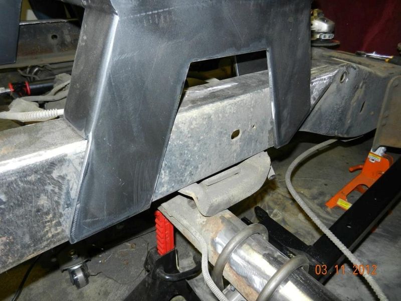

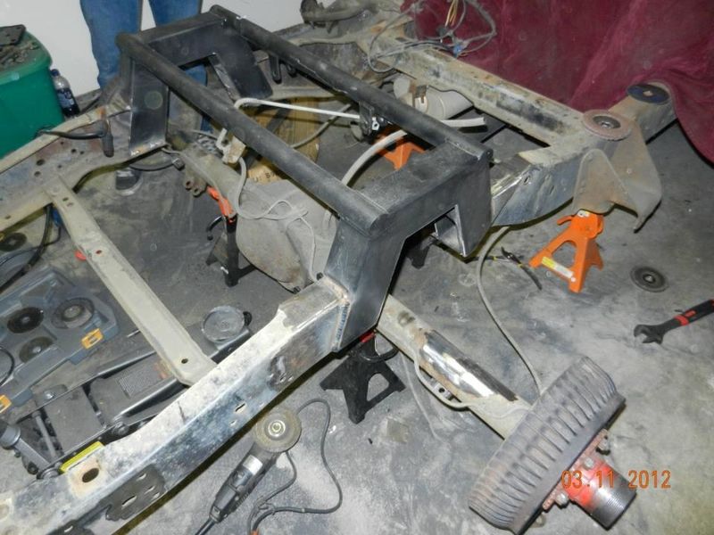

Once the frame was trimmed down we put the notch over it to make sure it fit and get an idea of where its going to go.

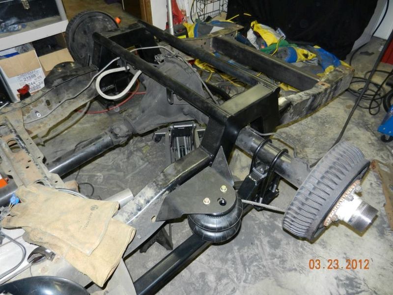

Should get the link bars back soon and we'll start getting the rear link together. and we'll start getting the front bag mounts in. sorry if this is too meny pictures i just know i love looking at the pictures during a build up. i figure the more the better.
