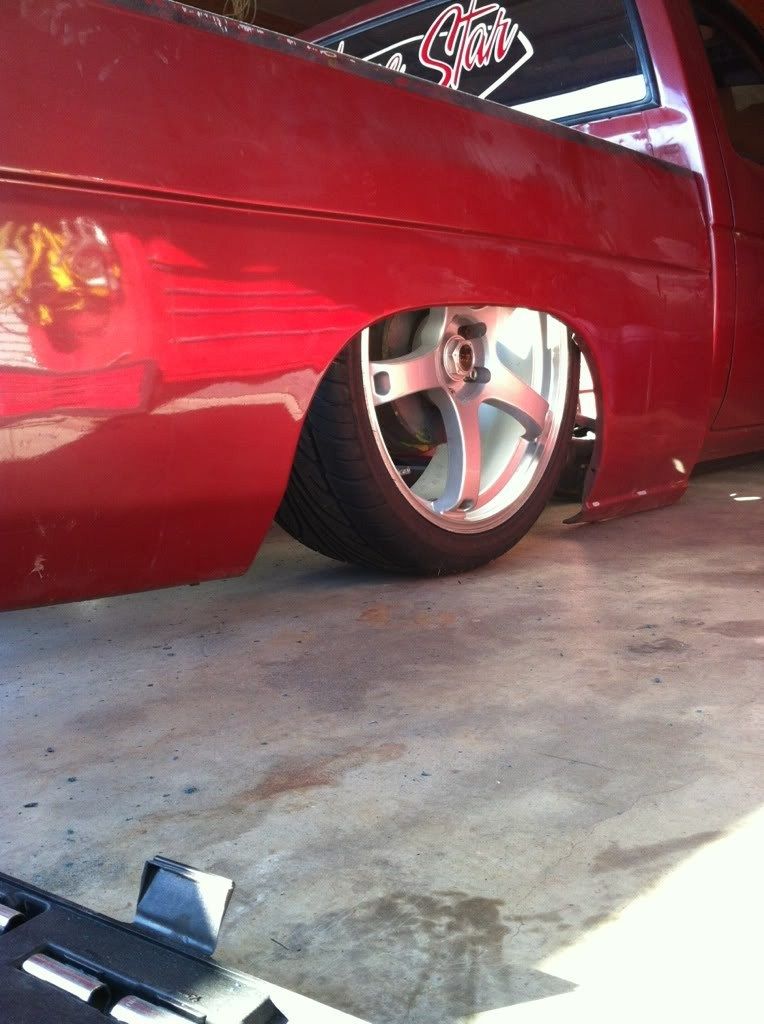

New back half & 4 link set up for 22x10s, but running 20x8.5 MB Motorsports Drifters. Modified Pathfinder gas tank, 5 gallon aluminum air tank, and battery tray (which will hold my compressor; another one will be added to the passenger side for the other compressor). I still haven't figured out where my valves will go, but there's still a ton to do before I'm at that point.
I had to rework the entire front suspension as well; I used Unusual Fabrication's triangulated LCA kit on the lowers, and flipped the uppers upside down and from side to side. I'm running 2500s all the way around with stock hardbody shocks (fronts are not installed yet). I'm still considering a body drop since it's this far apart, but haven't been able to commit to it yet. Let me know what y'all think; I'm open to any suggestions and criticism.

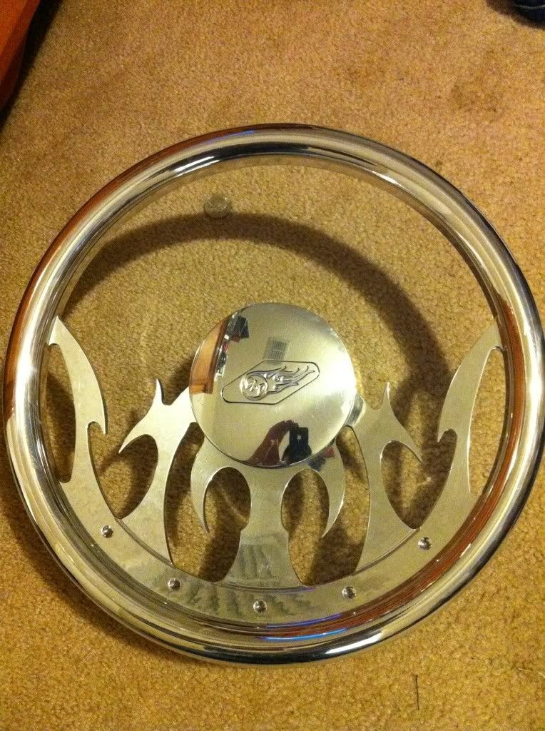

Oh yeah, picked this up from a buddy today...
Thanks Shawny B!

Good decision on doing the BD now! Nice wheel too!
