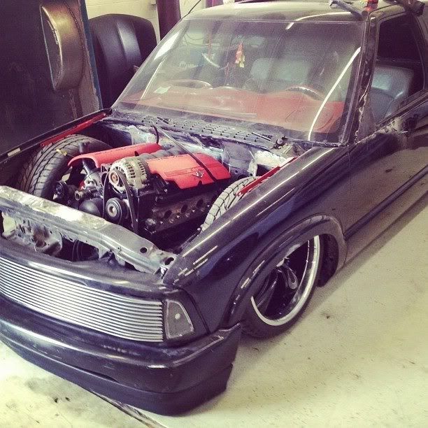

Hey guys big fan of this site but have never posted up on here. Figured i'd throw up my build thread on my new project im doin collabarating with my shop to help me build the truck.

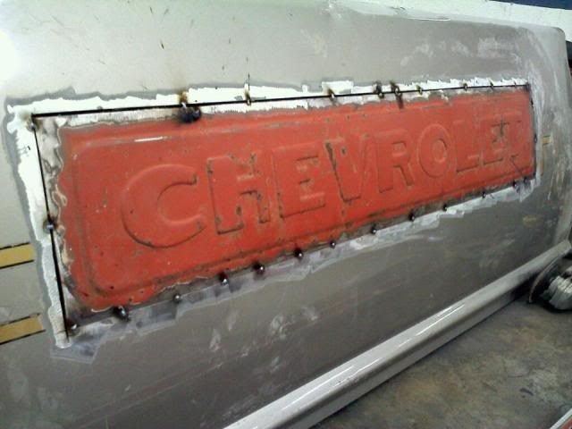

plans:trad. body drop20x8.5 and 20x10 boss 33867 camaro 327 mild buildred bedliner,red interior,red ragtop,red fire wallsuicide doors47 chevrolet tailgate frenched into stock tailgate59 caddy tails frenched in stock locationphantom grillegrant kustoms 4 runner bumperetc!

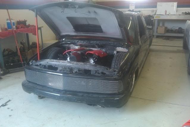

edit: cab is stripped and ready for body drop. Just waiting for the electricians to come wire up the 220 to my new area in the shop I work at Blad Boys Muscle cars www.bladboys.com

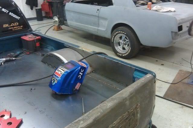

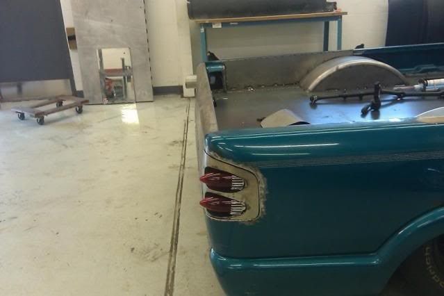

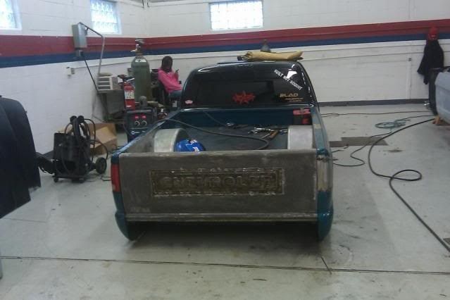

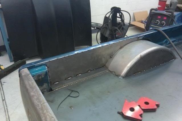

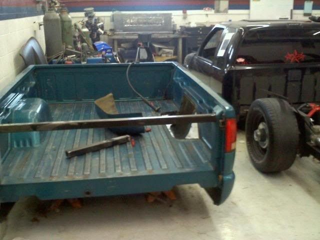

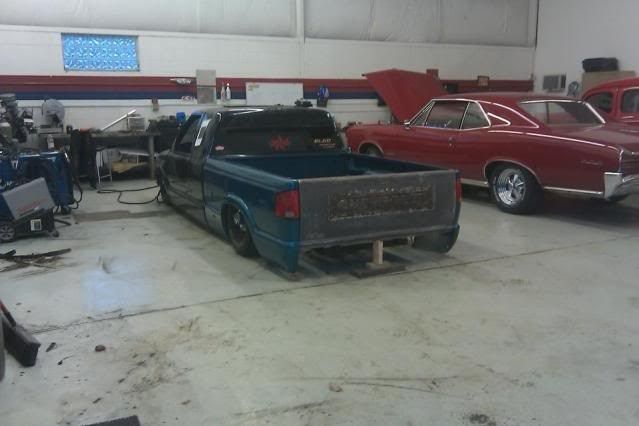

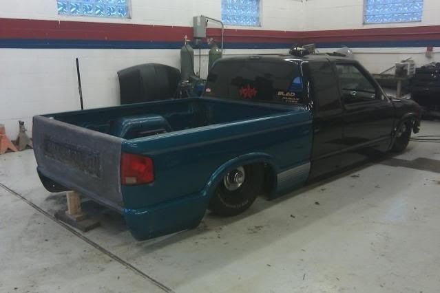

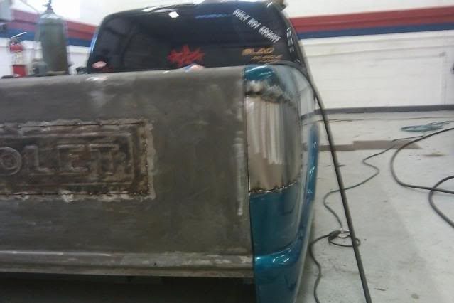

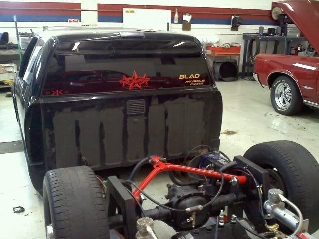

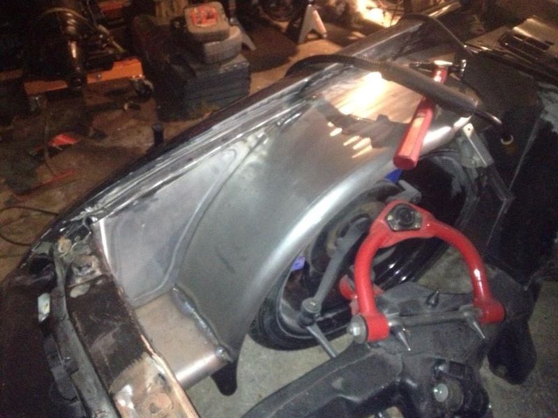

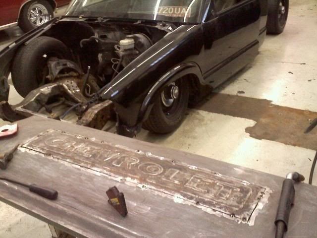

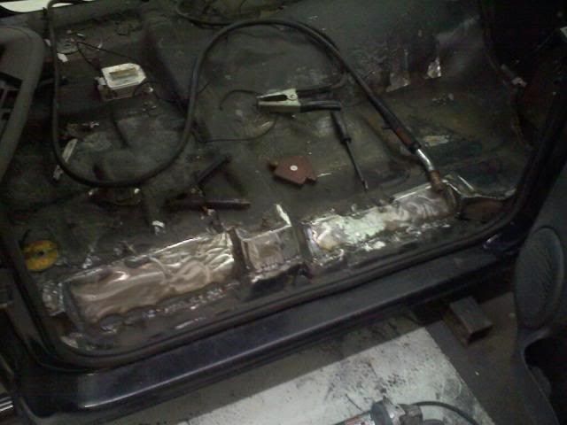

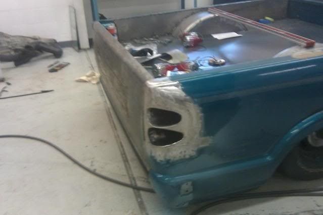

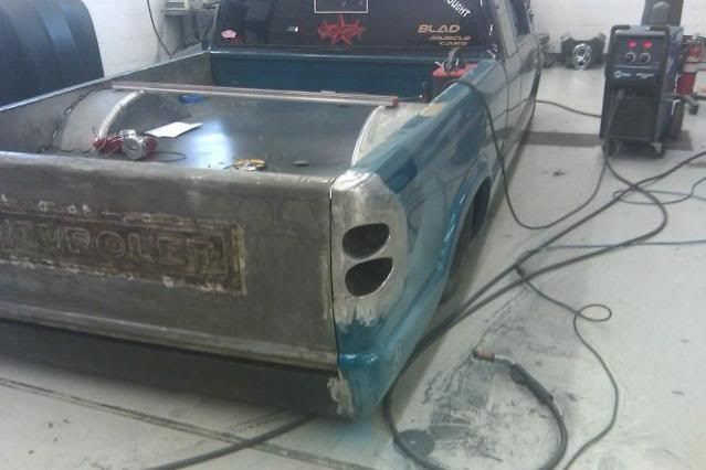

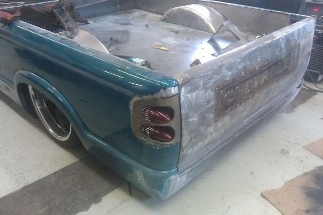

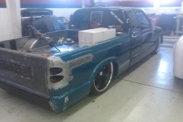

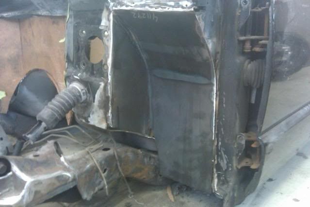

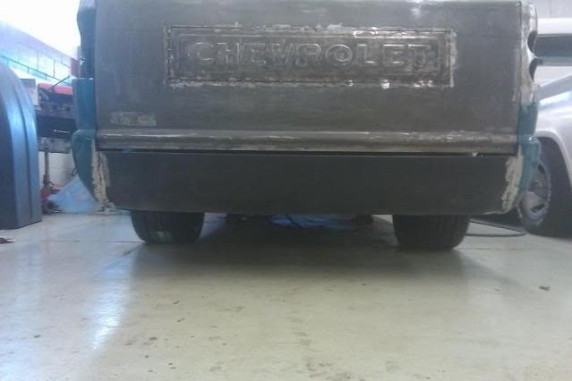

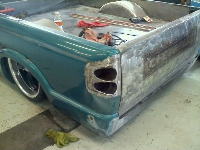

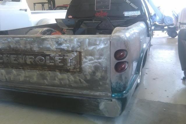

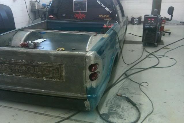

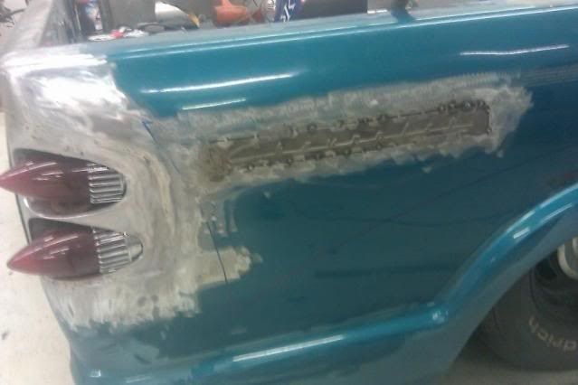

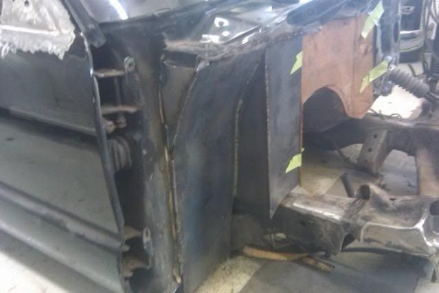

back half was garbage. cut it off
post photo post photo post photo post photo post photo post photo post photo post photo post photo post photo post photo post photo post photo post photo post photo post photo post photo post photo post photo

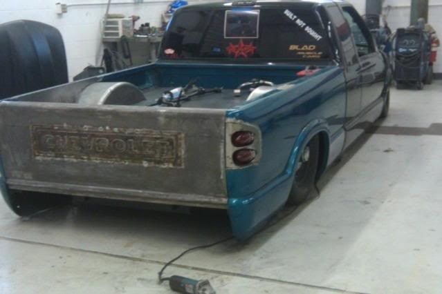

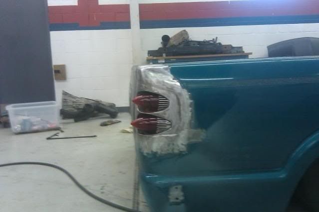

4drbdblazer's avatar
4drbdblazer

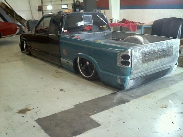

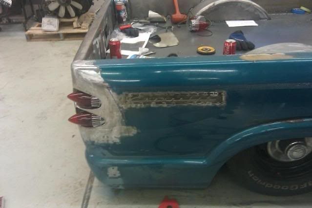

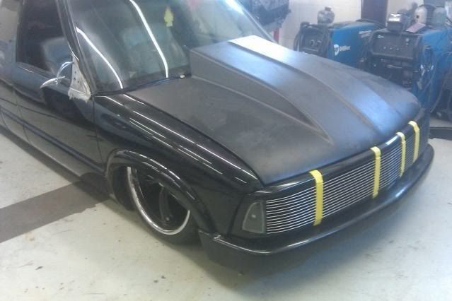

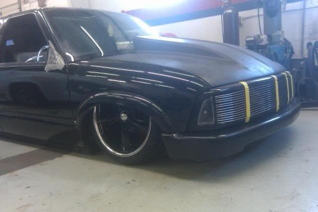

them bullet lights getting frenched in?
ES
Evil s10
yea shaving stocks and frenching them in there

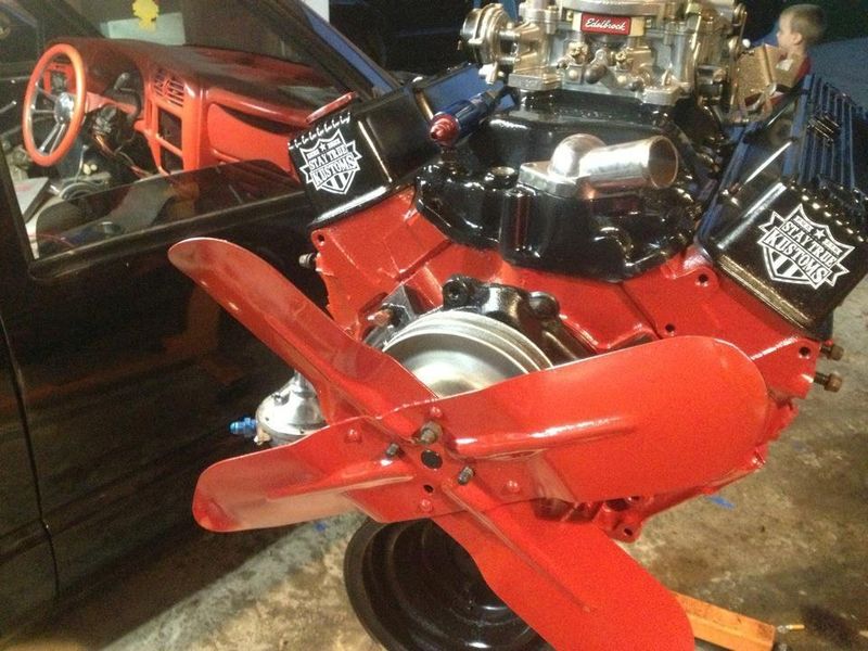

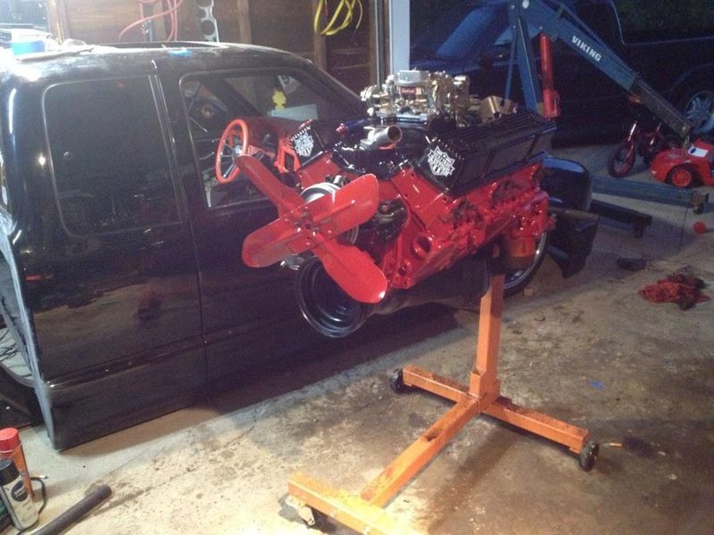

Edited: 9/14/2011 5:34:28 PM by Evil s10

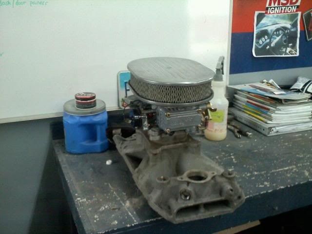

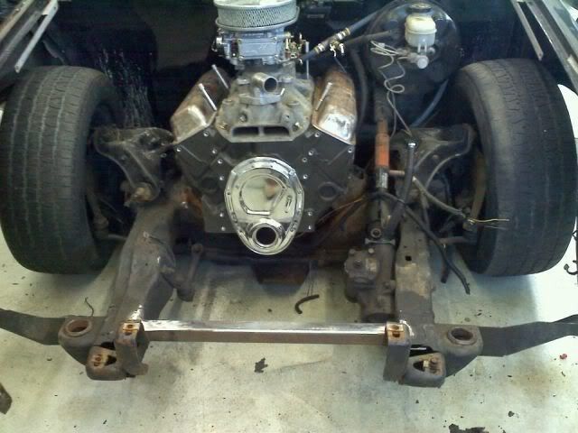

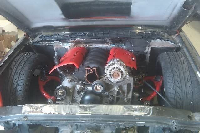

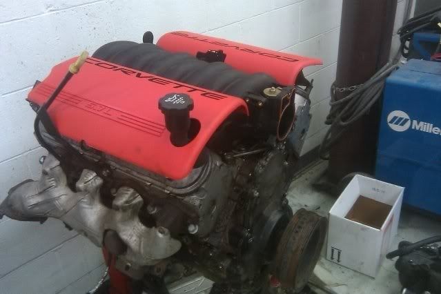

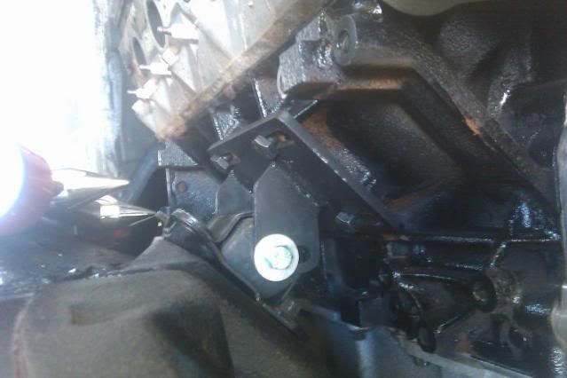

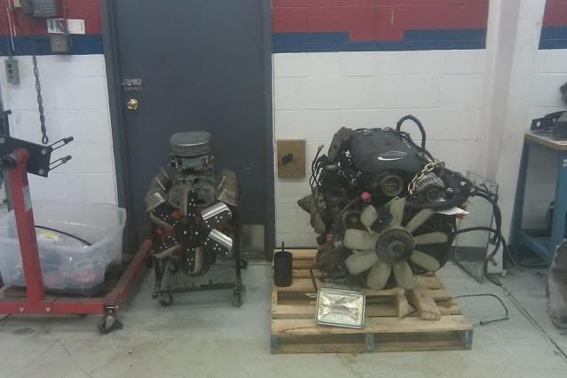

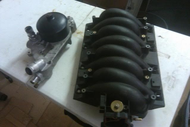

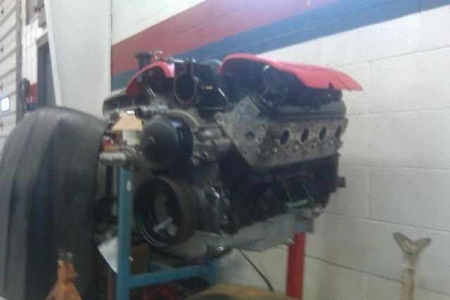

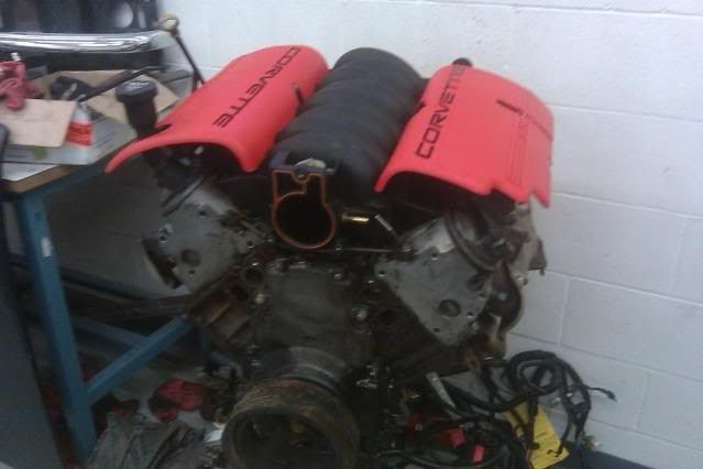

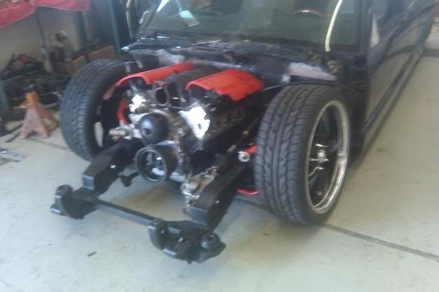

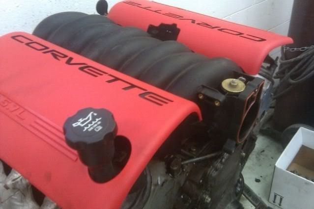

intake
motor

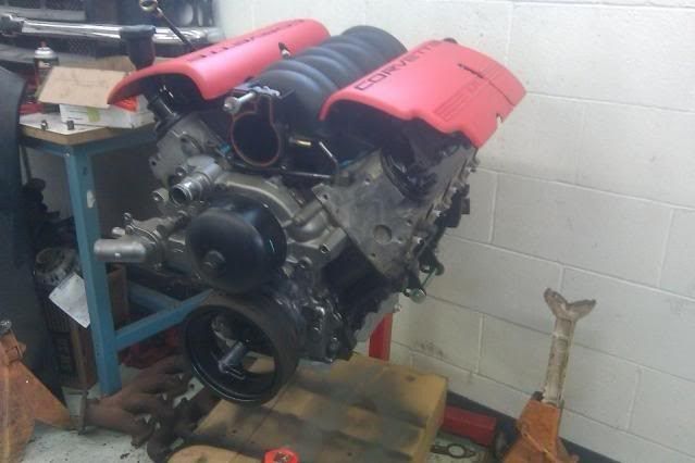

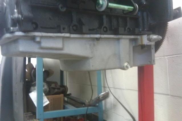

tore the motor down completly today.
engine specs will be

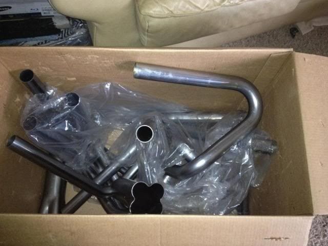

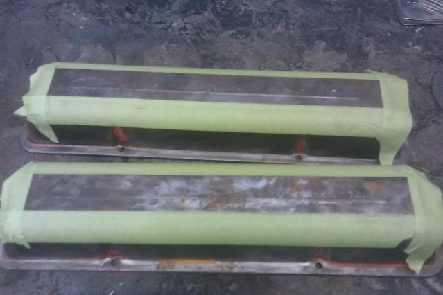

262/305 heads with work327 2 bolt mainedelbrock scorpion intakeedelbrock 650billet specialities air cleaner262 comp camreconditioned rods and crank.30 over60s valve coversbillet underdrive pulleys1 wire alternatormallory distibutor and ignitionmaking my own headers and exhaust

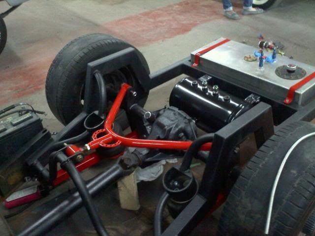

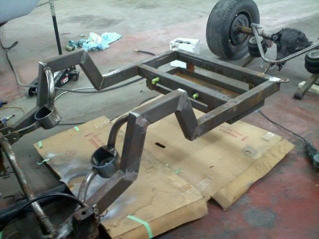

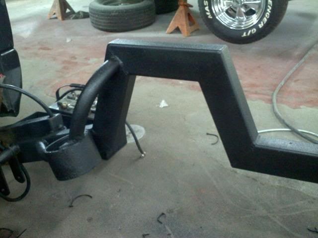

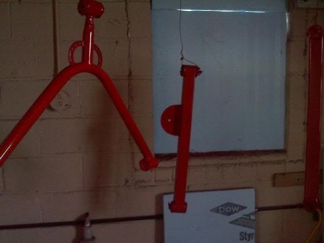

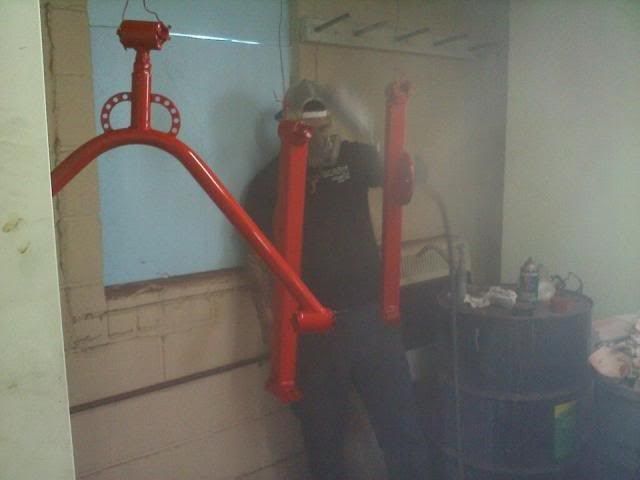

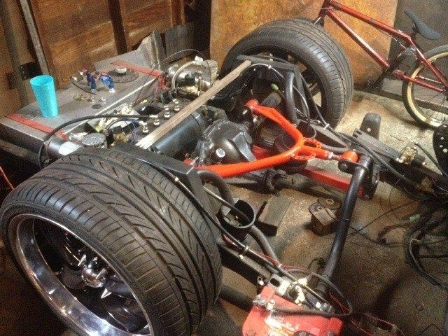

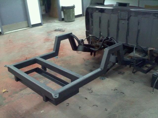

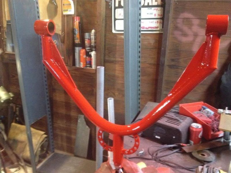

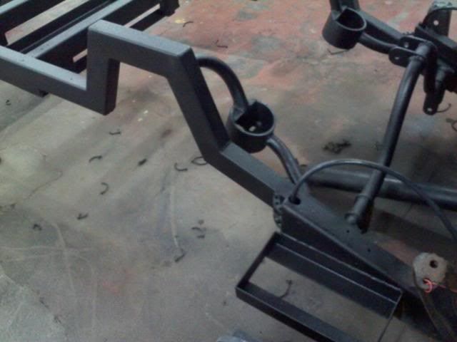

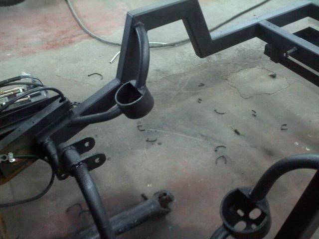

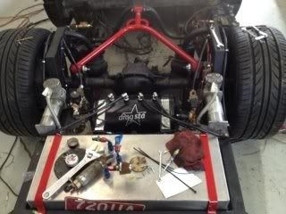

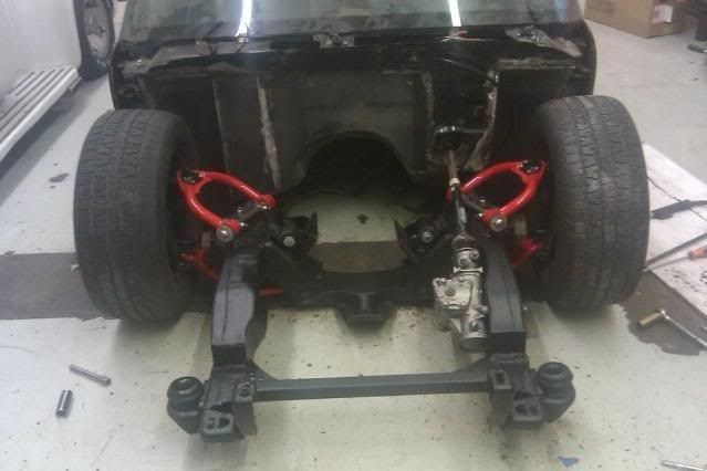

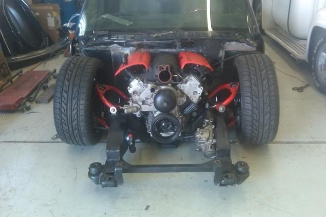

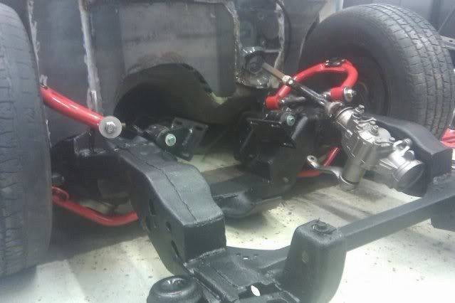

link bars painted, just need cleared. Tomorrow im goin to the shop to clear those, and tape my floor for my cuts for the body drop.

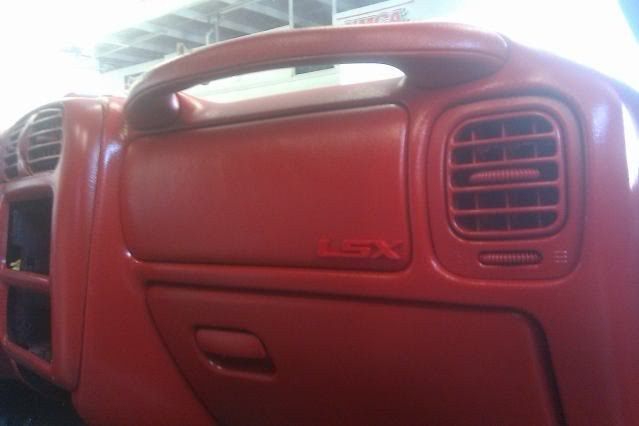

will sell complete interior to 98+ gray and black stock interior
dash
doorpanels
plastics
make offer

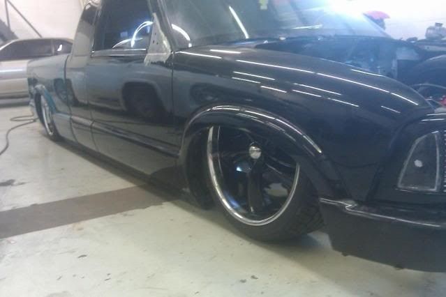

didnt like the way the wheels looked in the rendering so i had him change them back to stock gloss on polished lips.

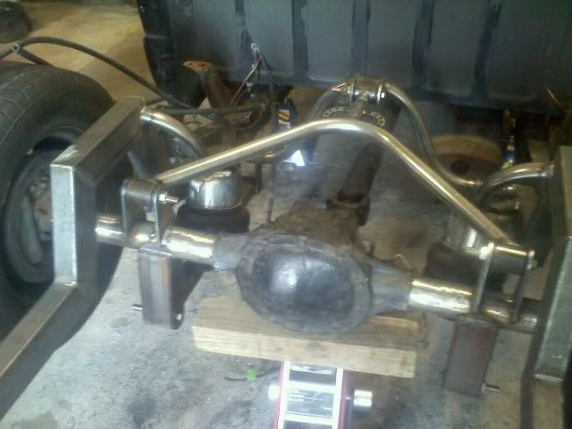

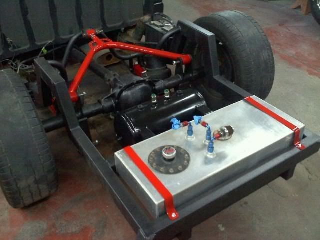

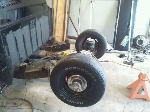

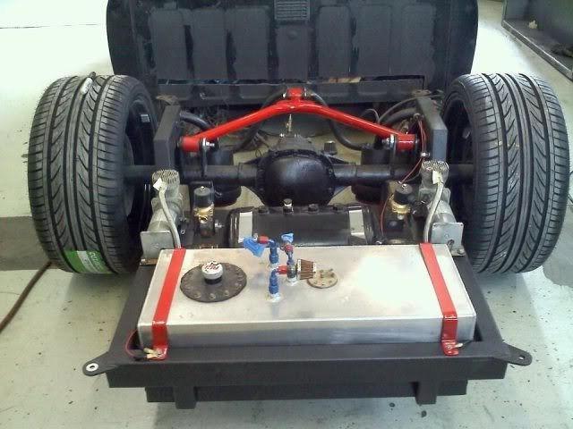

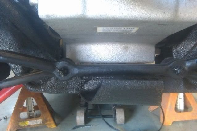

got the link bars painted cleared and put back on the truck, along with the fuel cell bags and airtank

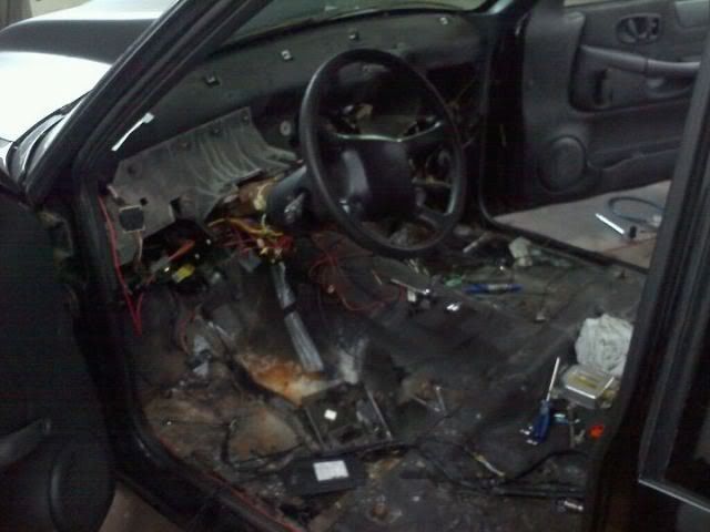

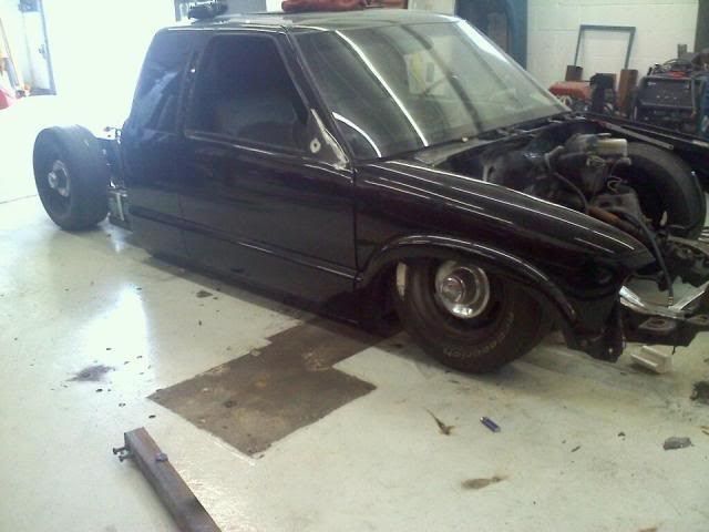

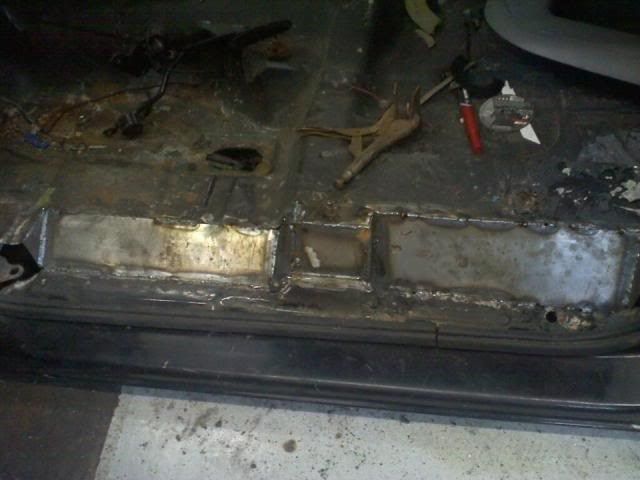

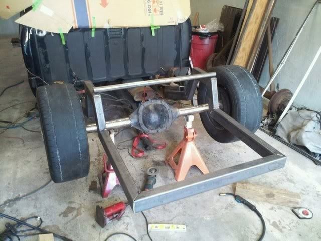

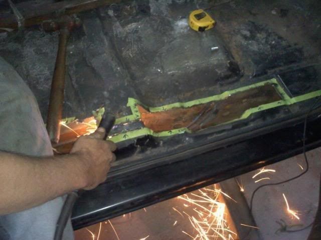

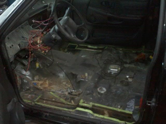

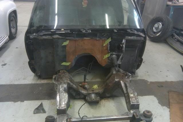

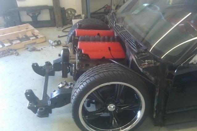

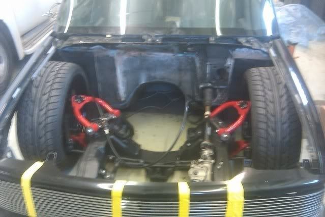

Got the cab cut up for the most part for the body drop, and wiring harness removed.

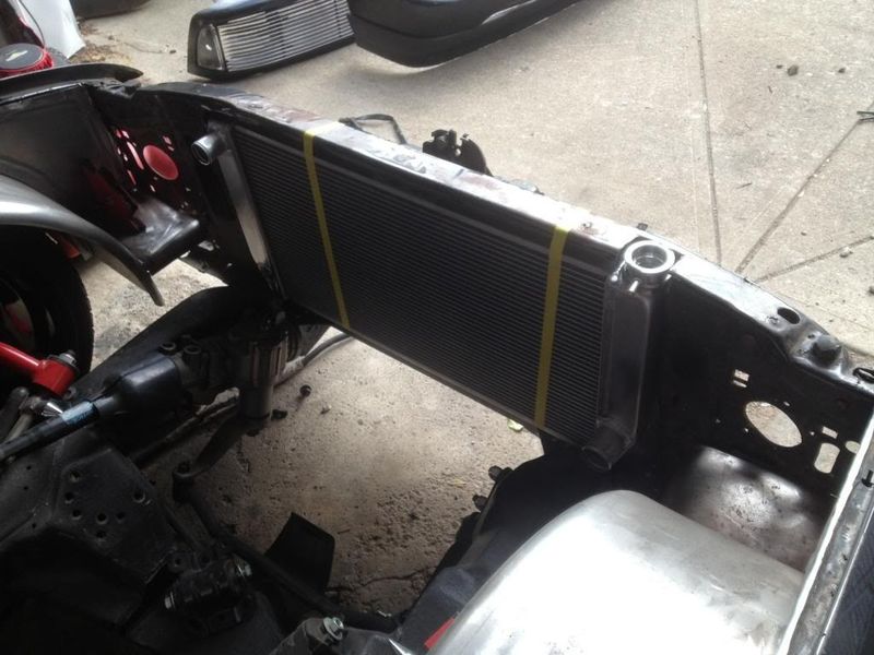

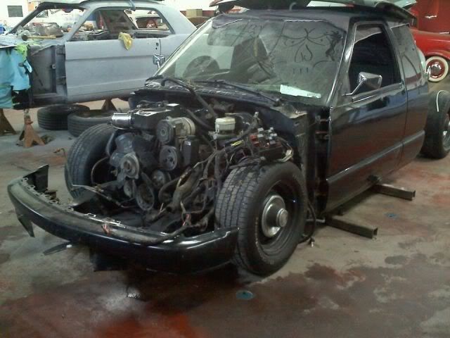

and got the front end off for the most part

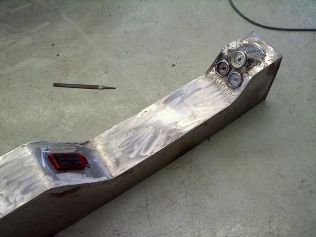

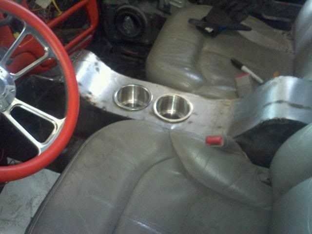

made some visual straps for the air tank just because

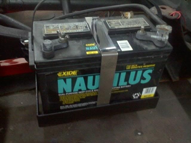

battery strap

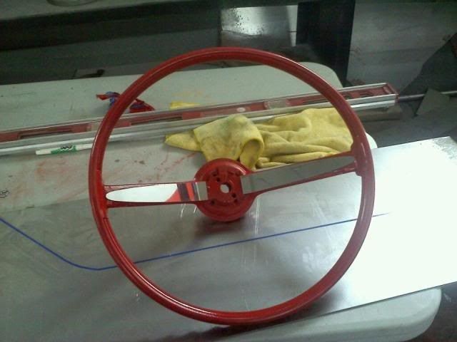

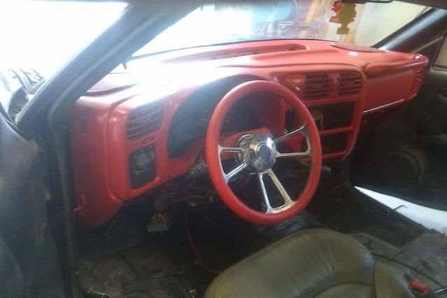

steering wheel im working on out of a 50s or 60s chevy I restored and painted, put some polished pieces on and gonna hand make a center/horn button out of stainless and polish it to match

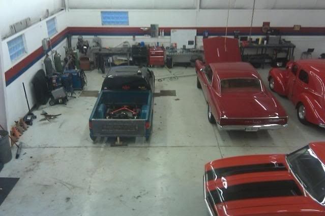

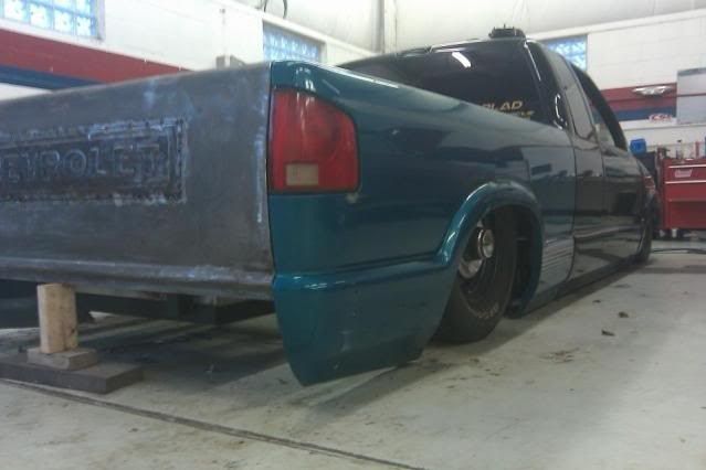

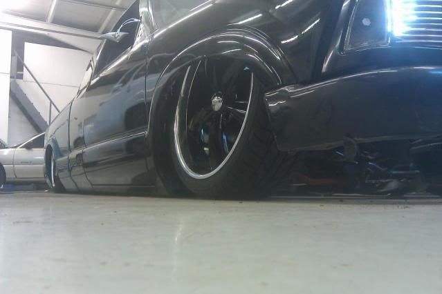

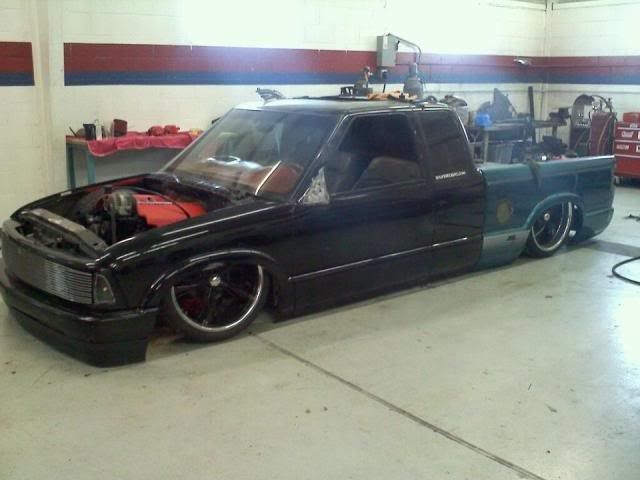

got the cab dropped today
