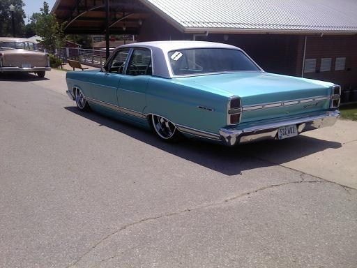

onelowminitruckr
This is my buddy kyle's.

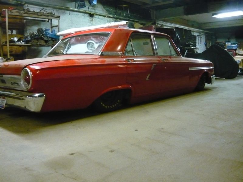

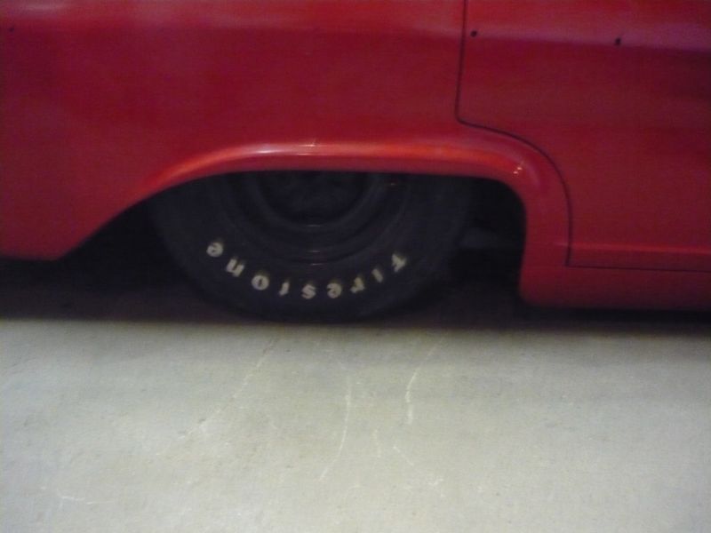

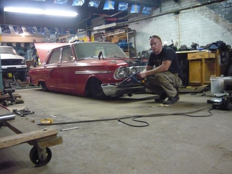

4 link is in, I had to cut the floor out but once I build new uppers the rear seat will go back into the factory location. This is how it sits and I havent even notched the rear frame rails yet. The front I notch the lower control arms, the frame above the tire rods, and theupper control arms are hitting the shock towers so I need to notch those out to get the pinch on the ground. Would save me some time to get drop spindles but i do not feel like paying $700 for a set when I paid $600 for the car. Might go and cut the pinch off eventually and get it to lay true body, but Idk, I know i am going to drag it so i might just keep the pinch on there.
I have a build thread in the builds ups in the truck section...probably should have started it here
