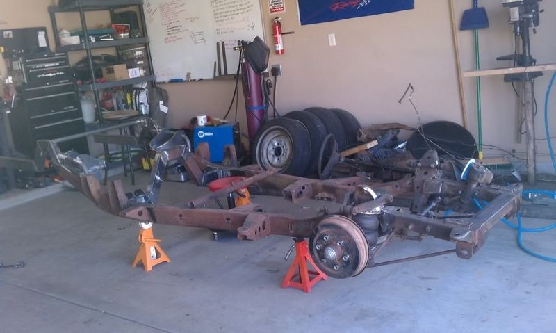

Got the front all the way torn down.
From here it is cut city boys.

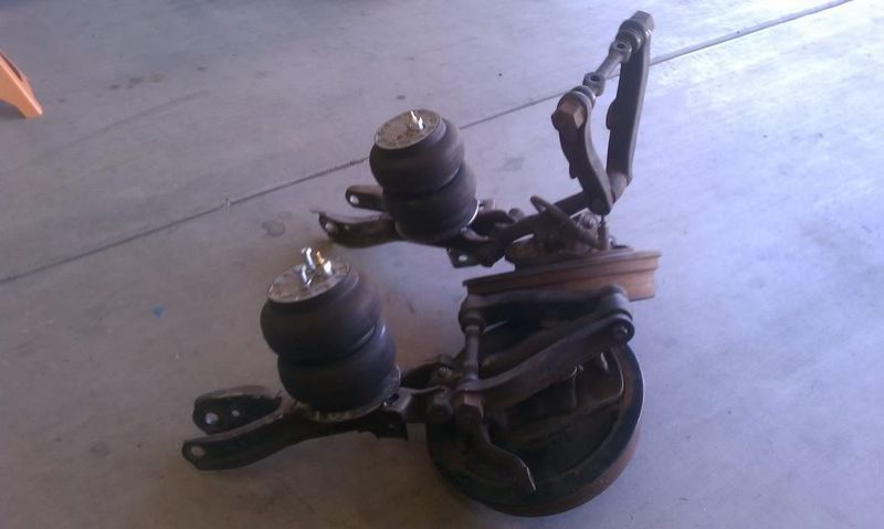

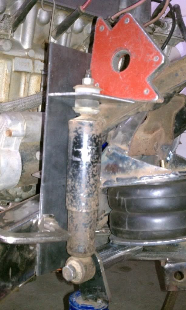

To bad that the wheel and tire fell of the jack when I was locating the lower bag plate and the upper control arm hit the bag mount and knocked it off. I was so pissed.
Damn this thing is a bitch to bag. Second time around for the driver's side, the frame section is better this time then the first attempt.
Still have the bottom bag mount to tack in, then gusseting. The passenger side will come out a lot cleaner, since I've mostly learned what not to do.

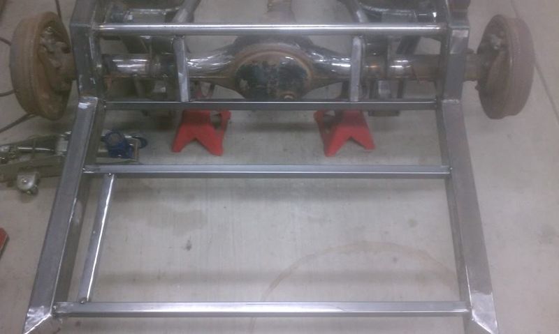

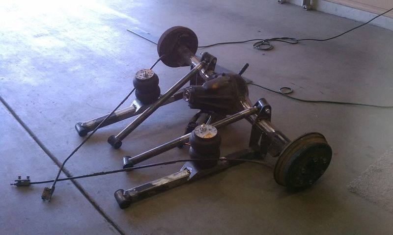

Got the leaf springs removed, axle center and tacked to frame using the old u-bolts. Looks like I can use a small notch in the frame to get this thing to lay. Next on the list is to cut off some random brackets on the frame and then build a cross member.

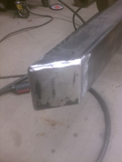

Cut out the peices to build a cross member out of some scrap I had laying around.
Welded all of that scrap together into a cross member, plated the ends, and tacked it in.

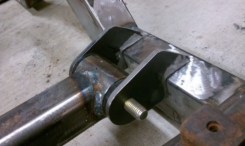

The start of my lower link bars out of 2*2 .025 wall.
[img width=1023 height=612]http://i6.photobucket.com/albums/y222/kaoss77/Datsun/IMAG0008.jpg[/img]
Notching the ends with a chop saw and a grinder. Too bad this is a scrap peice that I practiced on, and not the actual link bar. If you never knew that you could do this, check out this thread. Chop saw notching 101
Found some 17" 10 year old billet wheels!
Got the lower link bars welded together, and the axle cleaned off of the four link tabs. Still have to finish my uppers.
I had to take my link bars to a fab shop and have the bungs tapped out to accept the rod ends after I welded them up, only cost me $20 bucks, but these silly little $20 things always add up, like the $50 in grade 8 hardware for the link bars. Any ways, on to some pics.

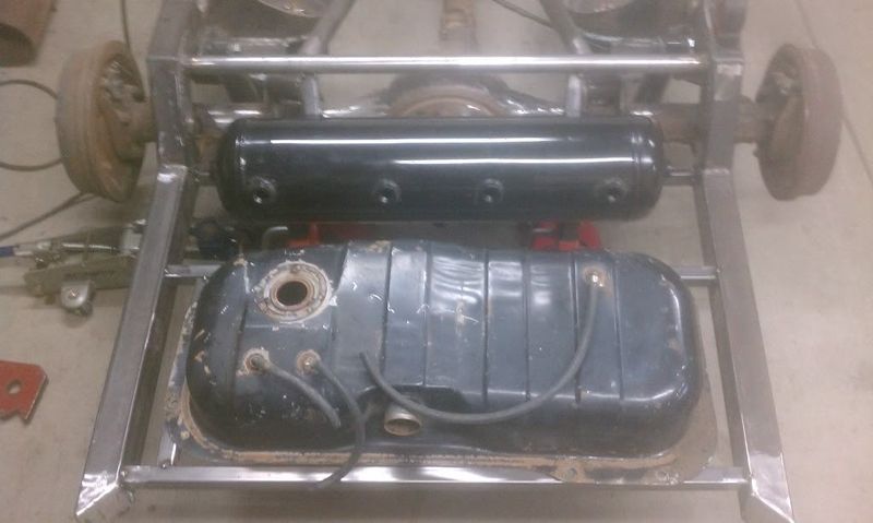

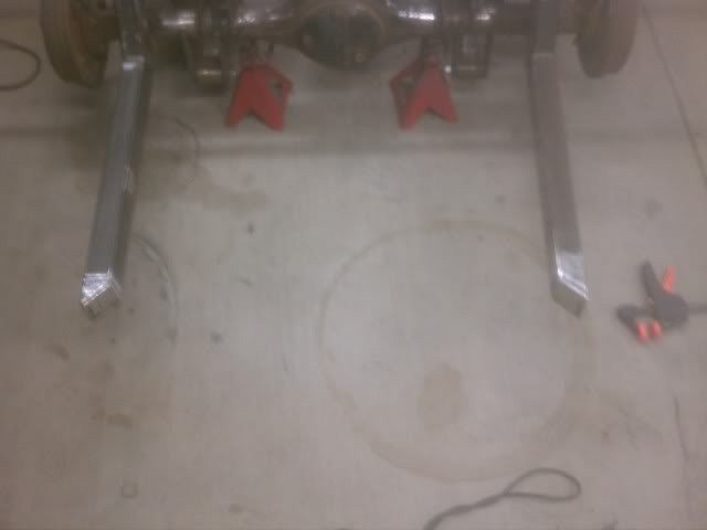

Got fish plates built and the rear frame rails tacked in place. Going to be a booger to weld this all together.
Got the back bag mounts in last night, cut out my own gussets out of flat plate.
At full lock the frame is 7" off the ground, plenty of lift.

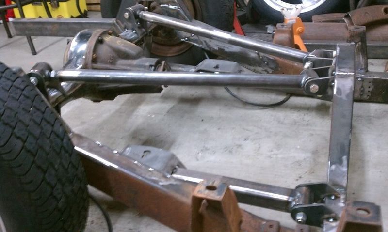

At this point in the build I relized that my instant center was behind the truck, so I fixed that.
I lowered the upper mounts the most that I could.
Then I cut the crap out of everything that was keeping it from laying. There are a couple more remnants of cross member that are still keeping it up, not to mention that I'm out of suspension travel in the front.

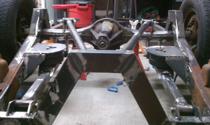

Got the four link squared away this afternoon.
Feels good knowing that's it right.

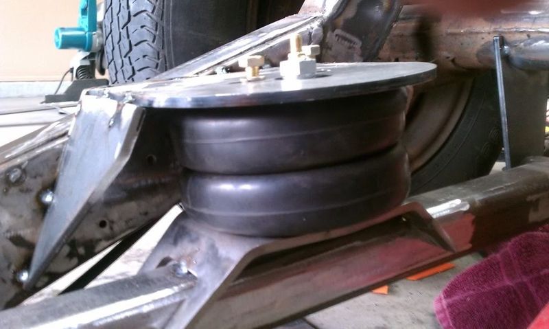

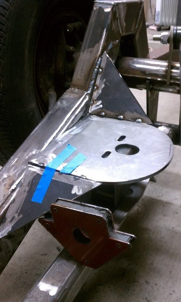

Also trimmed a quarter of inch of the bag plates so they could be mounted off the frame instead of on top. Started working on getting all of that mocked up. Not sure how I feel about how I'm going to have to run gussets though.
Got one bag mount figured out. A lot better then last time, there will be some vertical gussets build also.
I now have 4 matching tires, but not 4 matching valve stems so I have to take them back to the tire shop to get chrome ones on the other two. Seems petty, but who the hell runs black rubber stems on billets?
I got the other bag mount tacked in.

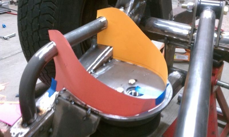

So after I got those squared away and tacked in, it was time to play a little mini truckin' by numbers. I made some templates to take to the fab shop to have my vertical gussets cut.

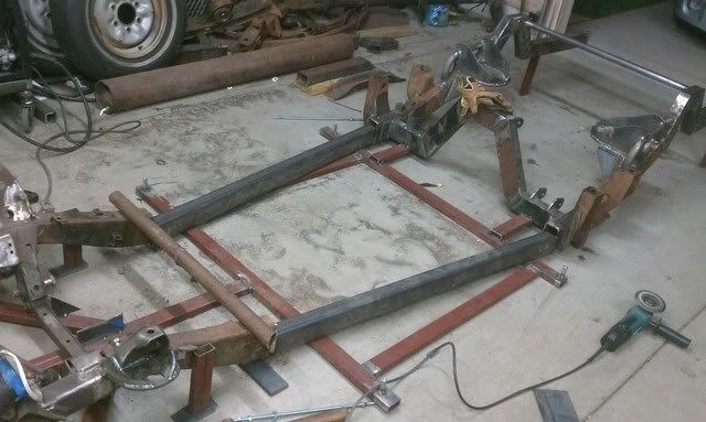

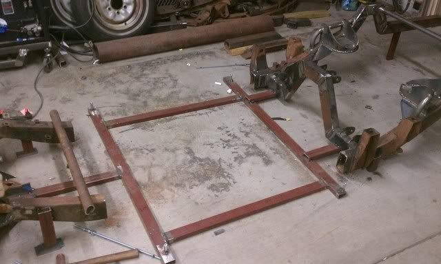

Well, Henry from Canada stopped by on his North American Tour and we decided that we would just replace the frame rails on it while he was here.

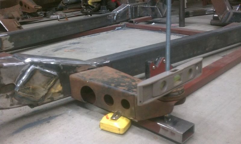

I built a jig a long time to locate the body mounts. We used with a few pieces of additional metal to jig it up, cut out the old frame rails, and tack in some new ones.
Did a little fabrication by numbers yesterday. Dug deap into the supply drawer and found any old blade and roloc disc that I could to get this done last night.

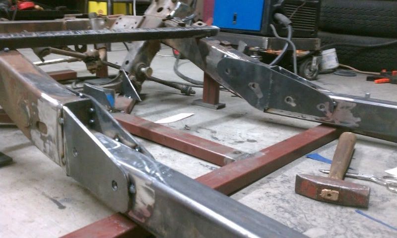

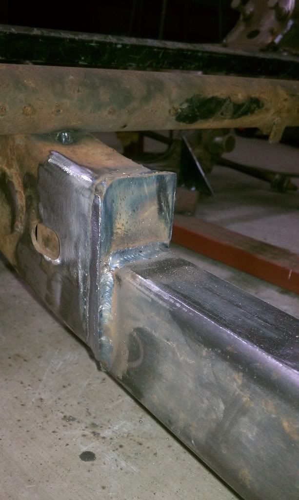

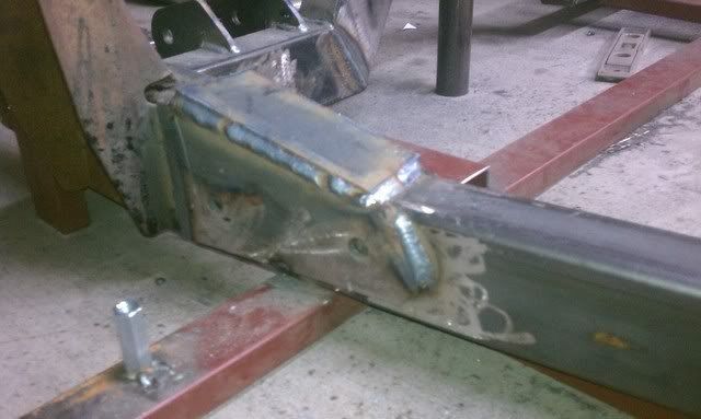

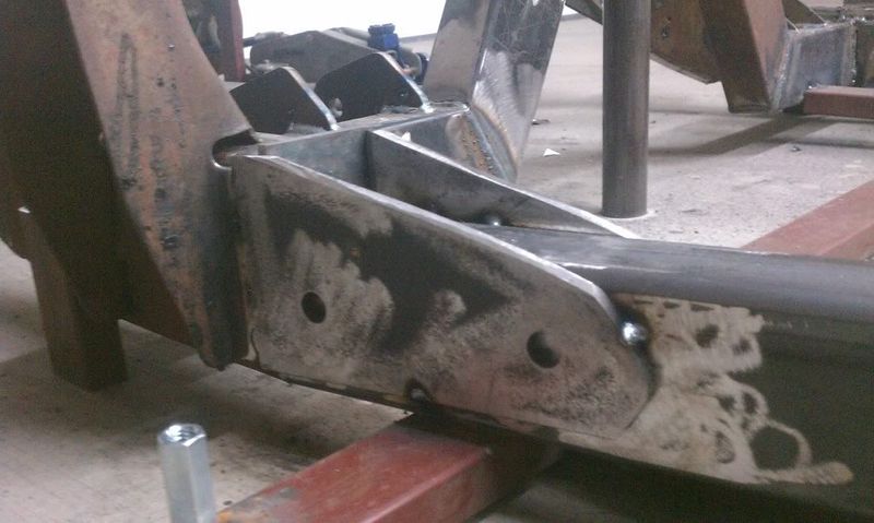

Hand cut these with my 4.5" Makita grinder and cut off wheels. They are fish plates to strengthen the connection between the old frame rails and new.

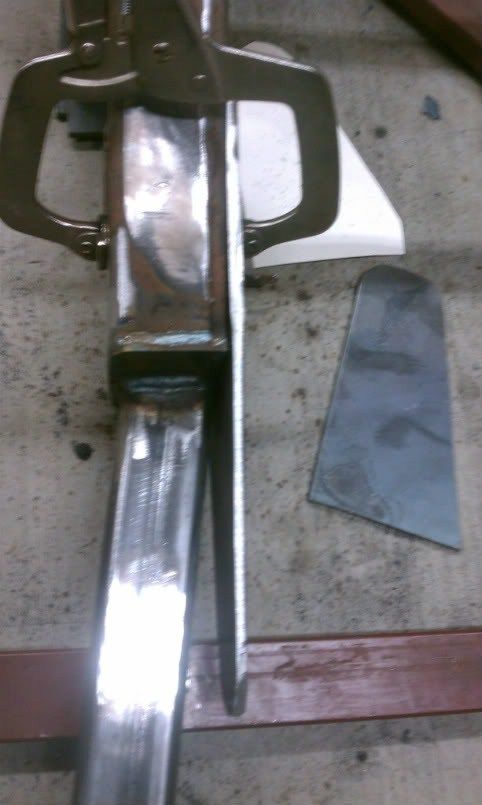

Tacked them to the plates I also hand cut to fill the gaps between the old frame rails and new.
I also cut the plate that goes on top to cap it off. I hope to get it welded up tonight. Total time for these little plates is 6 hours. Not sure if I'm just slow or what.

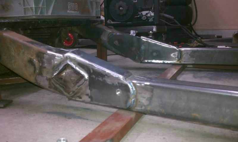

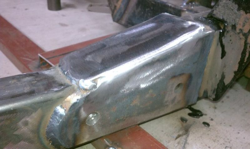

Got the plates welded up and capped off last night.
Nothing too exciting, I cut a couple more fish plates, welded in the front to be fish plated, and ground down the welds on the caps to smooth them out a little.

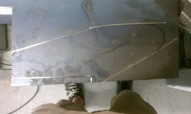

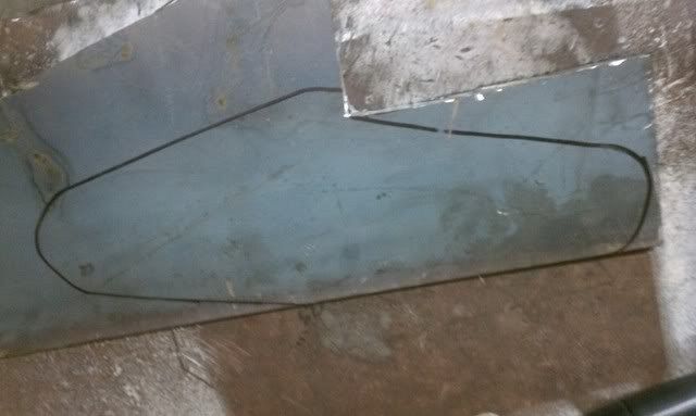

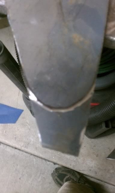

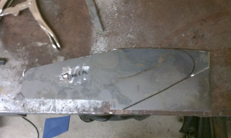

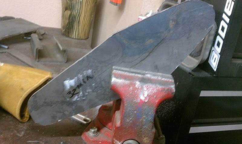

I decided to document the making of my fish plates, and time how long it took.

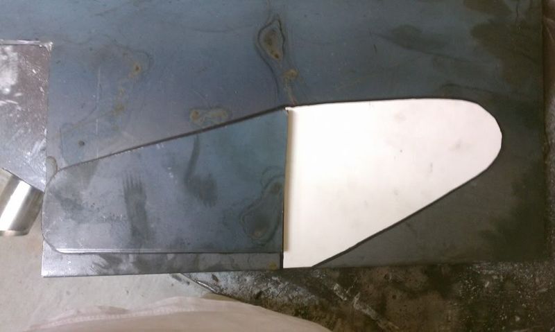

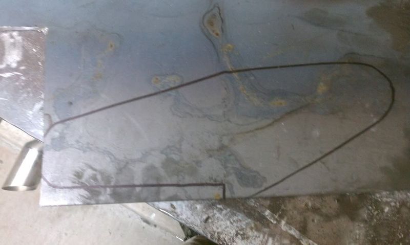

I started by making a template. I like to use construction paper that I find in my wife's scrap-booking stuff, cardboard is to bulky. I already had half of the plate cut out from the other side.
Traced this onto my plate.
Tool of choice for this.

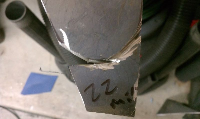

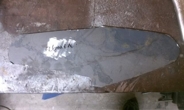

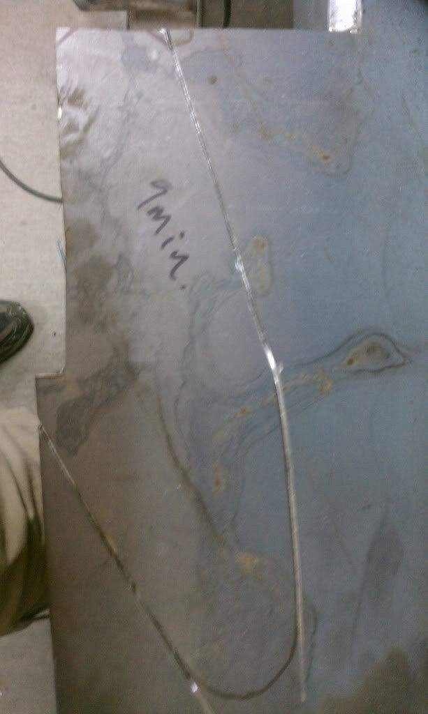

Then the timer started. Here I gouged the metal with the blade, tracing the sharpie lines.
I gouge until the blade can cut through the metal like butter. This is after 9 mins
Time for a new blade.
Getting closer.
For the rounded edges I usually do one of to things, I gouge the metal a little at a time in a circle. This take a while but works great. Sometimes I'll just make a bunch of different straight cuts at different angles.
After 26 mins, here's a rough cut

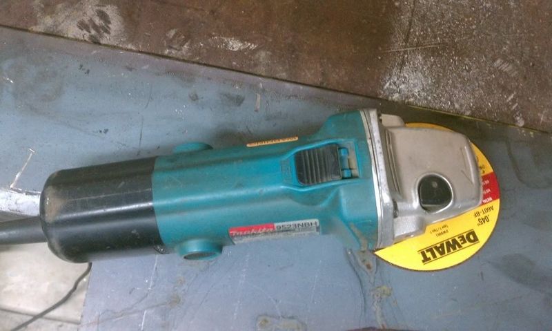

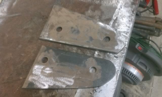

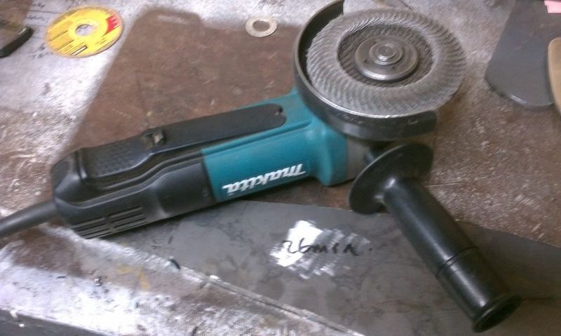

Time for my favorite tool. This Makita is awesome. I've used some good DeWalts, but they just don't compare. That's a flapper wheel on it.

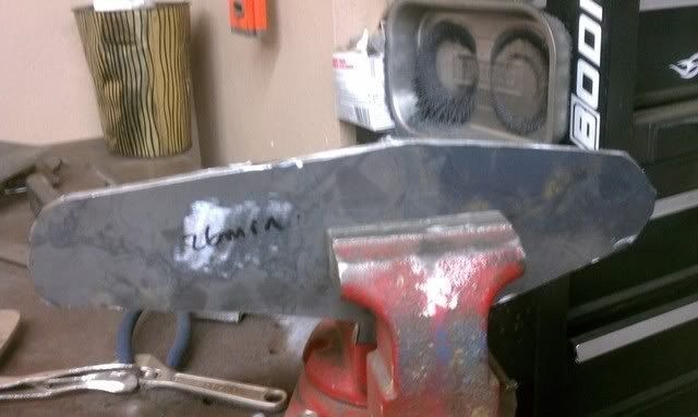

Into the vise it goes, smoothing out the edges.
I can't get that corner, so off to the hand file.

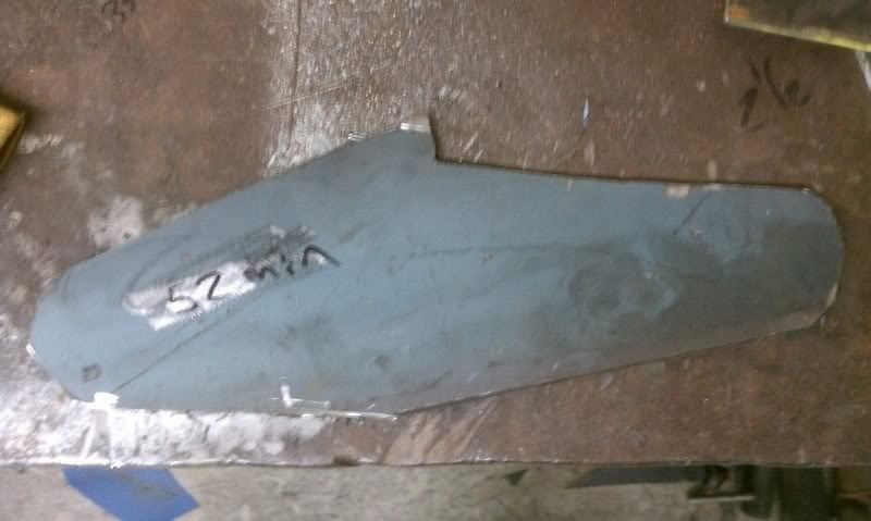

32 mins in, it's done. Pissed off neighbors, numb hands and ringing ears. Too bad neighbors, I still have another one to do.
Luckily with this one, I already had a straight edge.
Then there was two.
Off to the fab shop, I don't have enough heat and pressure to make this work.

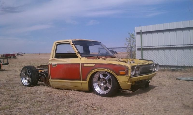

And this is were it actually sits as of 07/18/2011.
1977 Datsun 620, now with permanent frame rails!
