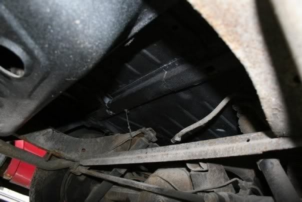

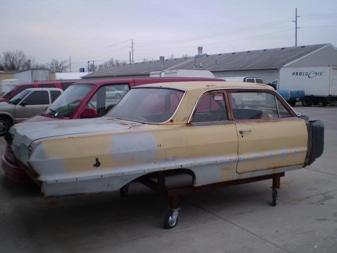

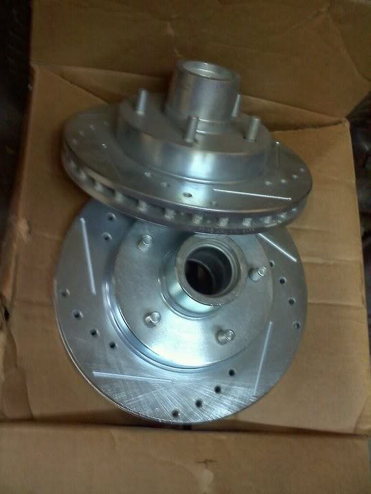

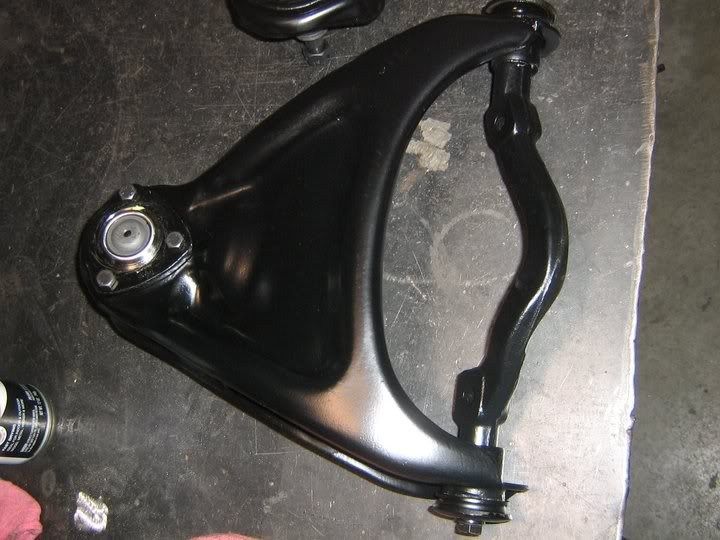

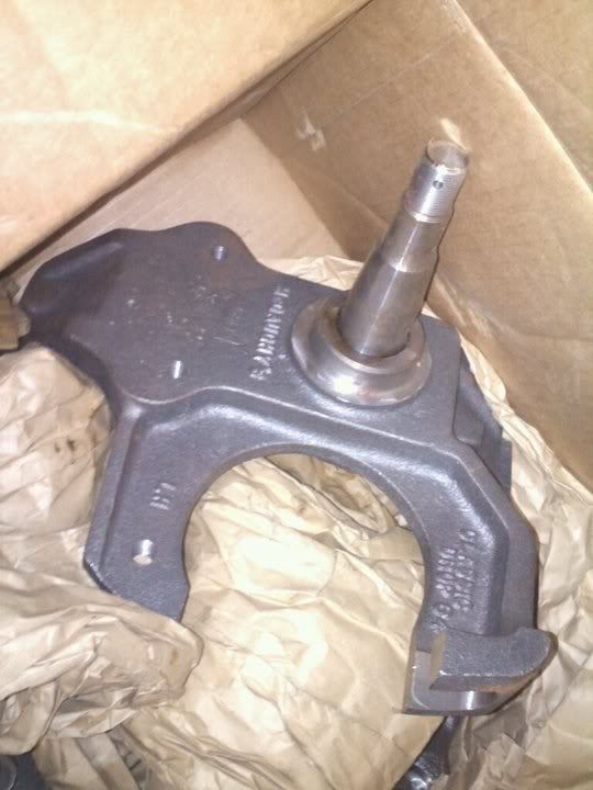

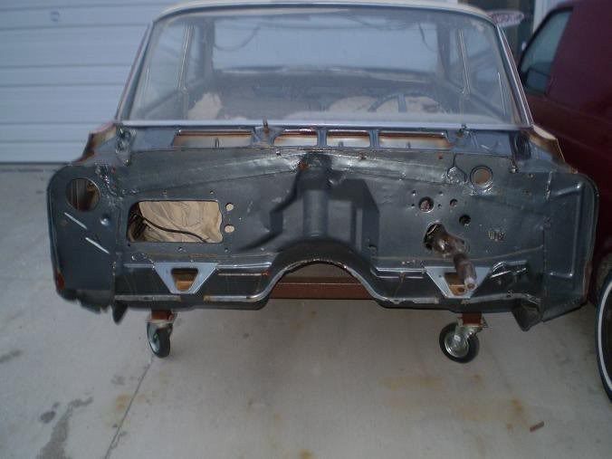

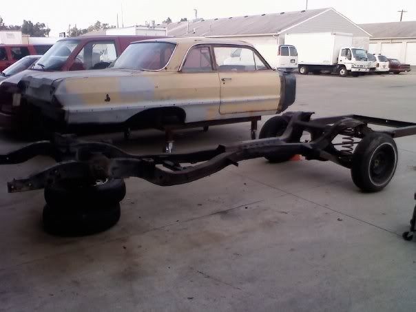

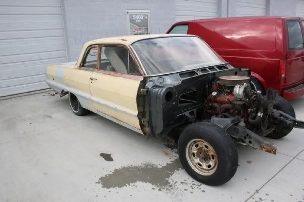

the circumstances surrounding how I got the car are strange, I had a 92 Mazda B2200 that was bagged, and bodydropped, and I had pretty much grown out of the whole minitruck phase for my personal taste, I did some bartering, trading the Mazda for a Honda 426 EX 4 wheeler, then trading the 4 wheeler for the Belair. The Belair was already in our possession for the better part of 2 years and already had new floor pans, and new quarters put on, the bottom of the car was sprayed with a textured coating, and sprayed charcoal grey along with the firewall. At this point I could have put the car together the way it was, put our basic air setup on it, and called it a day. I wanted more than that, I wanted it lower, but still with a rake, and still going with a budget, I pulled the canadian x frame from underneath the car and had it sand blasted, began collecting new parts, including new body mount bushings, and bolts, upper and lower bushings and ball joints, 800 series gear box out of a 79 Monte Carlo, McGaughys dropped spindles, cross drilled and slotted rotors, and a set of Boss 338 wheels 18

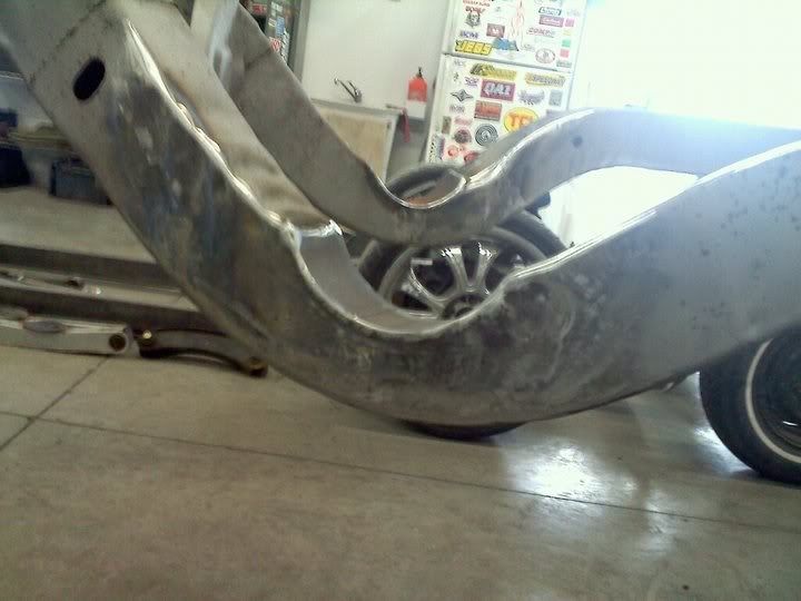

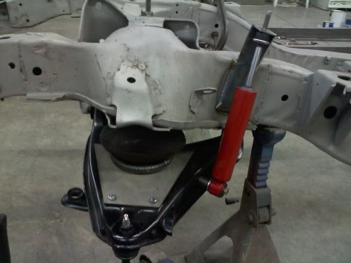

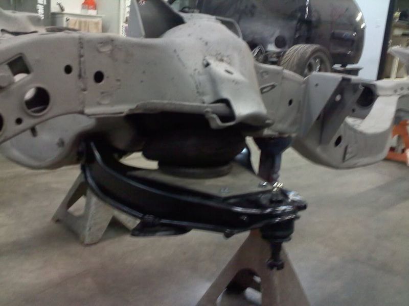

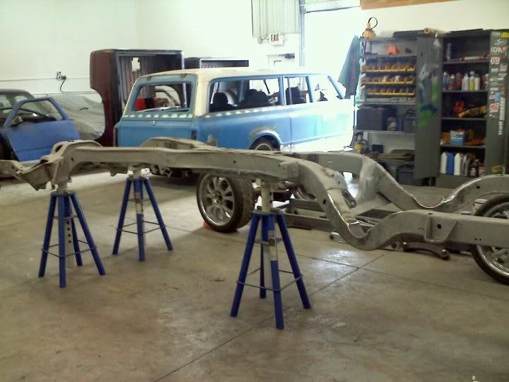

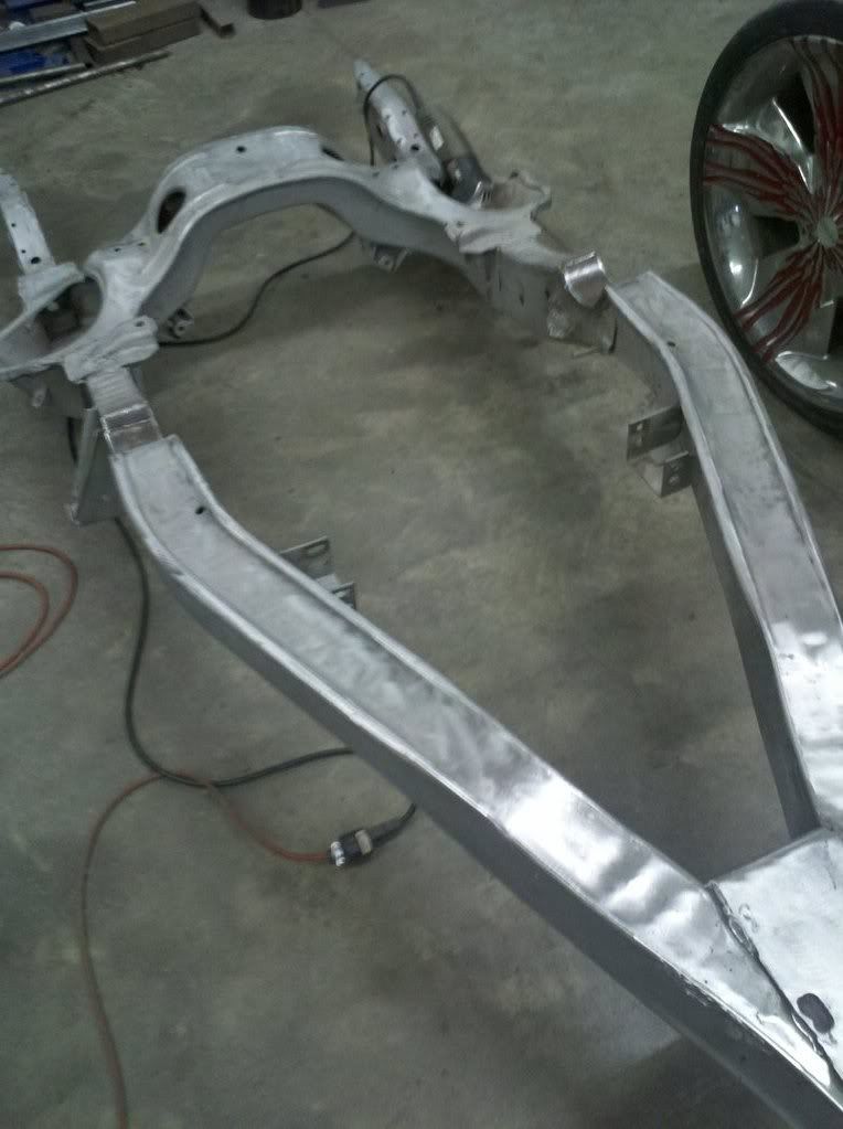

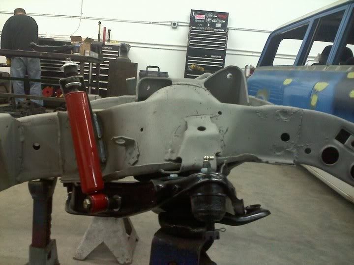

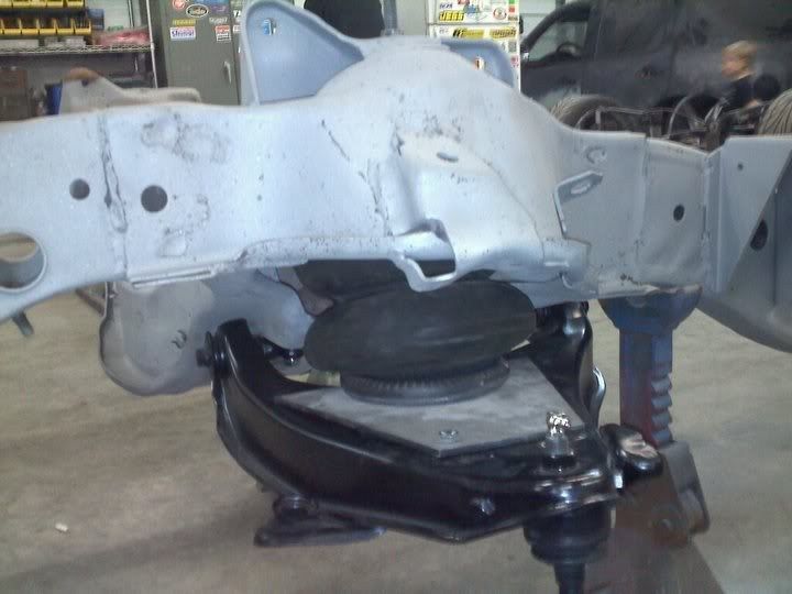

mocking the front up to get the front shocks done
weve got it equated to about a 2 inch notch

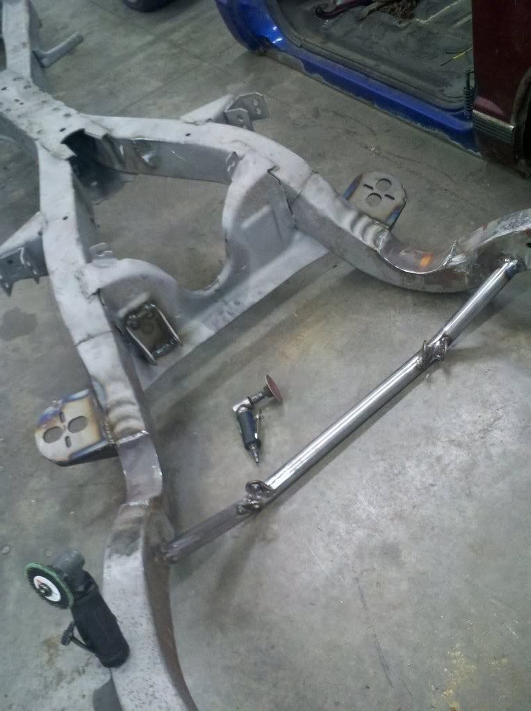

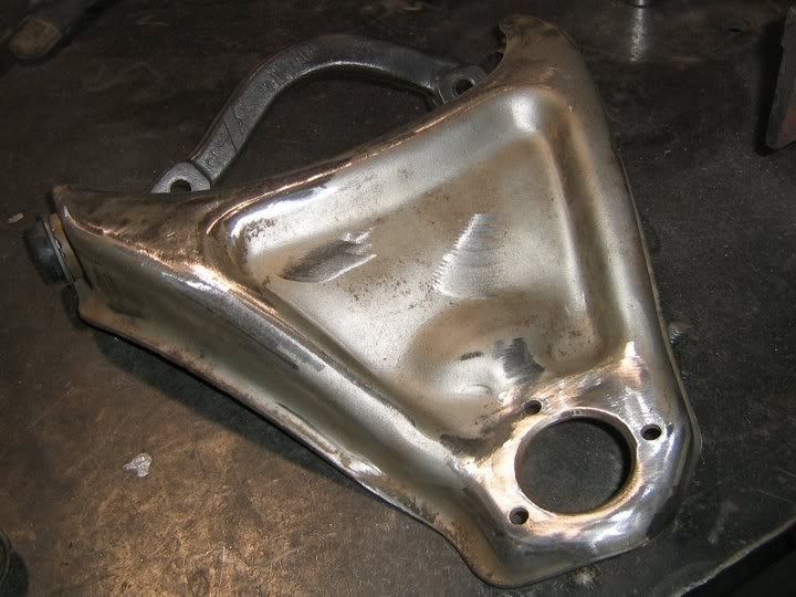

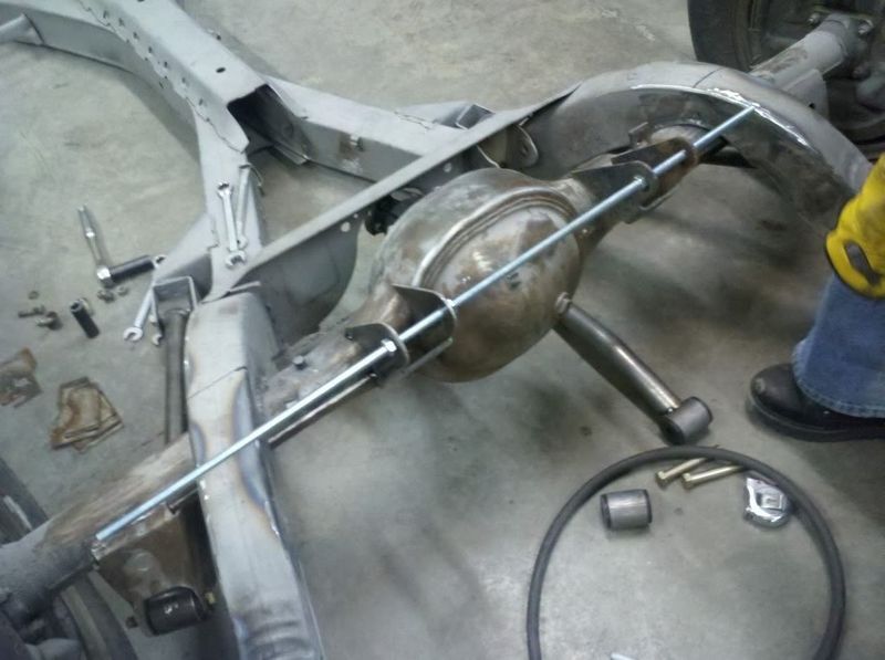

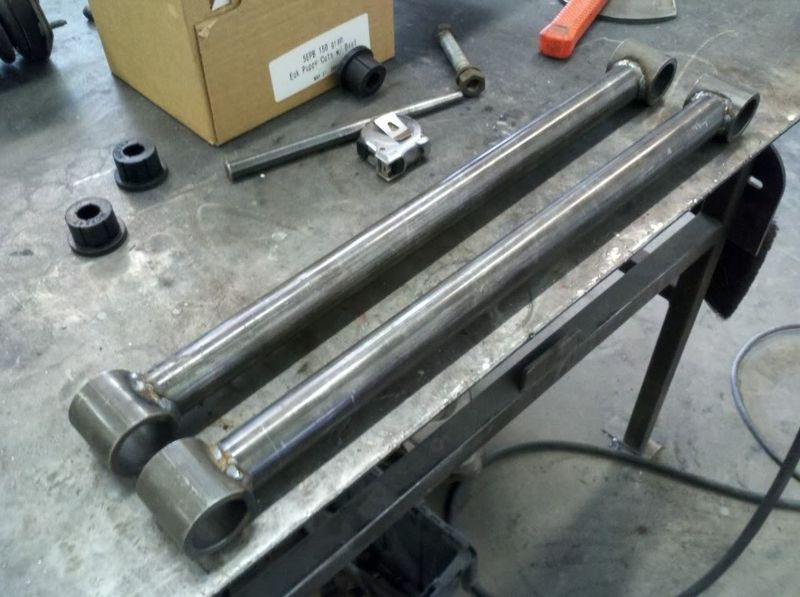

Making lower rear arms
lining up the new mount on the rear end

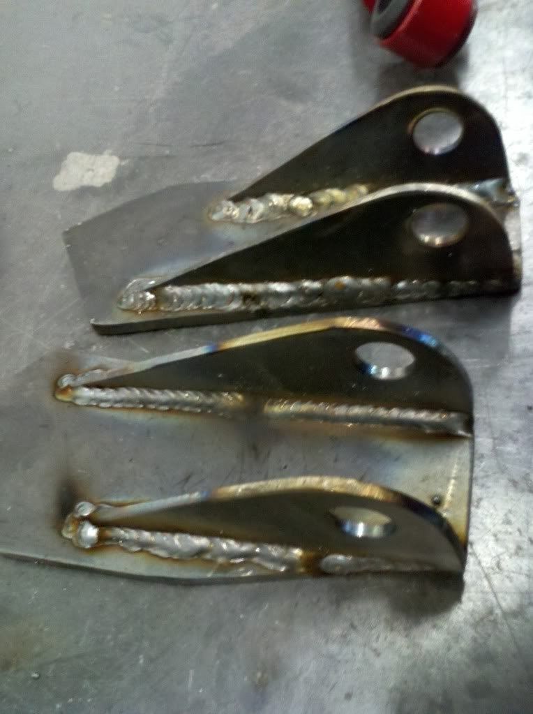

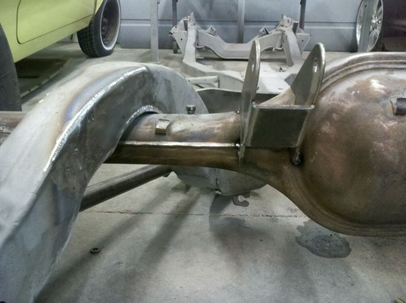

Wishbone, upper mounts, and lower mounts close to done

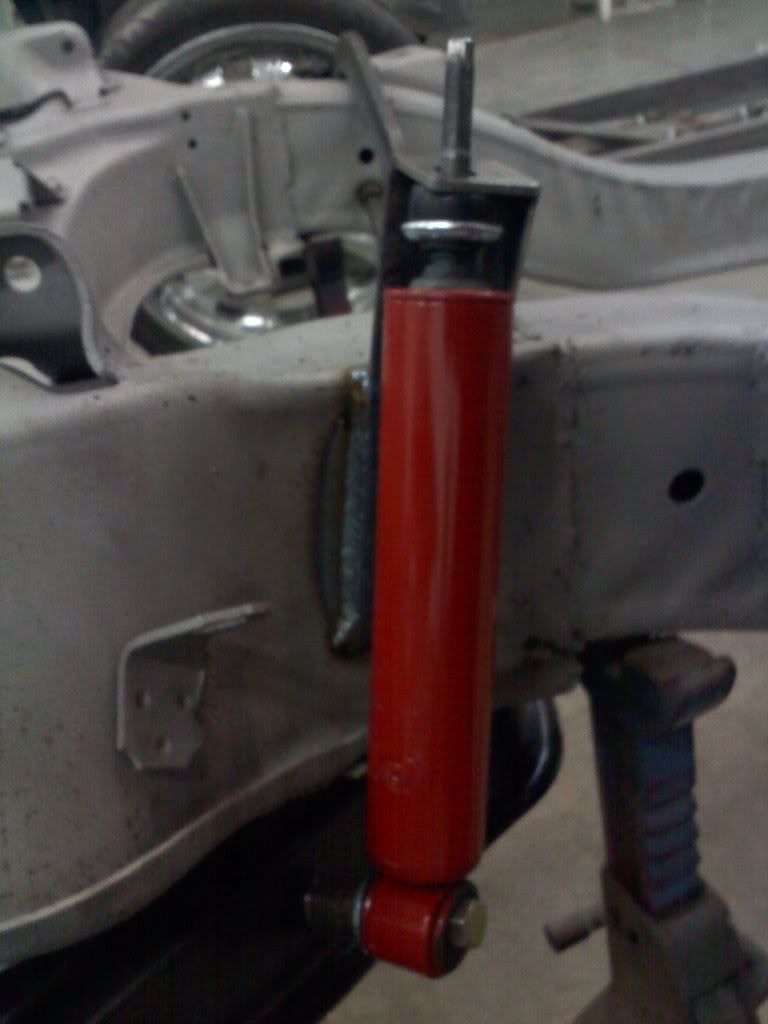

start of the lower shock mounts...
thanks for looking guys, I hope to have the frame notched up front for the exhaust, and my upper shock mounts done by the end of next week(depending on customer demands haha)
I have a gm 800 steering box im using with the project too, this thing should handle like crazy!

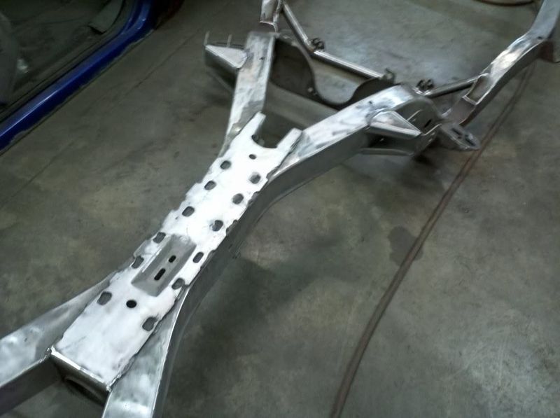

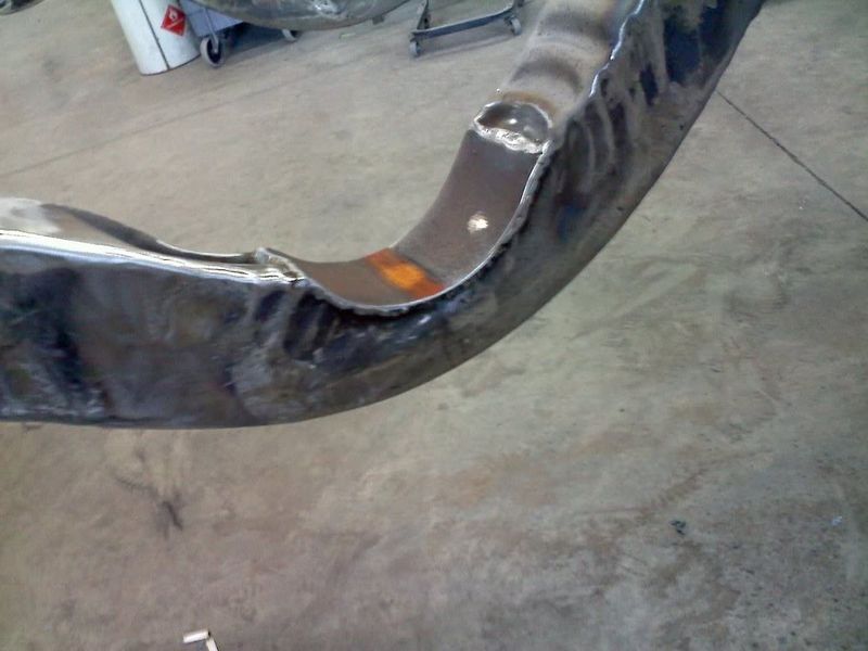

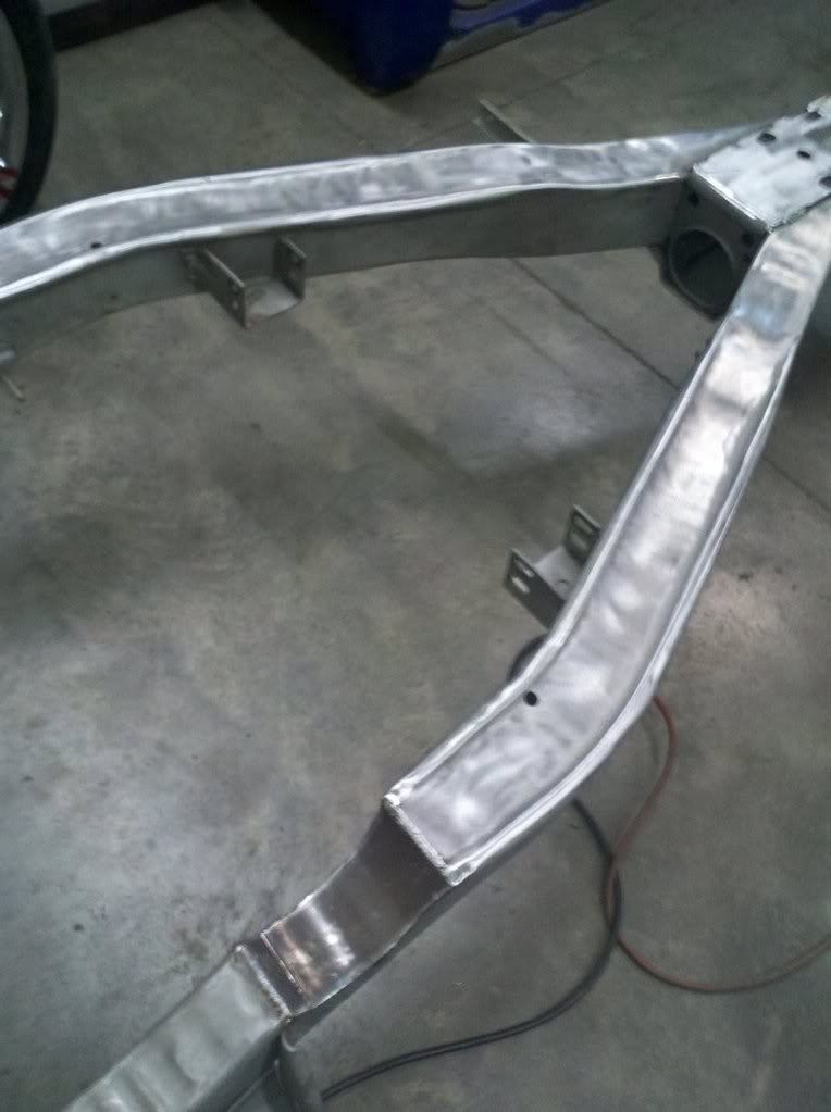

Got the front notched for exhaust, and the rear shock mounts done, its ready for paint when I get our rotisserie back from a buddy we let borrow lol
