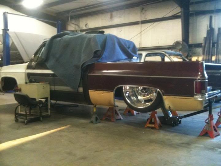

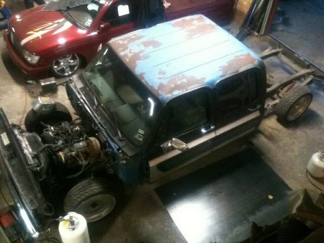

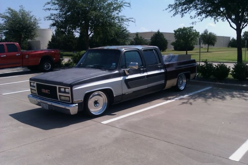

When I brought her home she looked like this, Multicolored on tired 20's with a healthy static drop.

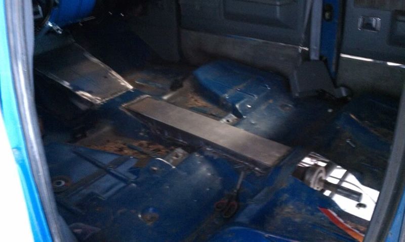

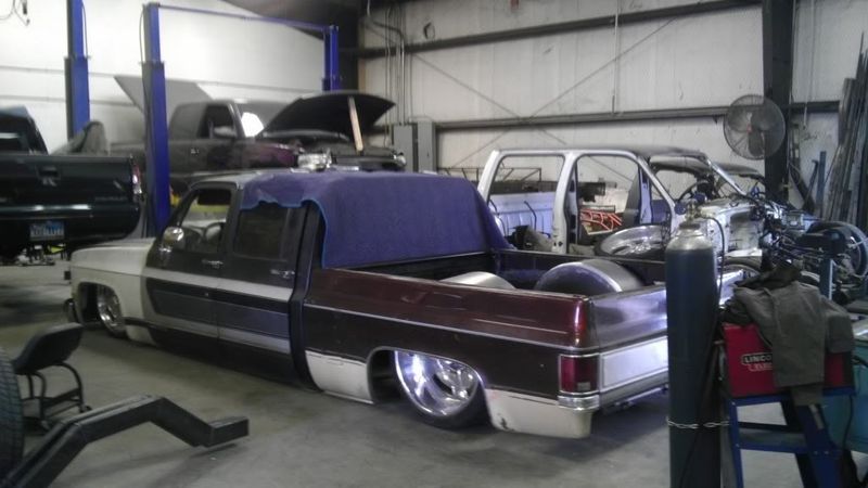

Dropped it off @ Nfamus and teardown got underway:

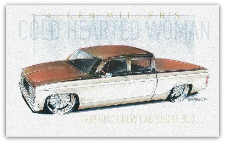

Talked to Bob Thrash @ had a rendering done. The Color and Paint Scheme have of course now changed but this is the idea.. and before you ask no it will not be chopped. Yes I am planning on one piece headlights to match the one piece signal lamps on a burban clip.

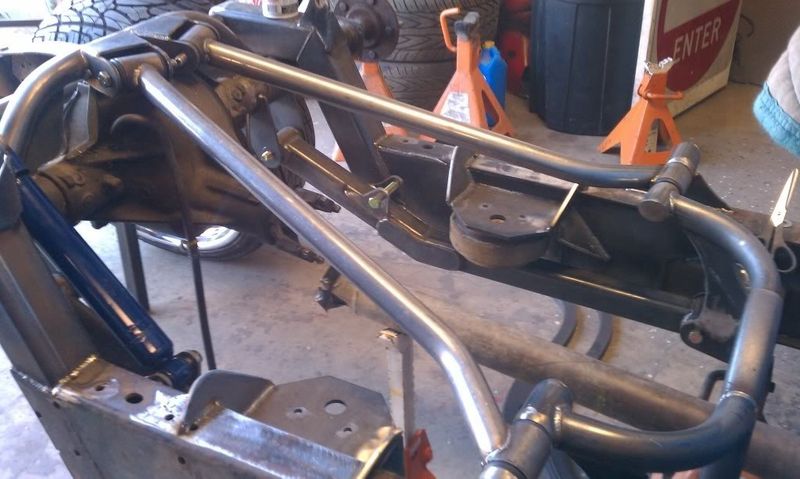

The start of the rear suspension, using a 94 Impala SS rear w/disc and a 4 bar bag in bar setup:

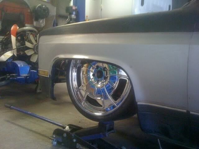

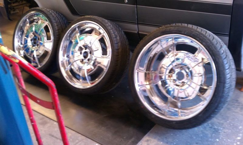

Intro Flagstaff 24x9 and 24x12's wrapped in some Kumho rubbers:

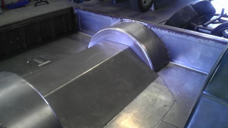

Trans/driveshaft tunnels about done:

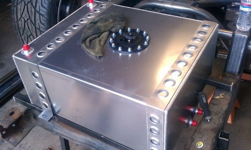

20 Gallon fuel cell with dimpled aluminum strap's by Neil @ Nfamus:

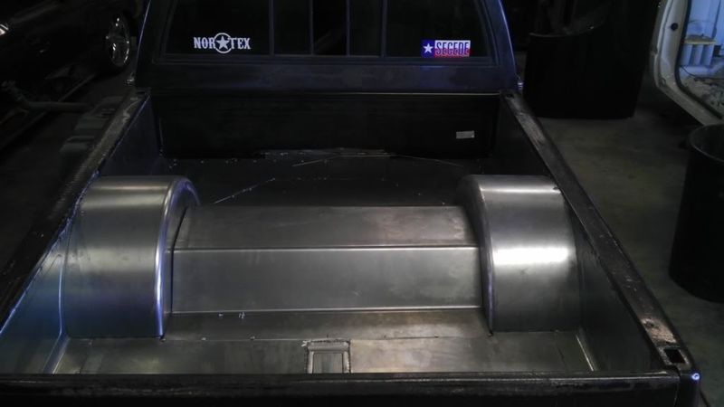

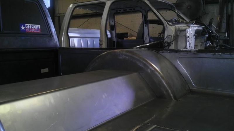

Nice fat ass:

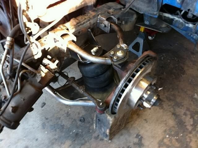

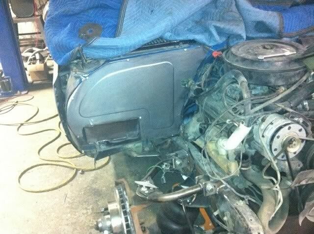

Mocking up the front suspension:
No more spring pockets or factory arms:
This should do, 88-98 balljoints on Nfamus built arms for 73-87 spindles:

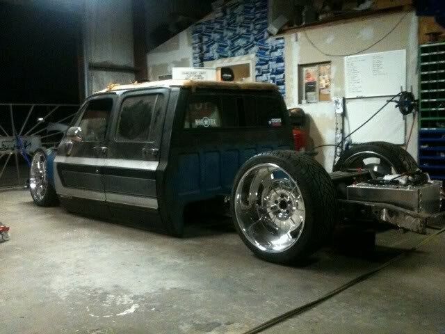

Now it's a roller:

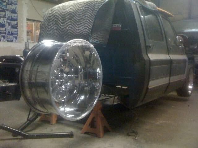

Thanks guys. The wheels took forever to get. They had only been cut once before and in a 18 for a belair convertible. They completely remake the car design to cut them for me. After all the troubles I had I doubt they would do them again, Lmao.
