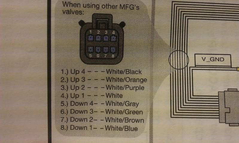

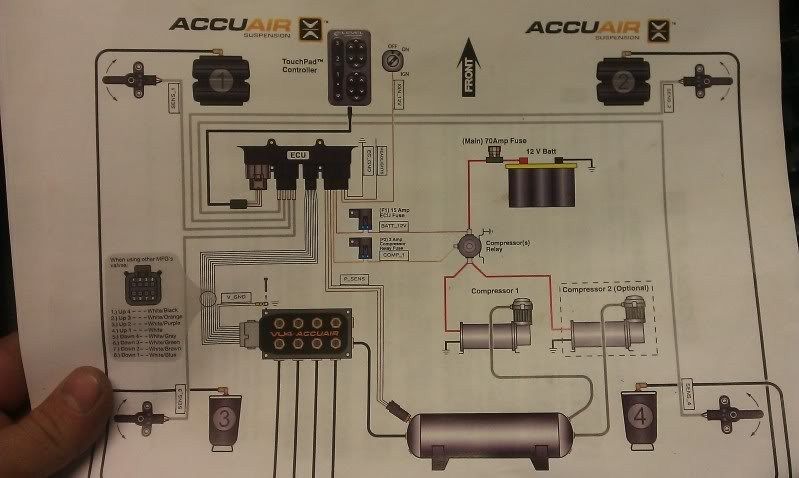

Anyone have the wiring diagram like the card they send with the manifold? Guess the card got tossed out and I'm trying to wire the manifold to an AVS switchbox. Thanks.

hope that helps it should be the same
i8nt2lo's avatar
i8nt2lo
That's it...thank you sir.

... seeing that diagram makes it a little more clear on how accuair can work w/ hydraulics. In theory, you could just treat it as "another manufactures values", and wire it up accordingly (if you were using a 3 dump manifold/2 pump system), right?
In fact, creating an accuair compatible "6 dump/2pump" manifold would be pretty awesome!
am I simplifying too much? hehe =P
